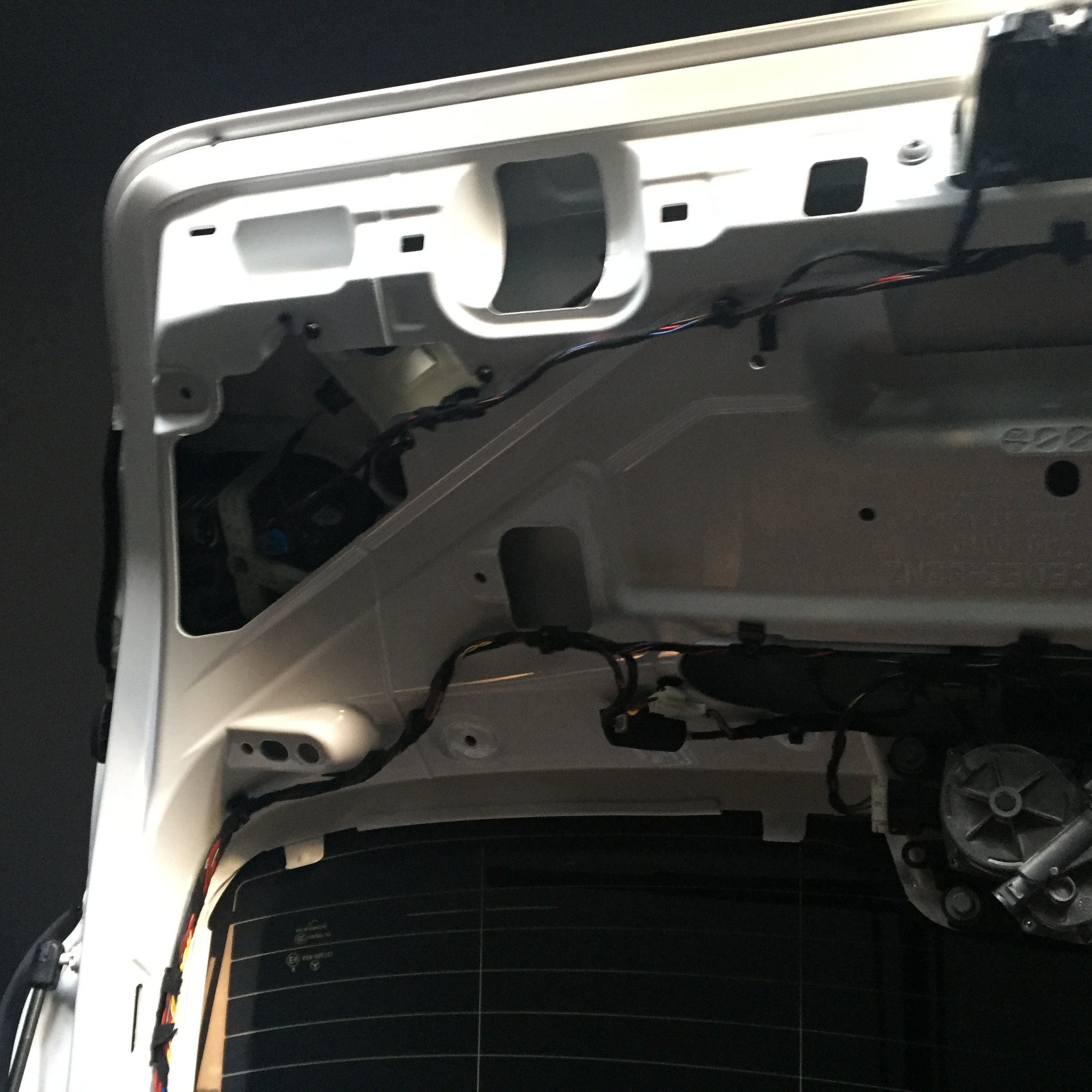

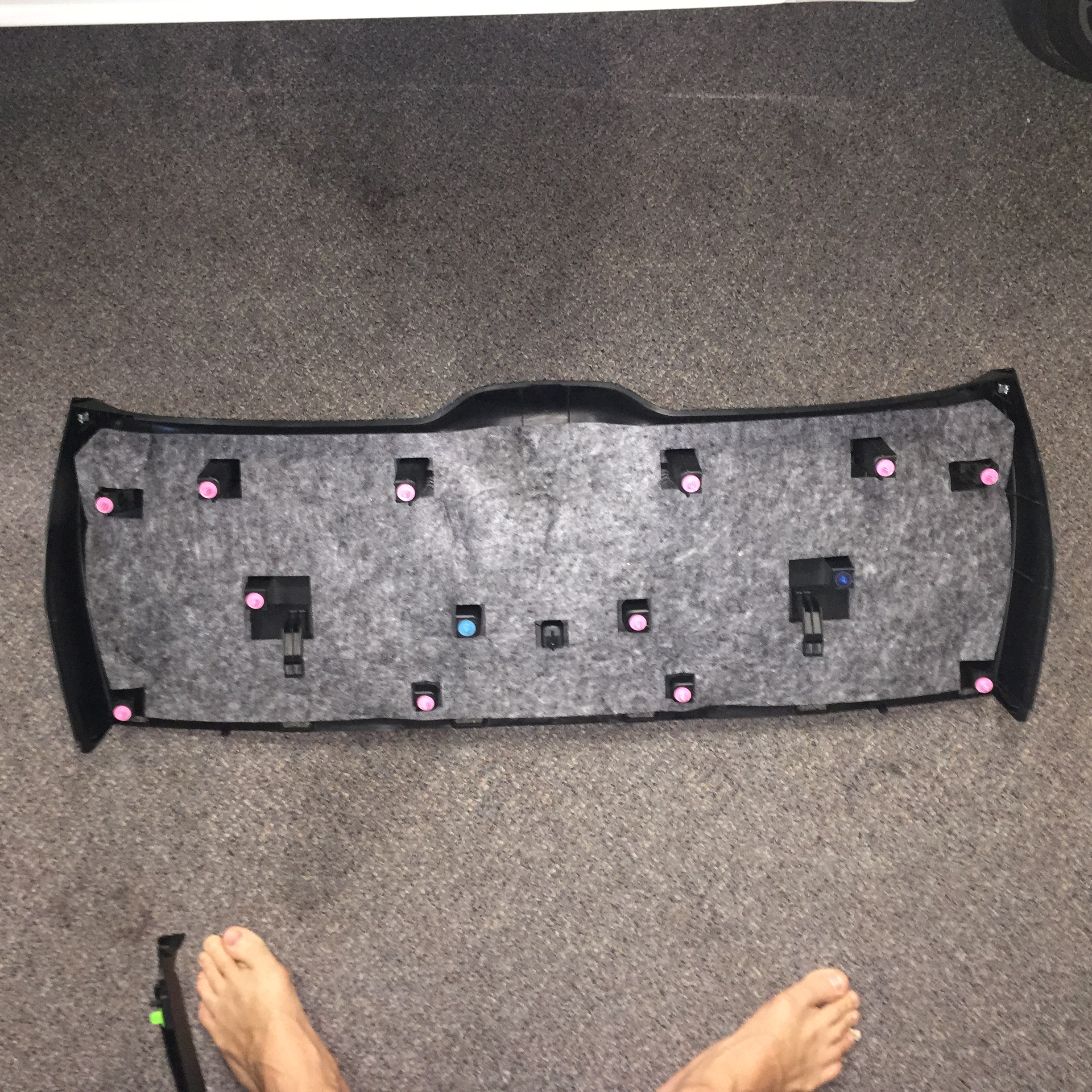

OK so I have installed the dynamat .
6 sheets a cross the rear door, S205 remember, here I t was on the inside of the other skin where access holes existed, onto the plastic trim panels upper and lower, the middle one is covered in soft fabric sound mat...
Also added adhesive foam to the body adjacent to the trim panels to prevent rattles.... Result... It all sounds much more solid... Previously moveable panels are now solid... And the outer skin Has lost some drumming...

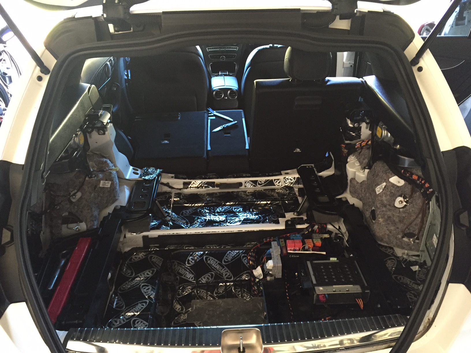

In the back, removed rear side trims, rear door lip panel lower, boot floor front and rear panels, liner, plastic support trims, EPS foam infill bar, removed the burmester amp assembly and all soft foam blocks... Covered almost every available surface.... Replaced all foam blocks and panels... More could be added behind the side panels but I question any further value.... Biggest difference here seems to be the plastic boot floor, but the whole area is just solid sounding now.. Before it was tinny and drummy (are those even words??)

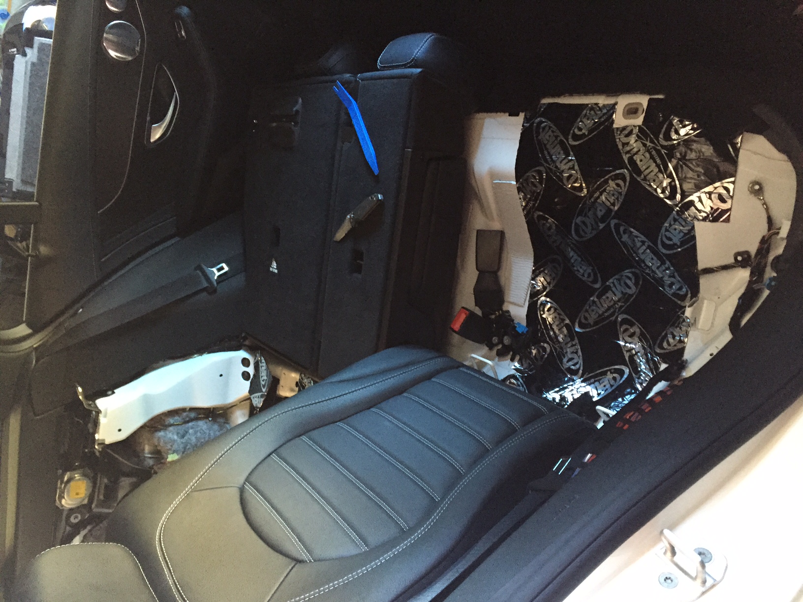

Last spot was under HR rear seat bench and rear susp. Towers... Bench lower and side bolsters removed.. Again everything covered (acknowledge a sheet covers the fuel cell pump access panel here, I accept the sheet will be cut IF in my ownership access is needed..for now don't care...)
Again this one was noticeable.. Especially around the tank access port area and rear towers...
All in and combined there is a clear and noticeable improvement to exhaust, road noise and tyre noise in the back of the car... And that's with magnaflow straight through mufflers...
Schedule a day to do this, I was 6 hours start to finish....
