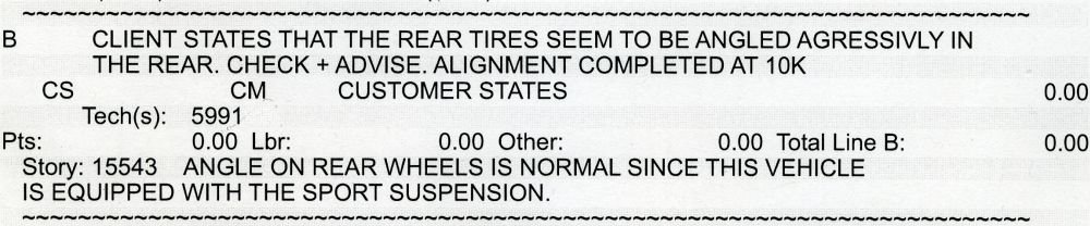

After 14,000 miles, One of my rear tires has severe wear on the inboard side. I had a 4-wheel alignment done about 5,000 miles ago. I had the dealer look at it, and they said everything checks out good. They said this wear was normal. Today I noticed that the rear tire are canted out a lot on the bottom. You can really see it when comparing it to the front tires. I took a level to it, and they were not even close to vertical. The front tires are vertical. This thing looks like a dune buggy in back. I am taking it in tomorrow for an aux battery failure, and I will ask them again. Any thoughts?

Mine are like that too. Wouldn't be surprised if it is supposed to help stabilize cornering. Assuming there IS a logical explanation, wondering if, at the very least, the rear tires could be reversed to even out the wear/extend the lifespan. What did the shop say?

Negative camber. Your C300 has it. My C450 has even more.
They said it was in spec because I have sport suspension. This really pisses me off because the factory put on sport suspension by mistake - I didn't order it. So this is going to cost me not only in ride quality, but also in tire replacements.
