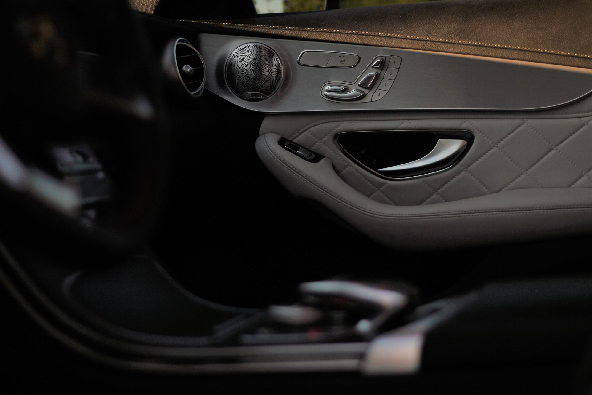

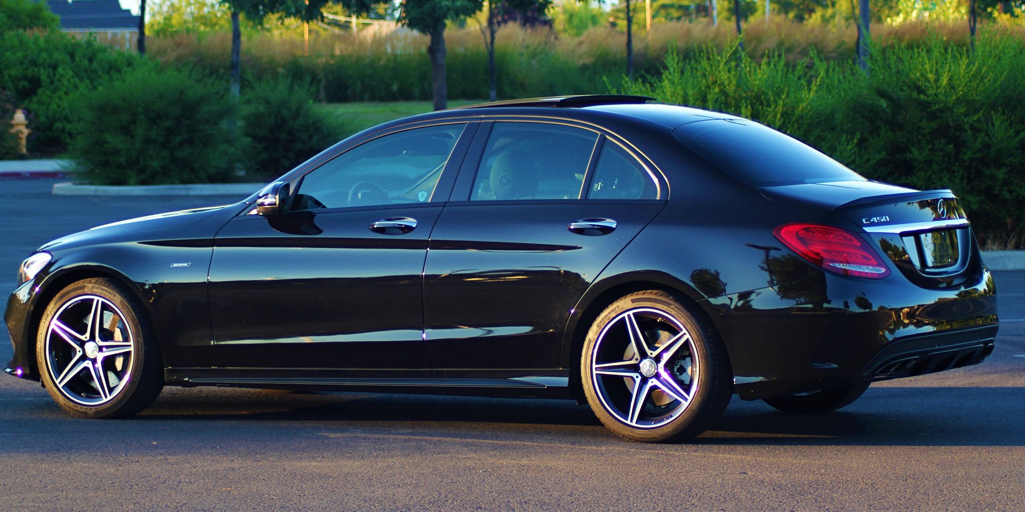

Hey all. I've had my C450 now for 6 months and I love love love it! Finally got some pics and wanted show off : )
