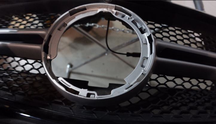

Lightbulb How to remove the distronic plus star
I have distronic plus on my 2015 w205. How do you remove the star from the grill? I am concerned about breaking it.
I read that you insert a wedge at the bottom of the star point and pry open at the top. I tried, but no joy.
(image is not my car)

I figured it out! On my 2015 W205 Sport with distronic plus (the sensor is not mounted on the back of the star )
The star is twist locked (yellow) and has plastic clips (green).
Open your hood and insert your hand near the side (red). Push down (while twisting from the front) to turn the star anti-clockwise.
The star will turn and become a bit loose. You can now push on it from the back to release the clips and pop it out.
**Make sure to avoid the sensor.**
Part # A0008880011
Part # A0008880011
What is the black circle just beside the bottom green arrow?

Does anyone know the Mercedes part number for the distronic star for the facelift 2018+ model? I purchased a replacement grill for my 2015 C450 AMG, from a C43 but my distronic star now does not fit the new grill so I have to replace the star too.
The new grill has the mount as per the pic below, appreciate your help as replacement star is not cheap and I want to make sure I buy the right one that will also be compatible with the distronic.
