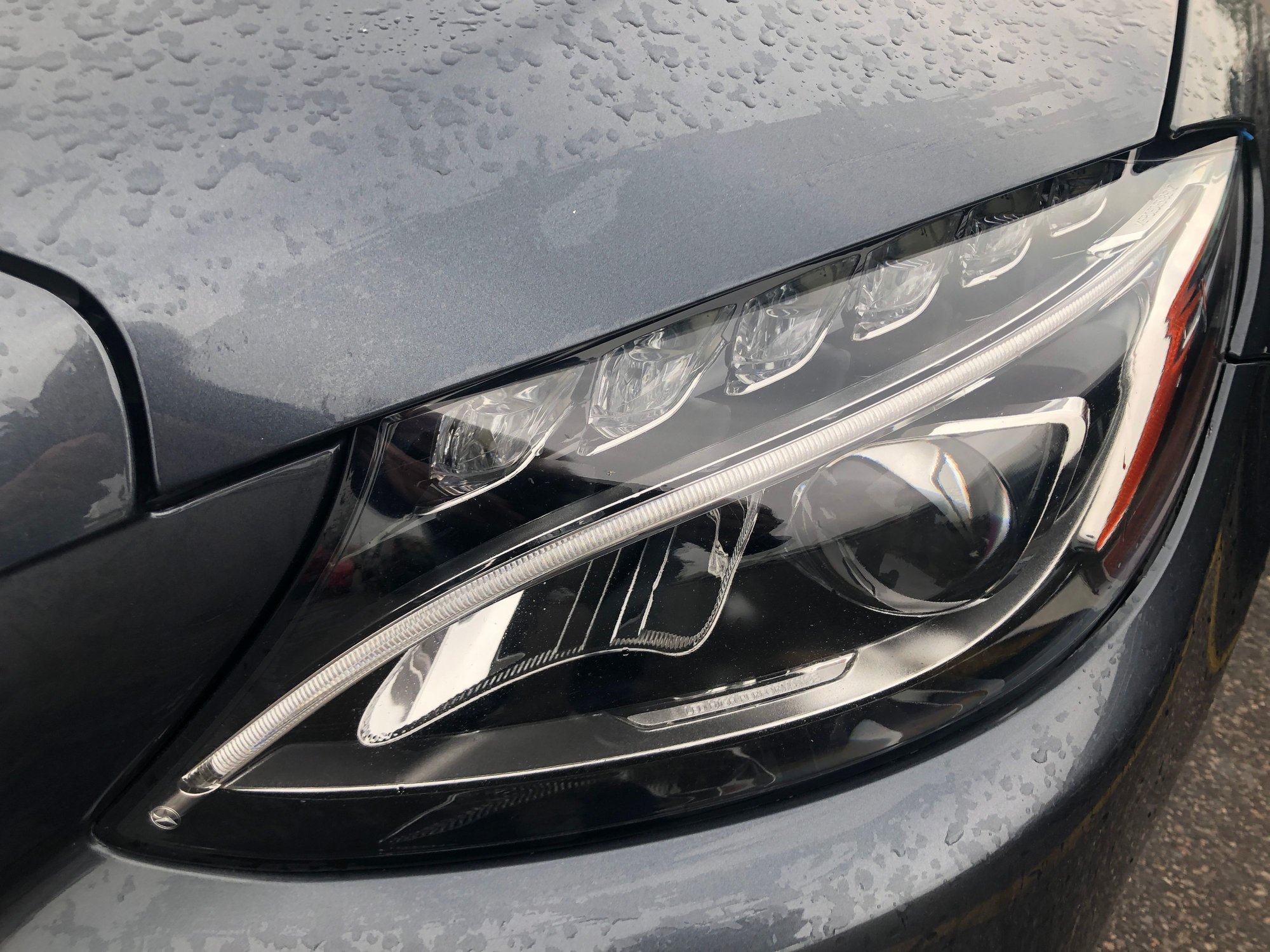

Will this work with the Partial LED Headlight option (code 632)? I believe they are also called static LEDs.
Old Jun 11, 2023 | 03:15 AM
  #46
MaverickC43's Avatar
Joined: May 2021
Posts: 1,317
Likes: 200
From: Plainfield IL
Amg C43
Post a pic
Old Jun 11, 2023 | 07:37 PM
  #47
cidtek's Avatar
Joined: Dec 2014
Posts: 480
Likes: 33
From: Waterloo, Ontario Canada
C300 4Matic Tenorite Grey
Originally Posted by MaverickC43
Post a pic
If anyone is wondering about the markings on the paint it was raining.
look the same as my lights.
