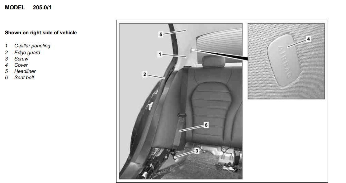

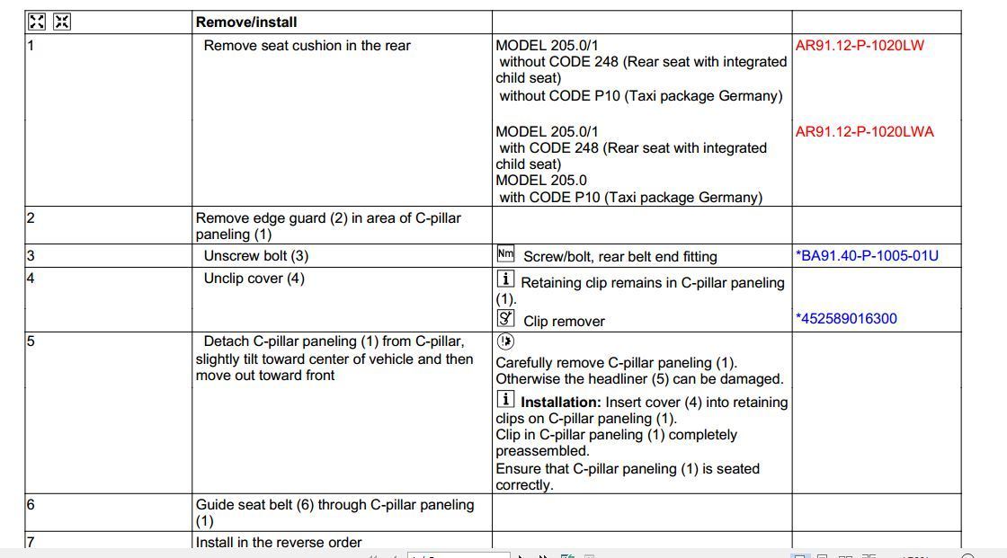

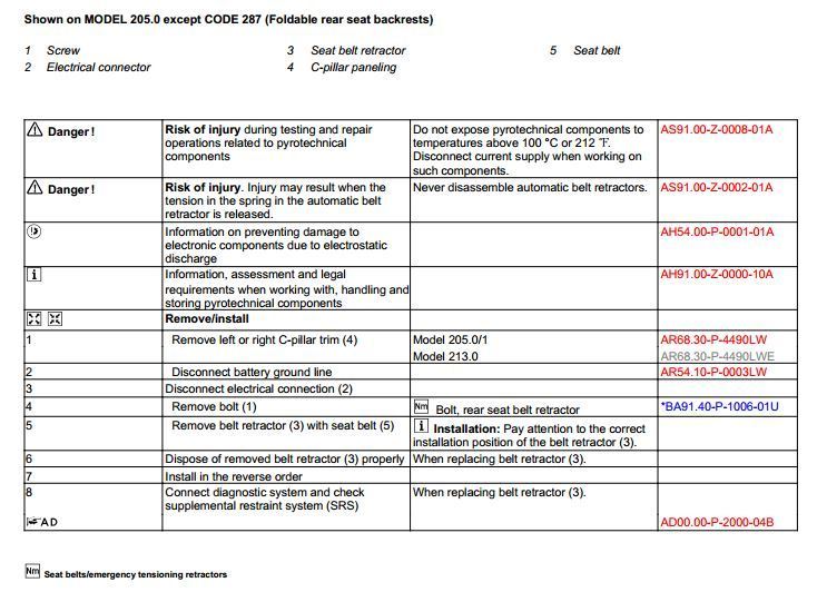

Here is the instructions to remove the rear seatbelts
