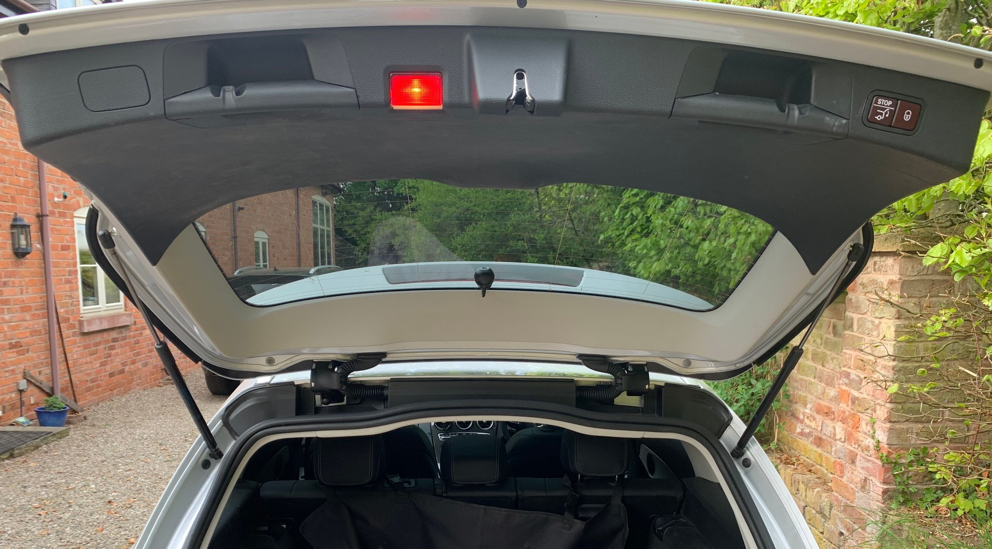

Question Estate - access to fit rear dashcam
Hi, I have a Nextbase 322GW and the add-on extra rear cam. I would like to run the cable for the rear cam through the rubber grommit on the right below. However I cannot find instructions on how to get to this panel anywhere online.
Does anyone know how to get the panel open ?
TIA
Matt

Now that you've already run the cable, it will prove to be nearly impossible. I would suggest pulling the cable back out and starting over, since you'll want to run the connector-end of the cable from rear to front through the grommets and cable runs. You will for sure need to pull the plastic covering on the rear hatch door down in order to access the opening to that cable run, then also remove the black cover and drop the headliner a bit to reach the opening on the other end.

Well I did it ! Let me start by saying I am very cack-handed at most DIY type stuff so it took me a LONG time (about 3 hours).
The hardest part was the removal of the handles (the first step) - the rest was pretty easy apart from getting the cable through the rubber boot (WD40 worked wonders). I just took my time (hence the 3 hours) and made sure I was careful at every step. The blackvue video linked above shows the process most clearly.

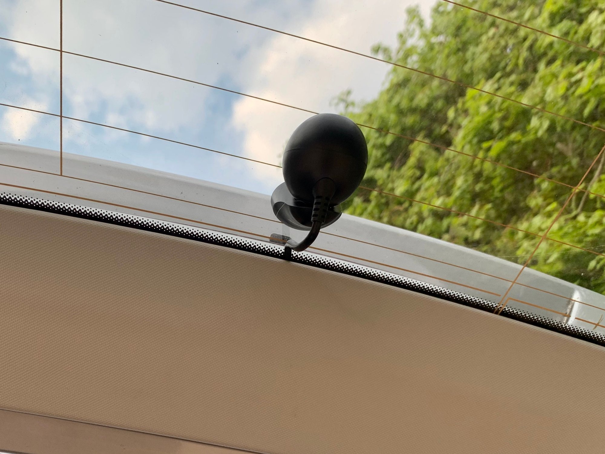

This is where I had left my camera after I realised that I wasn't going to get it into the door without some serious dismantling.
Thank you for the video link!

I got it in place, center of the window!
Also had to use liberal amounts of wd40 to feed the wire, only broke maybe 5 clips
Really wouldn't have known where to start without that video though!
