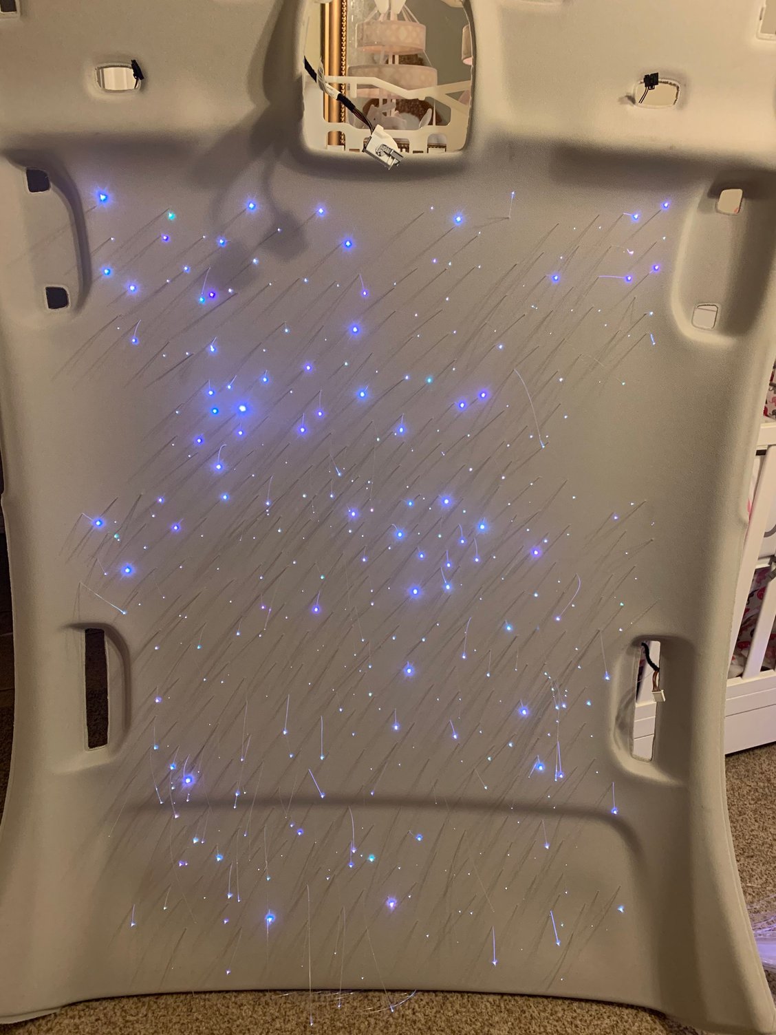

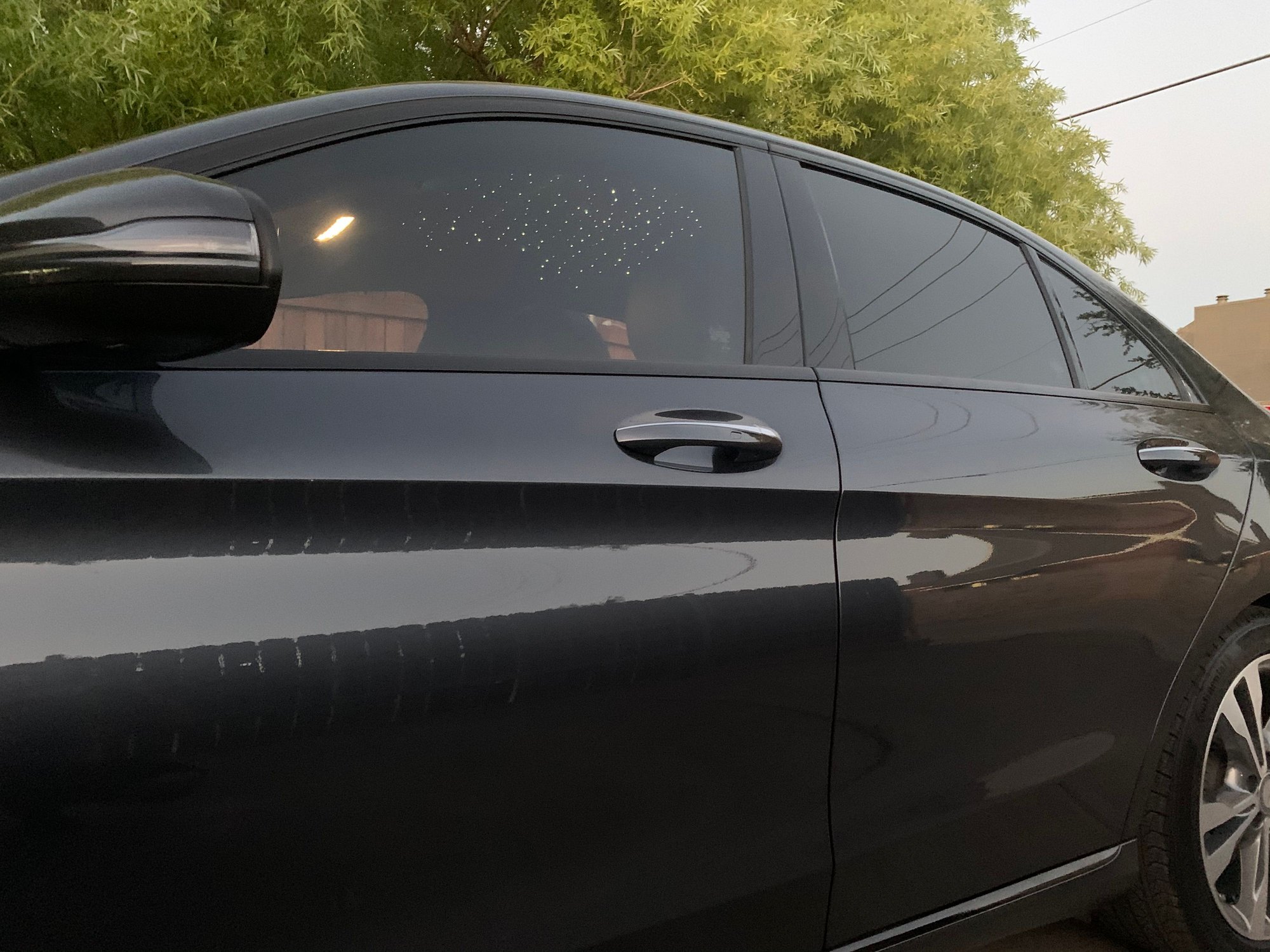

Pictures don’t do it justice but I figured since I wasn’t able to get the sunroof.

Welk finished mine

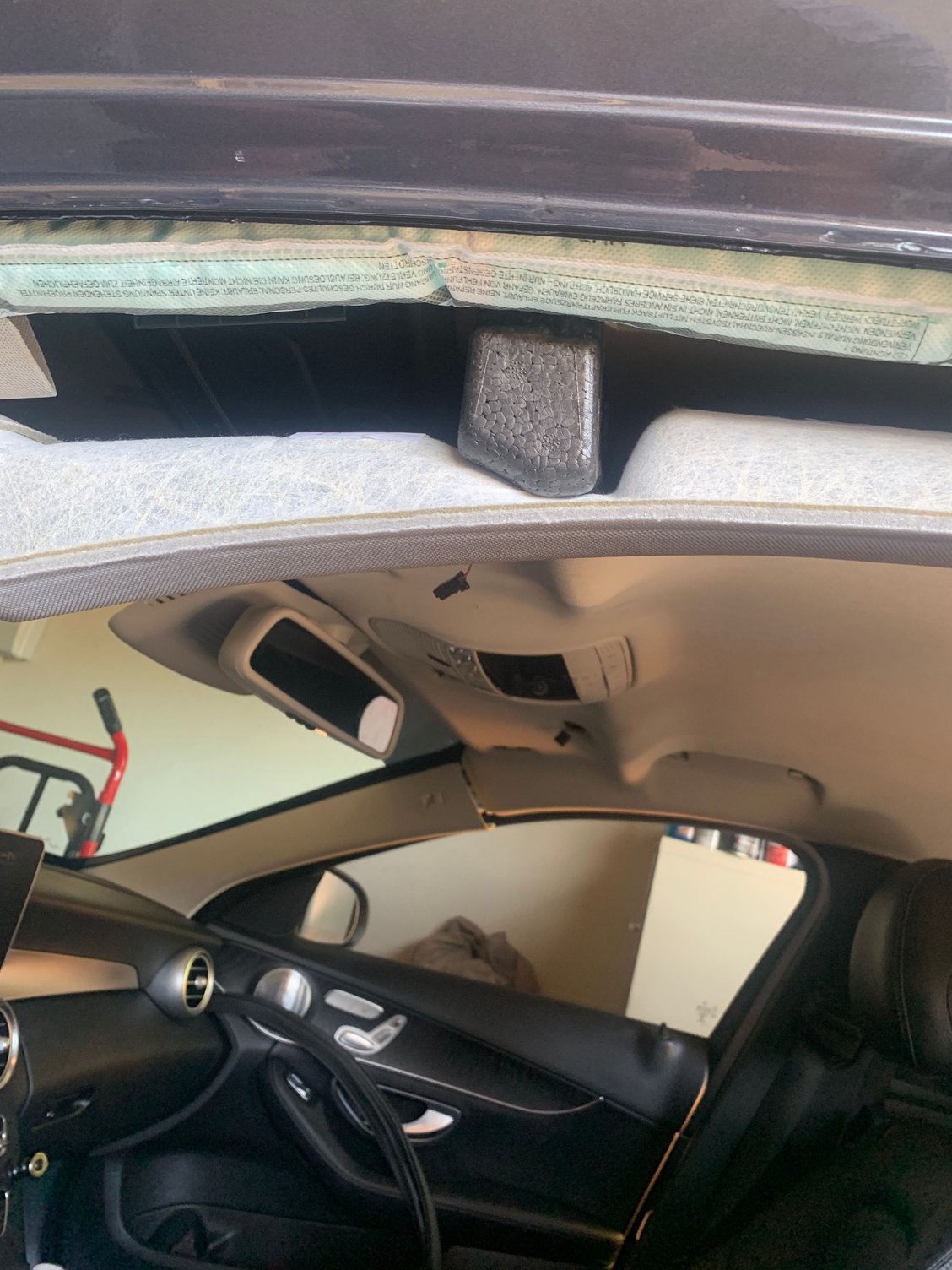

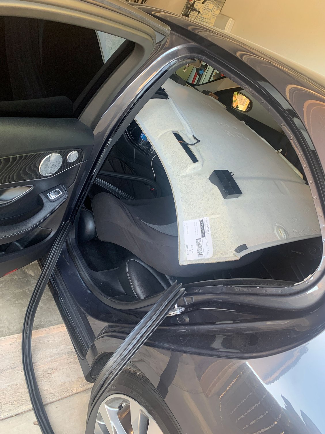

send me a message on ig @300benzo for faster response but i kinda winged it as you stated no instructions anywhere. had to remove all interior handles and lights unplugged alot pops off after that not to difficult. if you can take a picture of your headliner mine had no sunroof so may be different.

Former Benz tech here. Good luck. Its a pain in the ***. You need to remove the cover directly above the rear view mirror. You also need to remove all the grab handles in the roof. From there, the headliner is held on by magnets arounf the sun roof/roofs. It doesnt come out easy and you wont be able to remove the headliner from the inside of the vehicle at all unless the back glass or windshield is removed. its also pretty stiff getting the magnets fully seated. i could walk you through the process in more detail if youd like. the first time you do it, expect 4-6+ hours.
