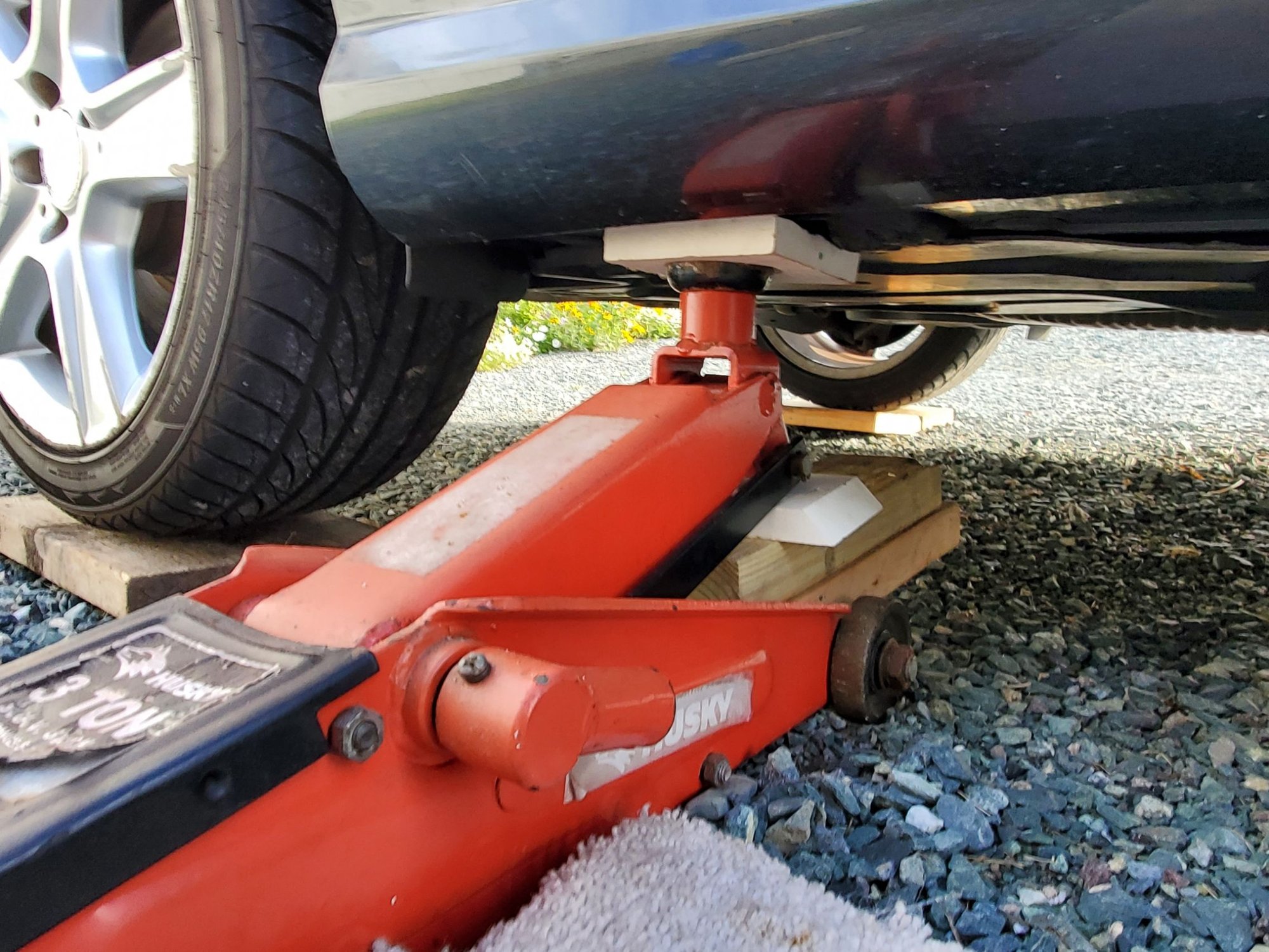

Some info and photos for anyone who comes across this in the future.
Once jacked up I found two points that I could place a jack stand under in case the jack failed. The rear Diff (Mercedes suggested rear lift point), and a suspension arm point that shows between plastic covers. I didn't support the weight of the car on either of these points but had the jack stand in place in case of failure.
Rubber puck on the jack head and it fits nicely in this space.
Rear Diff, strong enough to lift the car but maybe not the best balance on a stand.
Exposed suspension arm. This should be strong enough to hold the car and fits the shape of the jack stand nicely.
