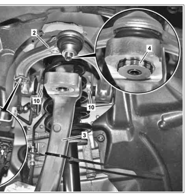

Front:
Upper Strut (3 nuts): 61 Nm
Lower Strut (1 bolt): 95 Nm, plus an additional 45 degree turn.
Steering Knuckle Nut: 50 Nm, plus an additional 45 degree turn.
Rear:
Upper Shock (2 bolts): 36 Nm
Lower Shock (1 bolt): 60 Nm, plus an additional 60 degree turn.
The rear coil spring has no fasteners and is held in place by a combination of vehicle weight and spring force.
Rear:

What kind of wrench did you use for #4 above? 32mm 12-point comb wrench?

I assume once it tightened using a 32 mm wrench and hold withing Torx bit after a certain point perhaps a 32mm socket could be used to toque to 50nm plus 45deg?

I wrestled with that same issue, so I tightened it with the wrench while holding the center with the torx until I felt like it was good and tight. I'm pretty sure I torqued it beyond specs, but I'm not worried about it myself.
