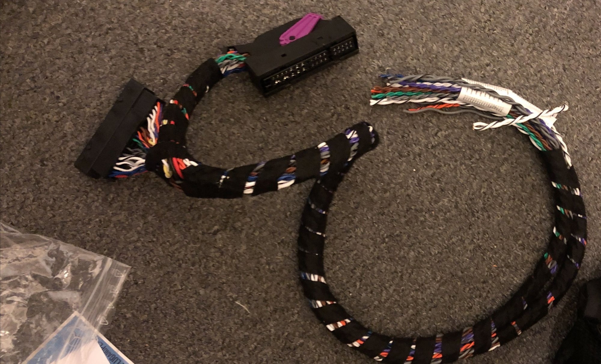

Talking NEW MATCH PP-MB 1.9BUR PLUG & PLAY CABLE FOR BURMESTER TO AFTERMARKET AMP INSTALLS
Description
The universal 9-channel Plug & Play cable harness PP-MB 1.9BUR allows an easy connection of an DSP amplifier like the HELIX V EIGHT DSP MK2 or V TWELVE DSP to selected Mercedes car models with factory-equipped Burmester sound systems – compatible with most car models with a manufacturing date above 2014 and 9-channel Burmester sound system / 13 speakers.
The cable is equipped with MOLEX connectors for future plug & play applications but for universal applications all wires are indicated by a name label.
Features
  • Plug & Play cable harness for an easy connection of a HELIX V EIGHT DSP MK2 or V TWELVE DSP amplifier to a Mercedes equipped with Burmester sound system (manufacturing year > 2014)
  • All signal inputs and outputs are labeled and therefore suitable for all universal applications
  • Cable length 1 Meter
Compatibility
For Mercedes car models with factory-equipped Burmester sound system with 9 amplifier channels and 13 speakers – manufacturing year > 2014

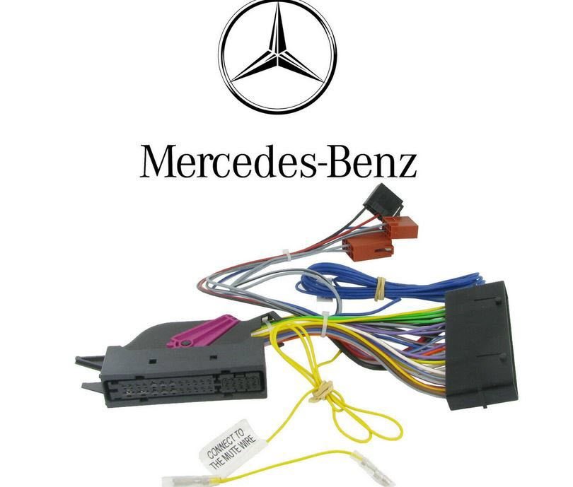

There is a cheaper DIY option available which I am using in my car right now.
The CT10MC03 Bluetooth Parrot SOT T-Harness ISO Adaptor. (on ebay) $50
https://www.ebay.com/itm/Connects2-C...s/372116720209
You just need to cut off the excess wires and solder on additional input/output speaker wires.
***Looks like the MATCH version is using the same color wires as the OEM harness, which makes things easier to validate.

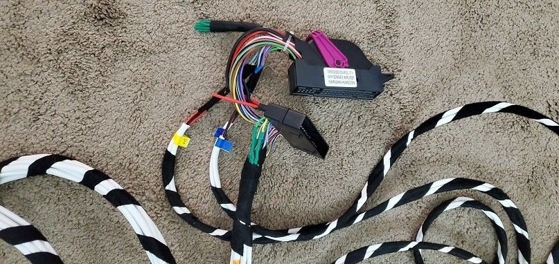

CT10MC03 DIY instructions
Finished Product sample.
Note. This build is feeding a JL Audio Fix 82, so only the Left/Right Sub and Left/Right Front speaker outs from the Burmester AMP are needed to create a full range signal.
The thicker cable is for speaker inputs going from Helix DSP to each speaker. I currently have all 9 speaker channels connected to my Helix V twelve DSP.

BTW, I found the match cable in the UK. $167 USD. Ebay seller allwoodsaudio. (I also got my match speakers and Helix amplifier from him last year)
Had him ship in to a UK address to avoid tax and $70 Ebay shipping charge.
The cable is nicely color coded, marked and has separate input and output wires.
