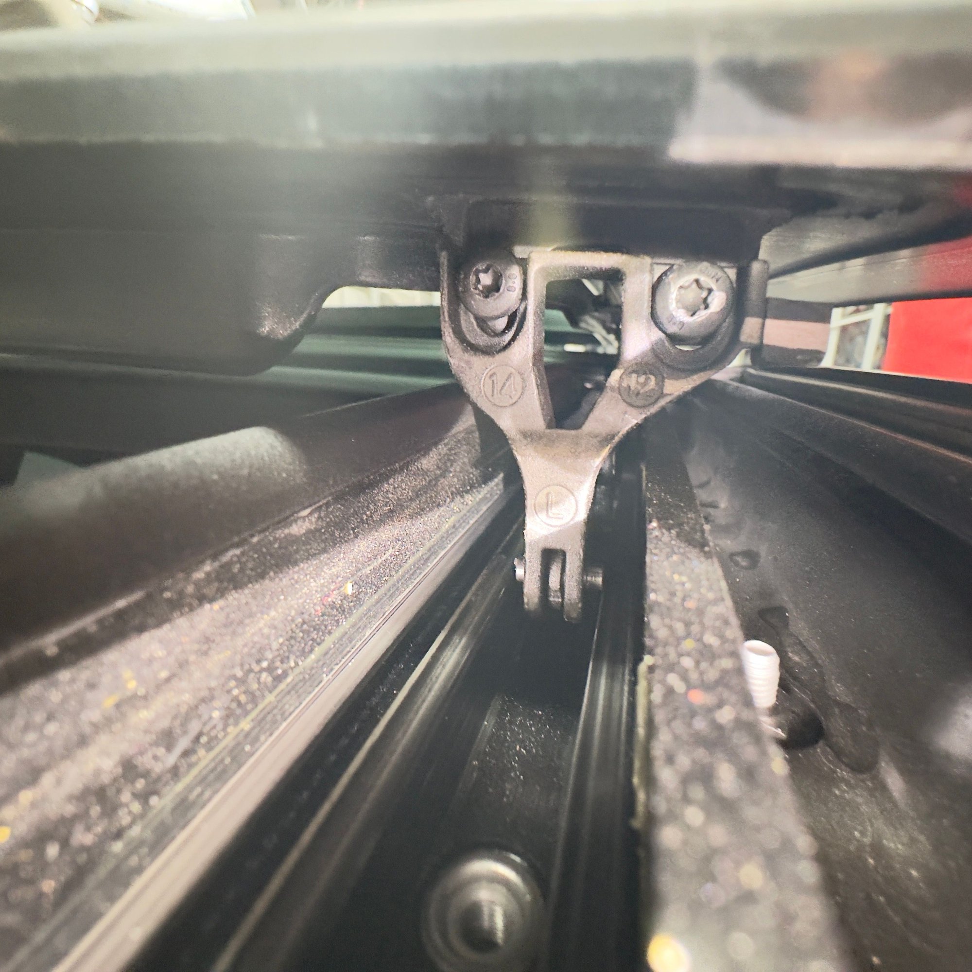

I just got my set of clips from the French guy. The problem is that only a corner of my sunroof opens and then gets stuck so I can’t get it fully open to install the clips. Has anyone been able to somehow get the roof to slide open with this same issue? Trying to avoid dropping the headliner… 2016 C450
Old Feb 1, 2025 | 09:01 AM
  #162
Jetfuture's Avatar
Joined: Jun 2016
Posts: 133
Likes: 42
2016 GLC300
Here is what I wrote in May 2023:
"I live in the United States and bought the one from France. They were shipped from France in about 3 days. I received the part about 9 days after they were shipped. I installed it this morning and it worked! You will likely need to adjust the bracket/glass a bit lower on that side. I just loosened the two Torx T25 bolts, moved the glass down about 2mm or so and retightened. Then I closed the sunroof and it fit nearly perfect. The Mercedes spec is that the sunroof sits from between 0 to 2mm above the adjacent fixed glass. Use a credit card the compare the sunroof glass to the fixed piece of glass when the sunroof is closed.
Can't speak to how long the part or sunroof will work. But it did open and close the 4 times I needed it to. It is now in the closed position and I will never use it again.
Thank you to the developer in France who 3D printed this piece. Saved me between $2,000 and $3,500. It is a genius design."
Somehow, you have to separate the glass from those front slider mounts, which is held on with the aforementioned T25 bolts. I believe I undid then bolts on both front sides of the sunroof, yet only replaced one of the sides (which was broken). I was kind of thinking I should have ordered 2 of those clips so I had a spare if the other side ever broke. But I don't use the sunroof glass anymore after I got it all back together and adjusted.

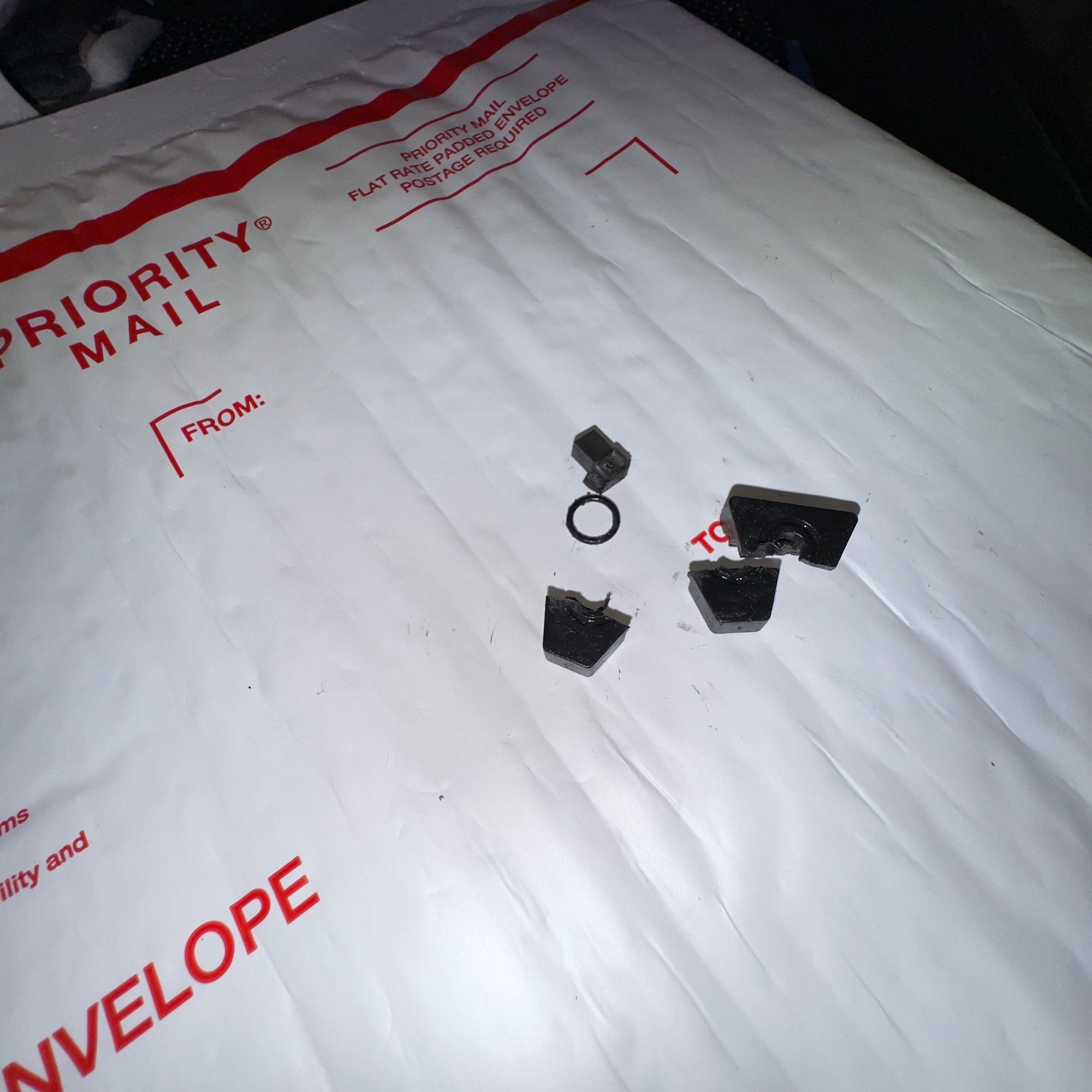

Old May 3, 2025 | 08:32 PM
  #165
pabz707's Avatar
Joined: Oct 2020
Posts: 4
From: San Francisco Bay Area
C450 AMG
Did you drop the headliner? I have the issue where only a corner of the sunroof pops open. It won’t physically slide back and fully open so I don’t have access to the clips to make the repair. I’ve tried gently prying it open and pushing up from underneath but still can’t get it to slide back and open fully.
Old May 3, 2025 | 09:24 PM
  #166
Jetfuture's Avatar
Joined: Jun 2016
Posts: 133
Likes: 42
2016 GLC300
I did not drop the headliner, as my motors and rails were working just fine. I was able to open the sunroof a foot and access the front clip area just fine. Sounds like perhaps you have a problem with the motor, the rails, or the rear attachment (in addition to a broken clip). Sorry to hear about your predicament, and wish you luck in finding a solution that works for you.
