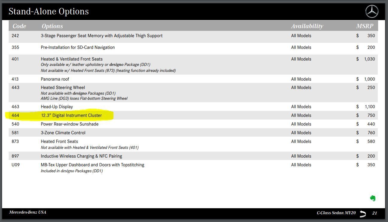

Well, wait a minute. Your car doesn't have the 12.3" Digital Instrument Cluster, either. You can't change the design layouts with the standard analog instrument cluster. You need option 464 for that and the car in the video you posted has the digital instrument cluster.
