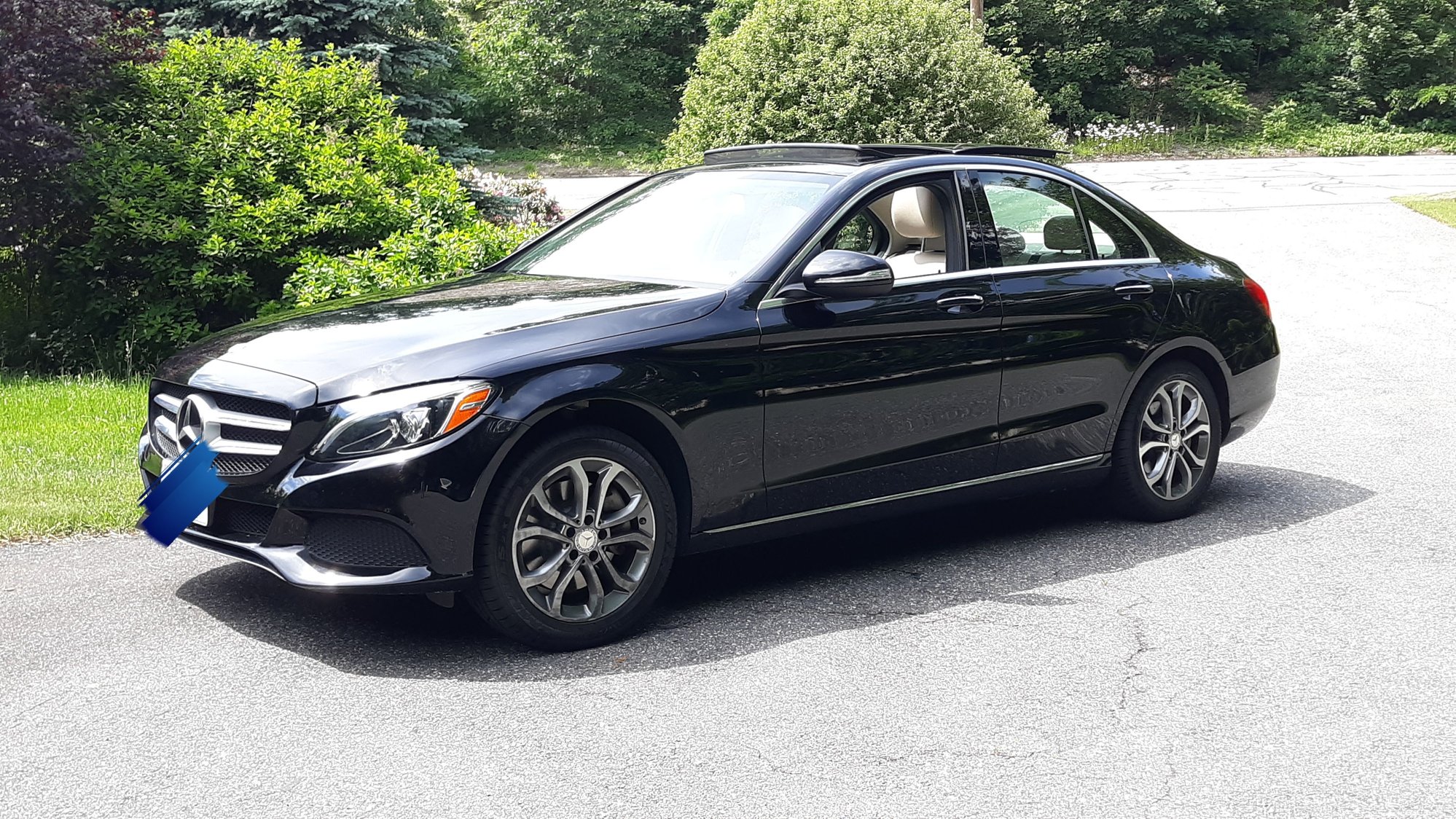

So what did you buy do you have a picture?
Old Jun 15, 2021 | 09:56 PM
Shuck M.'s Avatar
Joined: May 2021
Posts: 7
W205
Originally Posted by Andy74
As for the second i keep both hands on my steering wheel for better control on the car.
Well i walked right into that one. But thank you.
Old Jun 15, 2021 | 10:01 PM
Andy74's Avatar
Joined: May 2018
Posts: 1,246
Likes: 243
W205 2015
Beautiful colour.
