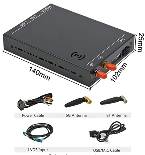

Alright everybody! Yes I know, another carplay thread when we have bunch already. I couldnt find my answer in any of the other threads which is why I decided to create this one.
Question 1: Do I NEED to have my AUX channel activated in order to use a carplay module? I currently have DMP's module connected, but is using the mic that was provided instead of using the OEM Car Mic. In order to use the OEM Mic, do i need to have the AUX Channel activated? I know there are OBD Plugs that can activate it instead of taking it to the dealers.

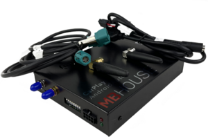

Not sure if yall are familiar with MBHouse in Canada, but they state that their module is more integrated, which uses the OEM Mic and which needs to have the AUX Channel activated in order for their module to work.
I found a VERY similar module (below image), if not the same on Amazon that states no coding/no aux channel need to be activated for the module to work. All the cables are the same as what MBHouse uses with their module.
What are your thoughts? What are your experiences? What module do yall use that works with the OEM Mic?
