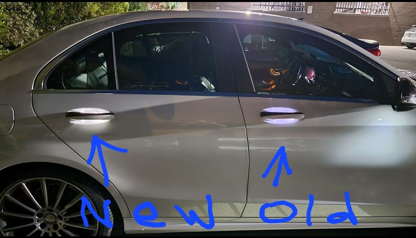

One of my rear doors went out and i purchased original Mercedes one .. it costs as far as i remember around $16 and i did it my self.
it took me 2 hours as you have to remove the door card and unmount your glass and tape it.. i watched a youtube video and it was straight forward.
The rear doors are easier than the fronts as the fronts you will have to totally remove the glass .
The one issue i found is that Mercedes released an upgraded light and it has different color temperature, so now i have one door handle light with different color 😑.
If you can live with that then go with it.. it's an easy job.
If you go to the dealer, they will quote you at least $1k.
Thanks for sharing, the more blue tinted light is actually a sign that it may (not saying it will definitely but it may...) fail, that is how one of mines on a 2017 failed, it progressively became more blue. However, I have one that stopped becoming more blue and still working for way longer than the other one. So that means it might not fail. Depends on their mood apparently.

All of them are blue, maybe that's a sign all of them are failing 😅

...or it might just stop becoming blue and then remain lit : )
