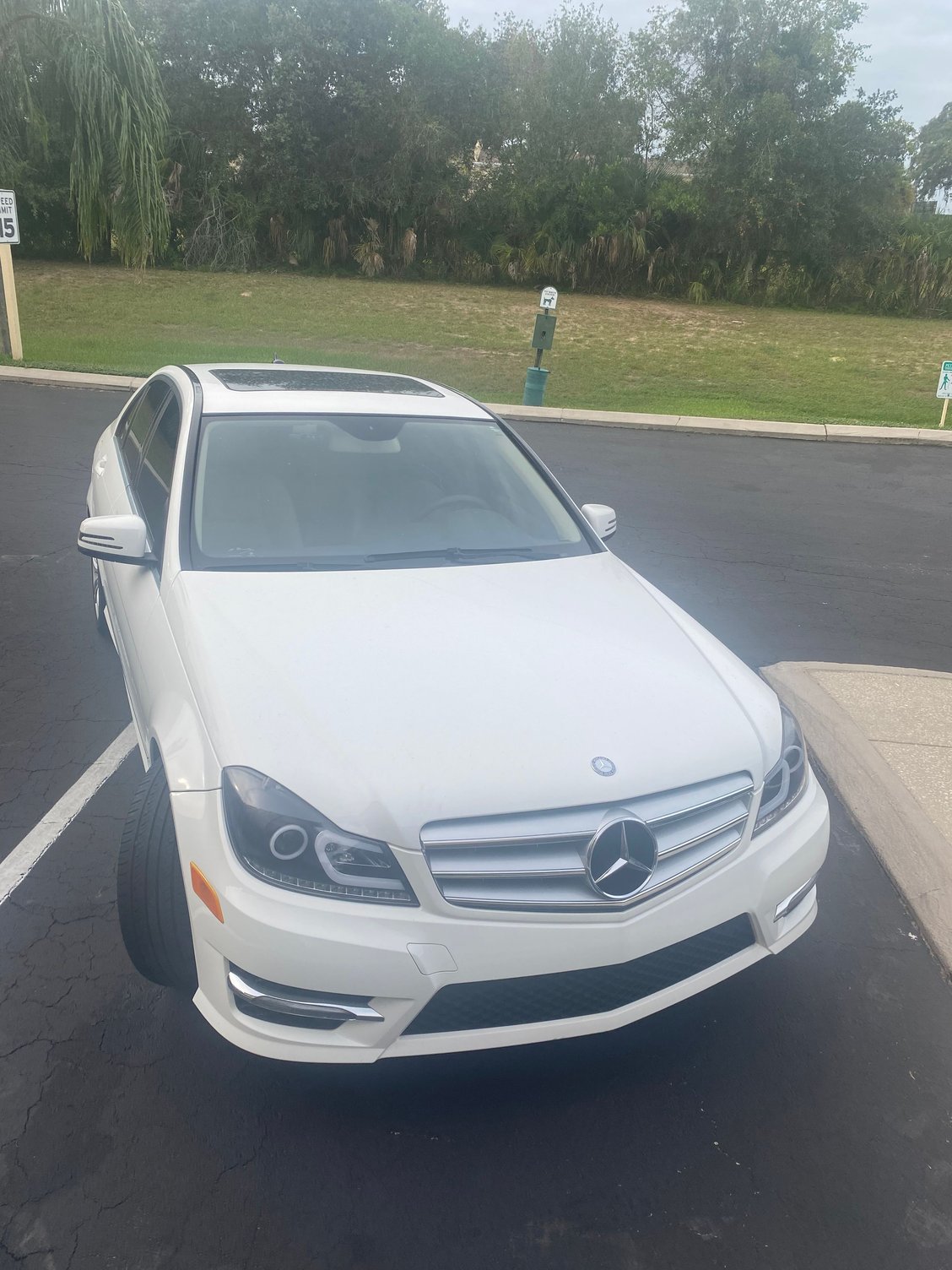

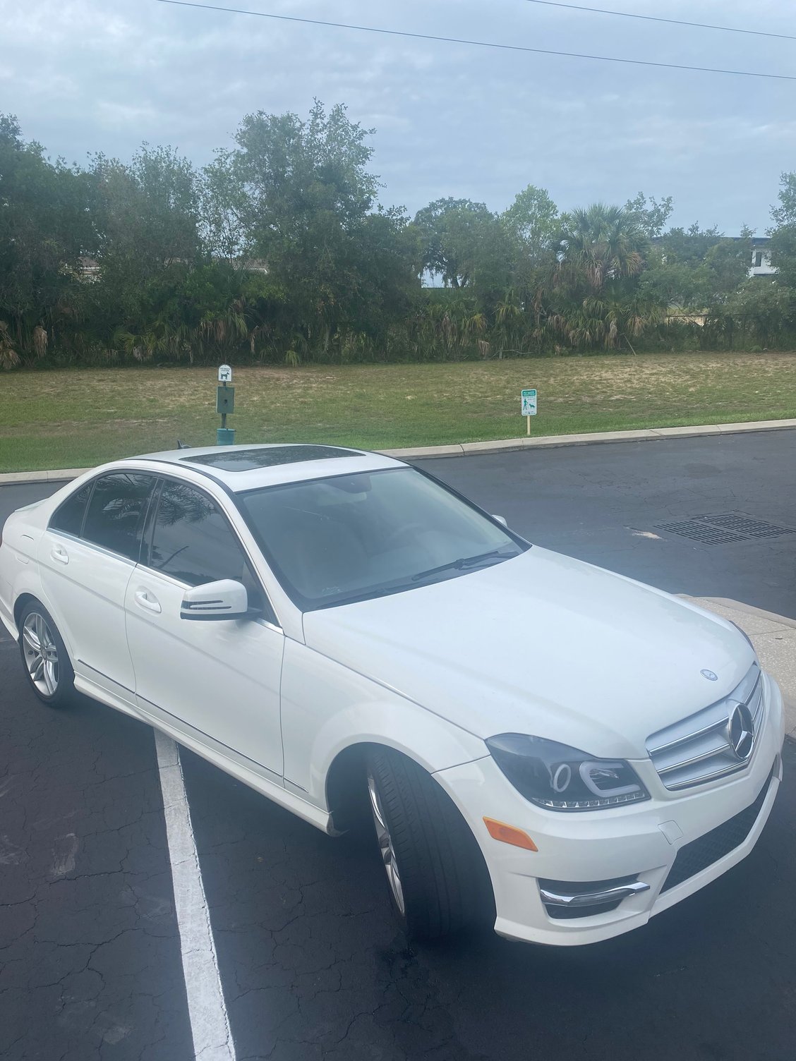

Attached Thumbnails Can Improper Tow Damage EIS?-fe611fe4-7ebe-419b-b32c-8849dbdd6772.jpeg

And considering you've added pictures I take it you want our input on your parking job, the property manager might have been a bit of a dick to go straight to towing but you left so much space on one side the bike to the right of you could've easily fit in there.
