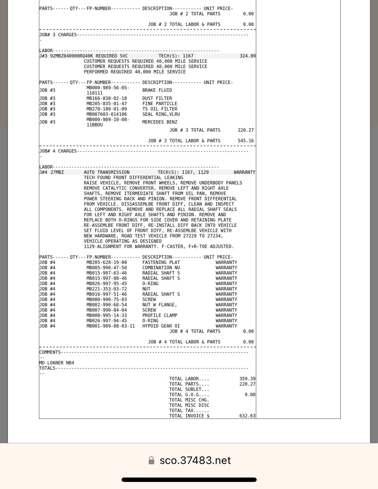

Took my 2019 W206 in for Service B. They found that the front diff was leaking. Luckily, I’m still under warranty. Does anyone know if this is a common issue? How much would it have cost without the warranty- ballpark.

@NicoC300 I had the same situation and would recommend a second opinion on this. I brought my C400 to a dealership for 60K service and the SA said the front differential seal is worn out and causes leaking in which they quoted me $2,900 to fix it. I declined right away and took my car to a reputable indy shop and they were not able to find any leak and mentioned that this area can be sweated and catches dirts, therefore, making it like a leaking grease. If it were, in fact, leaking, the quote I got from the indy shop is $1,350. Hope it helps.
