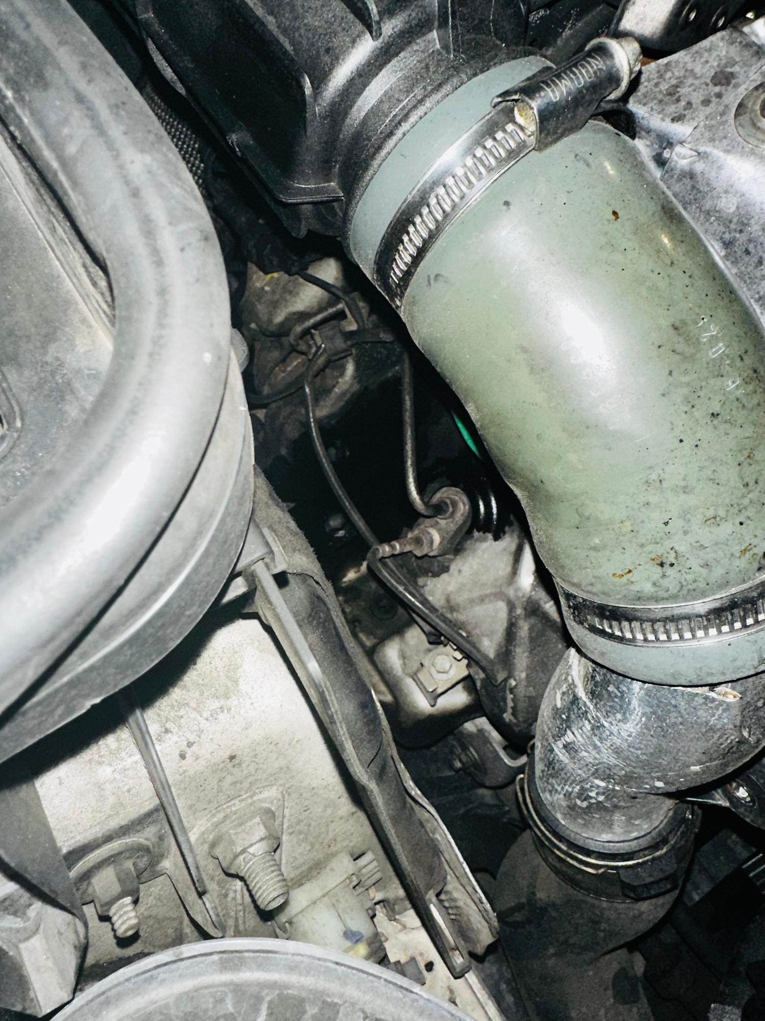

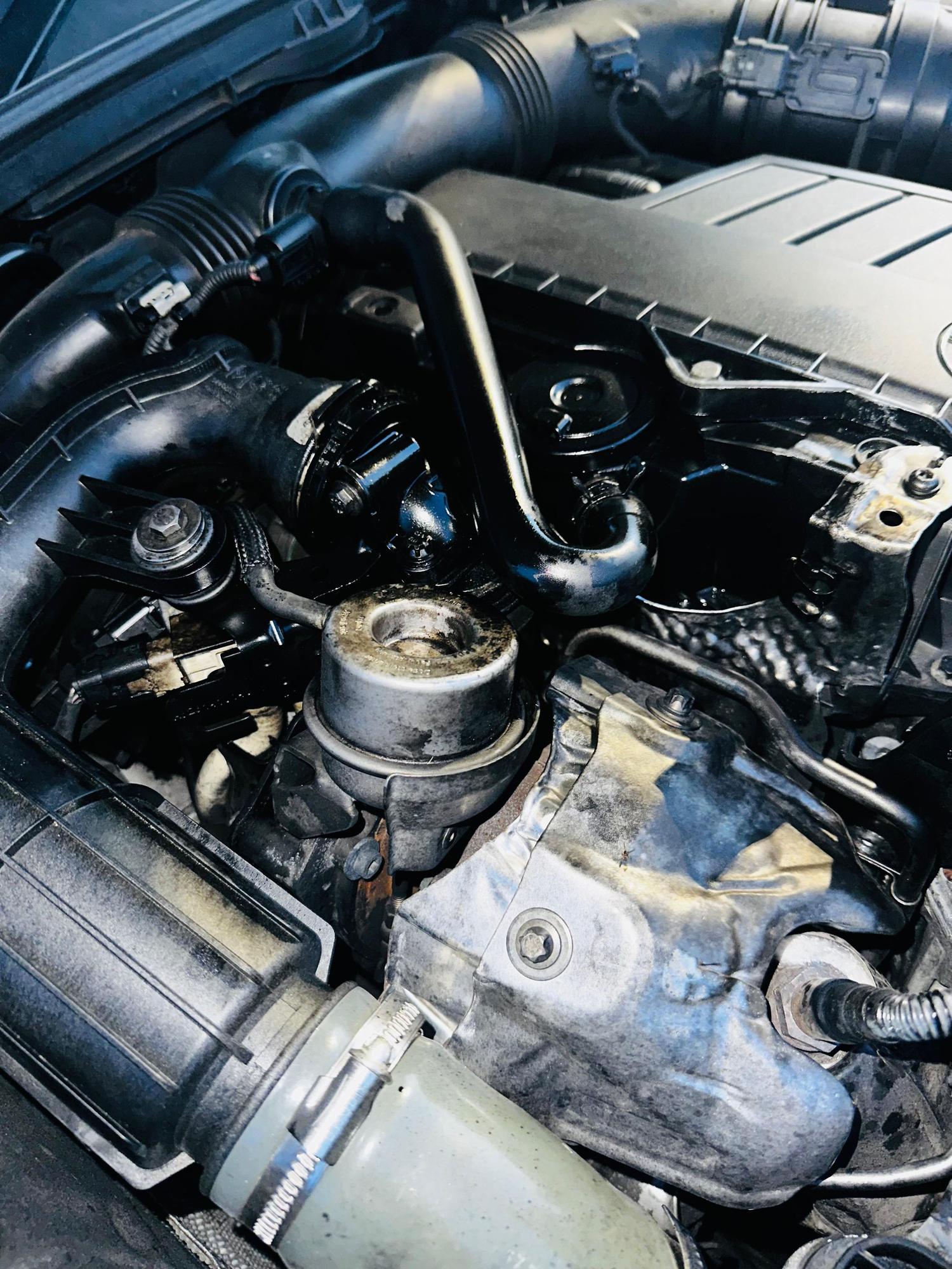

C200 1.6 136hp OM626 engine 9/2016; Today found traces of severe oil leak on top engine. Oil seems to leak from rubber pipe connection on the left side, connected with the air exhaust pipe. No warning on display. Presently in a remote zone without service available. Anyone any hint? Thanks!
check the oil vapor pipe, it would be the one that goes into the suction pipe if it is not loose, I solved the problem with a cable tie

Hey where is that pipe, can you share a picture ?
