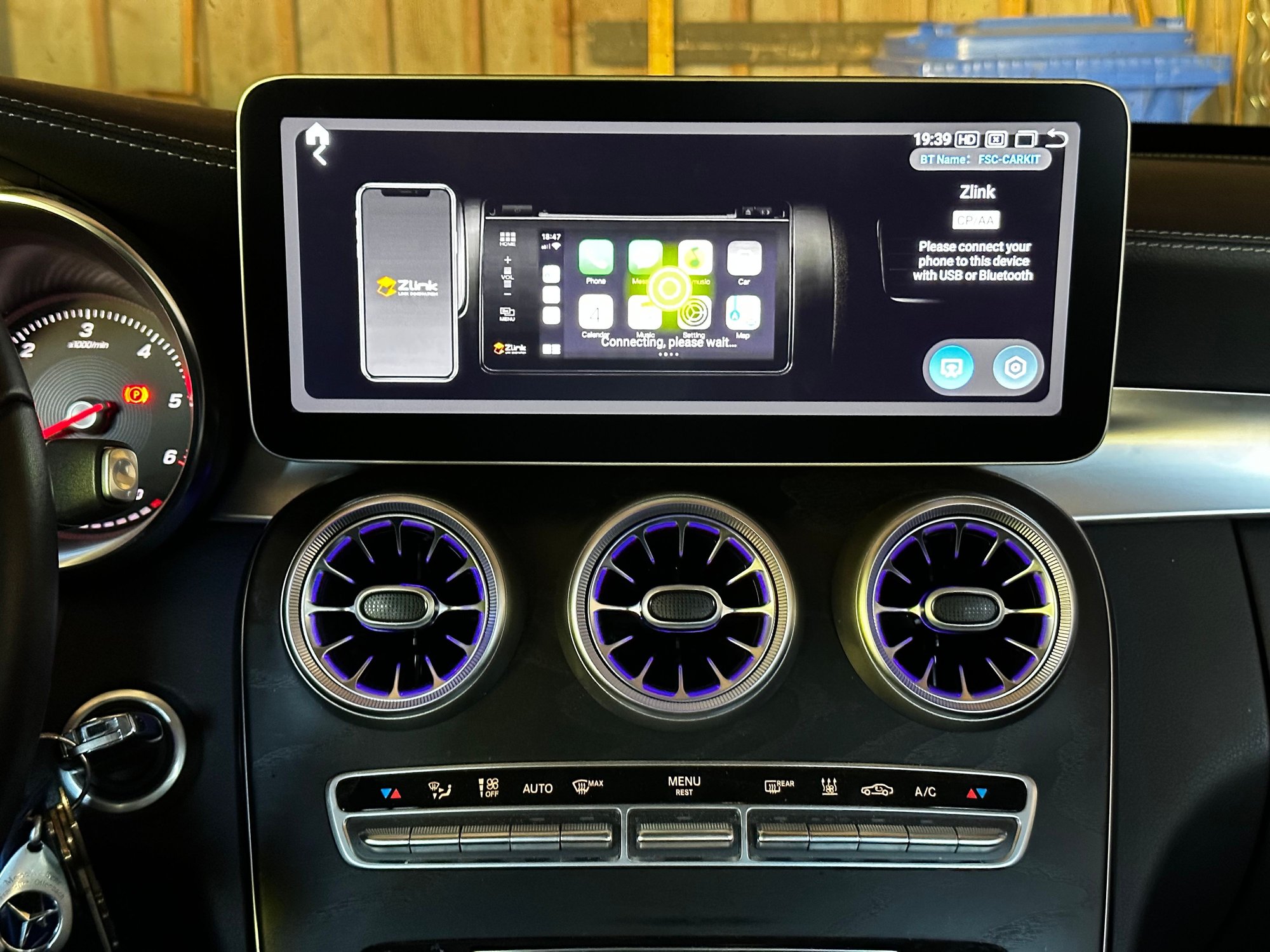

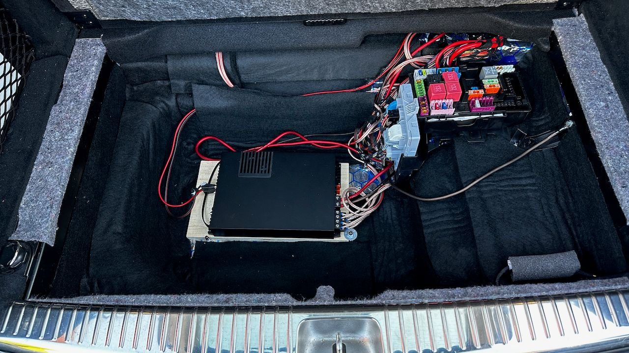

I have retrofitted original Burmester Subwoofer (8") BiWired and use a Mosconi Gladen D1 130.4 for this, in my case I have chosen the DSP version. The Midrange and Tweeters are connected to the Comand system, only the woofers work with the AMP. For the Mosconi I have ordered a remote control as well.
In your case you could go for a DSP, but meanwhile I would not recommend it any more, you do not gain a real advantage of that. With a good AMP you can set all values (Gain, Subsonic, Cutting Frequencies) and will have it work without any loss of quality. You can use the ETON Micro 120.2 by using the Sub channel in the footrest. Connect it to both of the High Inputs in the ETON and level it as much as your preferred volume is to listen to the music. It has a HighFreq cutting function. By the way, most of the AMPs have that feature. For this ETON I think there is no remote available. If you come in to a situation when you need "more" you will level it again, but that is not very comfortable. Maybe you should think about an AMP with remote capabilities, such as ESX500.1, a smaller one will do as well.
Plus and minus of the power supply is next to the footrest available. My AMP is in the trunk, so I have made a special connection straight direct from the comand unit. I have used the connectors and plugs and have a separate wire in-between that goes to the AMP. But in my case I have an Android Display retrofitted as well, so I could get the connectors in between the connectors. Sounds complicated, in the end it is very easy. The hard work was to get the cable to the trunk.
Android Display S205
