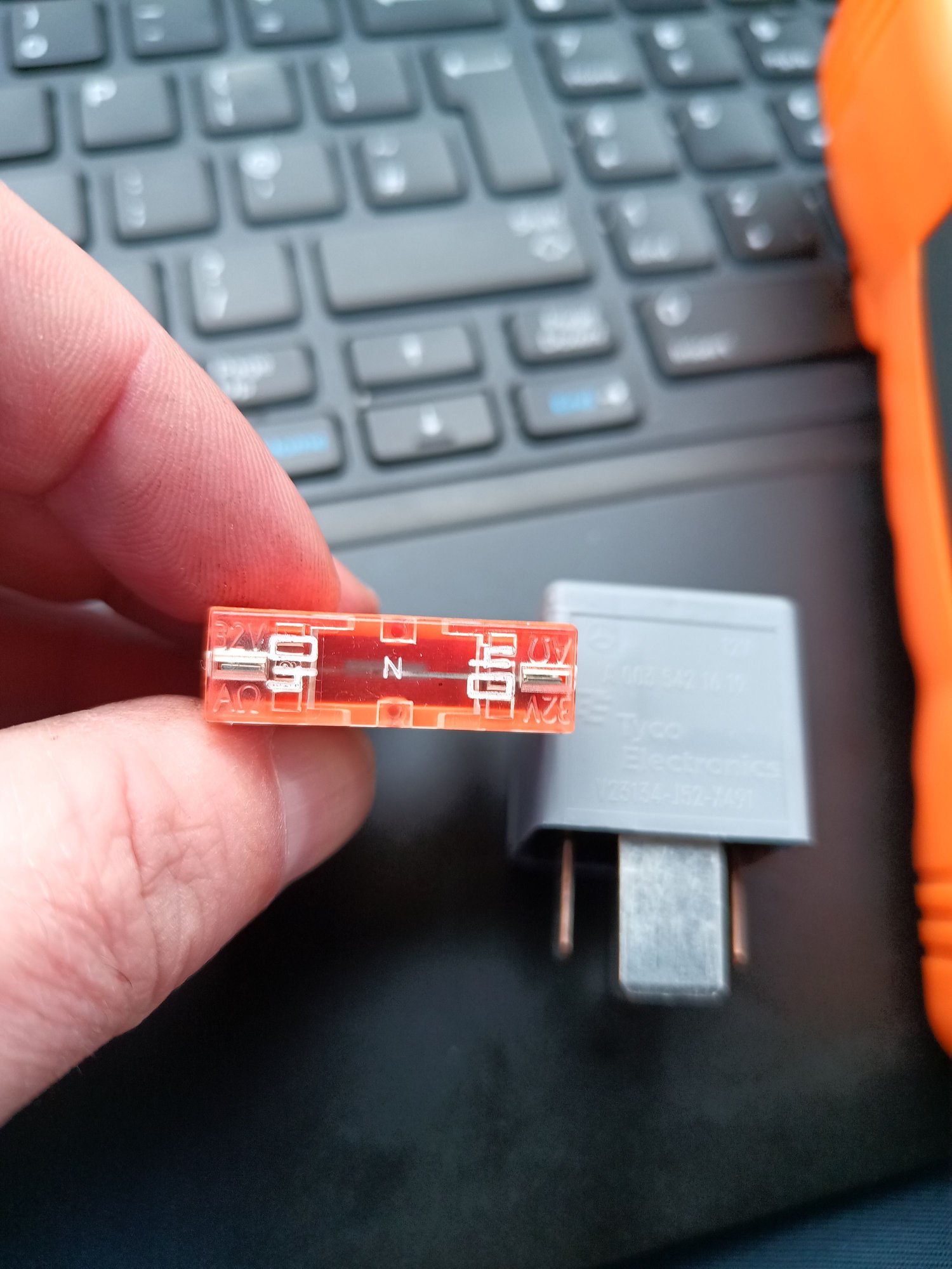

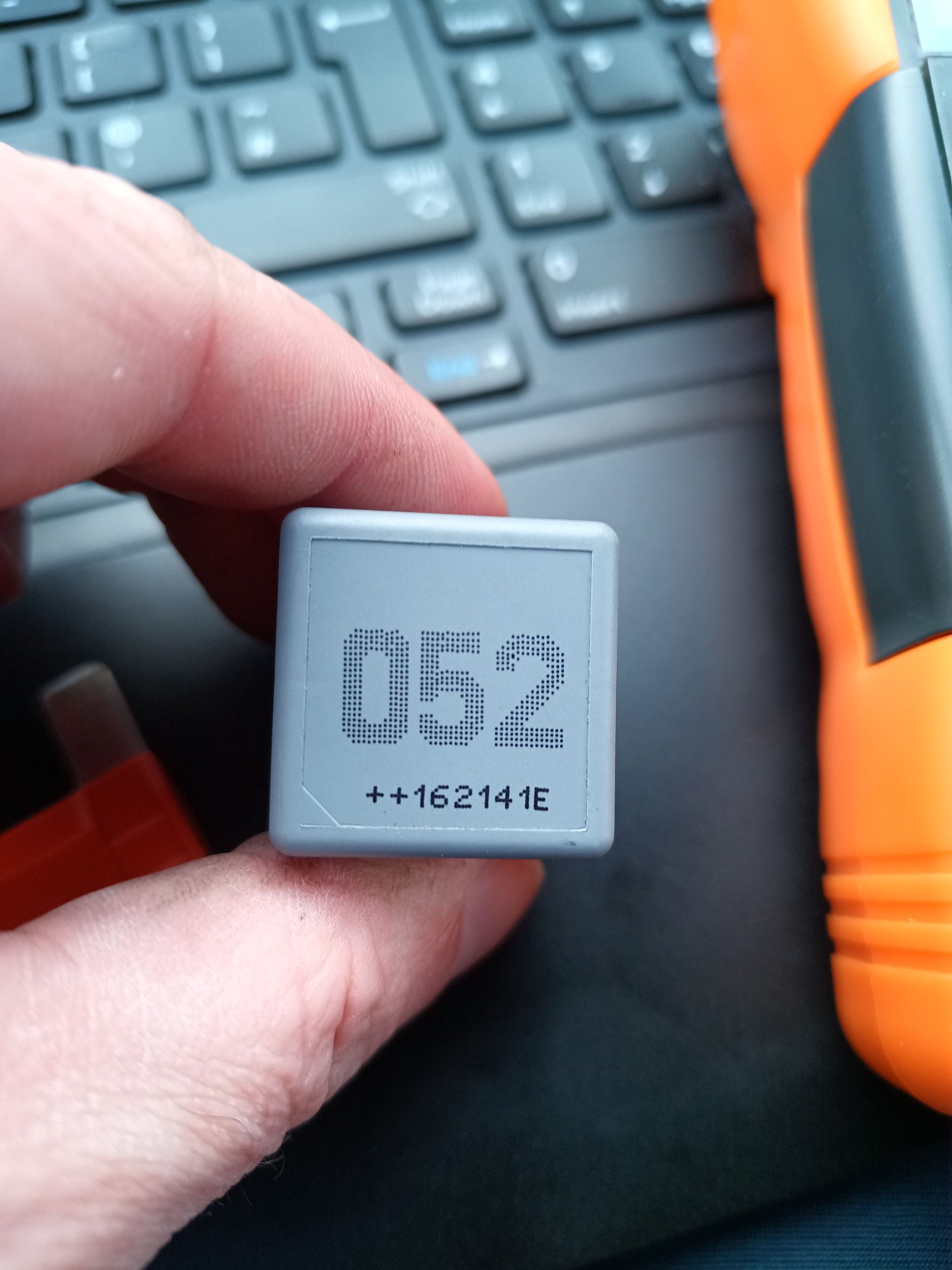

Quick update, tested the fuse & relay and both operating as should, now down to potential issue with the pump as I can hear all corners creaking as if trying to raise but not successful in doing so. The hint may be in the whine coming from the pump which is recorded in the attached video above. If anyone can spare 2mins to have a listen and advise accordingly it would be greatly appreciated for any guidance offered.
