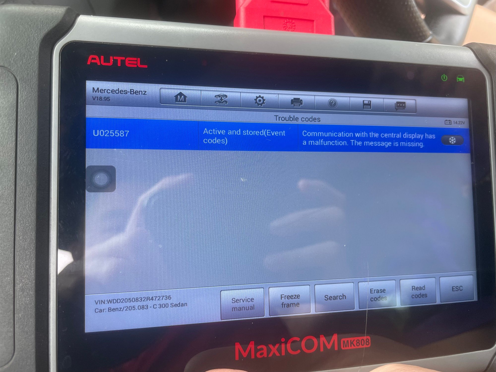

It unfortunately takes 2 weeks to get a Launch Creader. I took the car to where the battery was changed and it came up with this error. Is this a poor ground problem you reckon?
The battery test at 12.35v after 3hrs of a 4amp charger.
The autoelectrican I was referred to states it probably is the motherboard on the display side is playing up. Do you think this is the other cause if the screen sometimes turns on but doesnt turn on other times during start?

hot display
everything is screaming the display is bad yet I don't recall a replacement display being the fix. I could be wrong.
So I would directly connect your scanner to chat with display module. This will confirm condition in more than one way.
The DTC message does not say to "replace display" so we go ahead and test display instead of rolling the dice.
