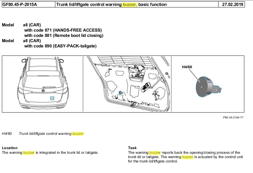

Hi everyone,
I'm new here and new to the brand. Recently purchased my first MB S205 (w205 estate) 250d premium plus and I absolutely love it. However as every old car has some bids and pieces to tidy up (door handle lights, roof bars peel).
My main priority at the moment is to locate the trunk/tailgate buzzer as I have a fault (open circuit) to it which will then limit the functionality of the operation of opening from the key or "kick" open as well.
Hope someone can help. Thanks in advance and regards.
P.S. RHD vehicle as I'm based in United Kingdom

Hi, the location of the buzzer is as per below:
Thanks, this is exactly what I was looking for!
