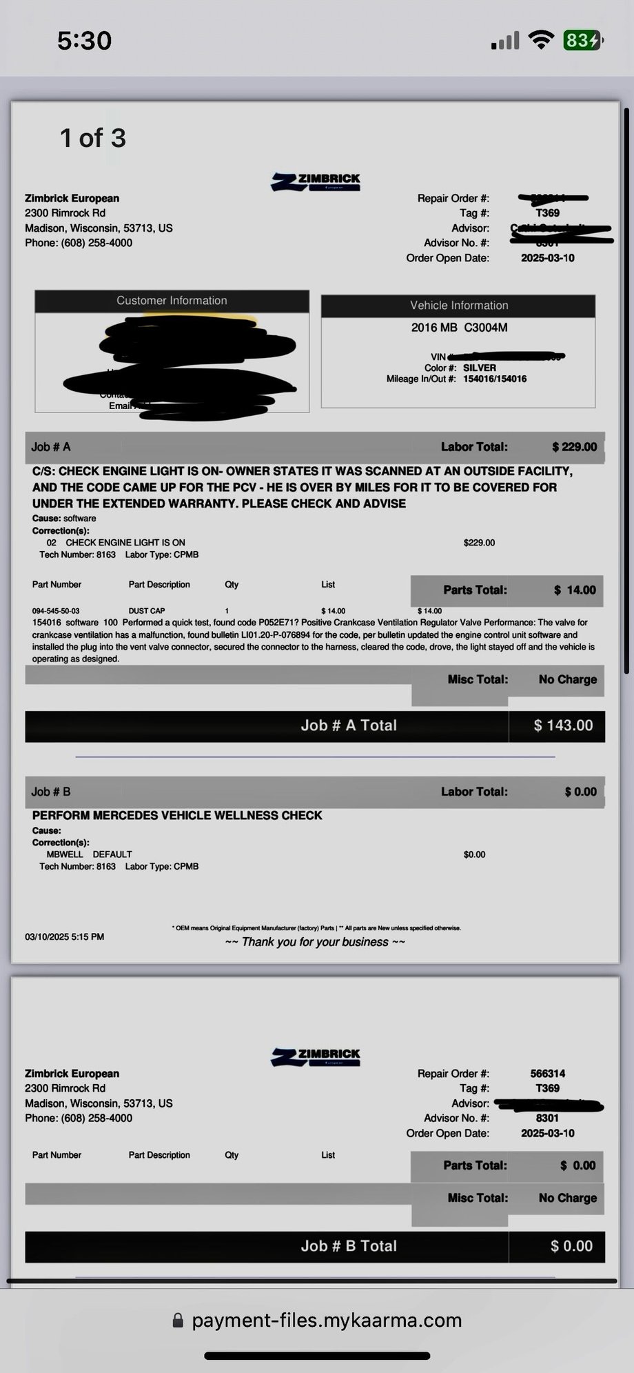

Guys so I’m being doing some research on this code and I seen that it has extended warranty but my car is over the 150k miles, took it to the Mercedes dealer today and got this. Tell me what you guys think.

PCV fault... good deal
that is an effective MB Dealer repair
software + plug.
