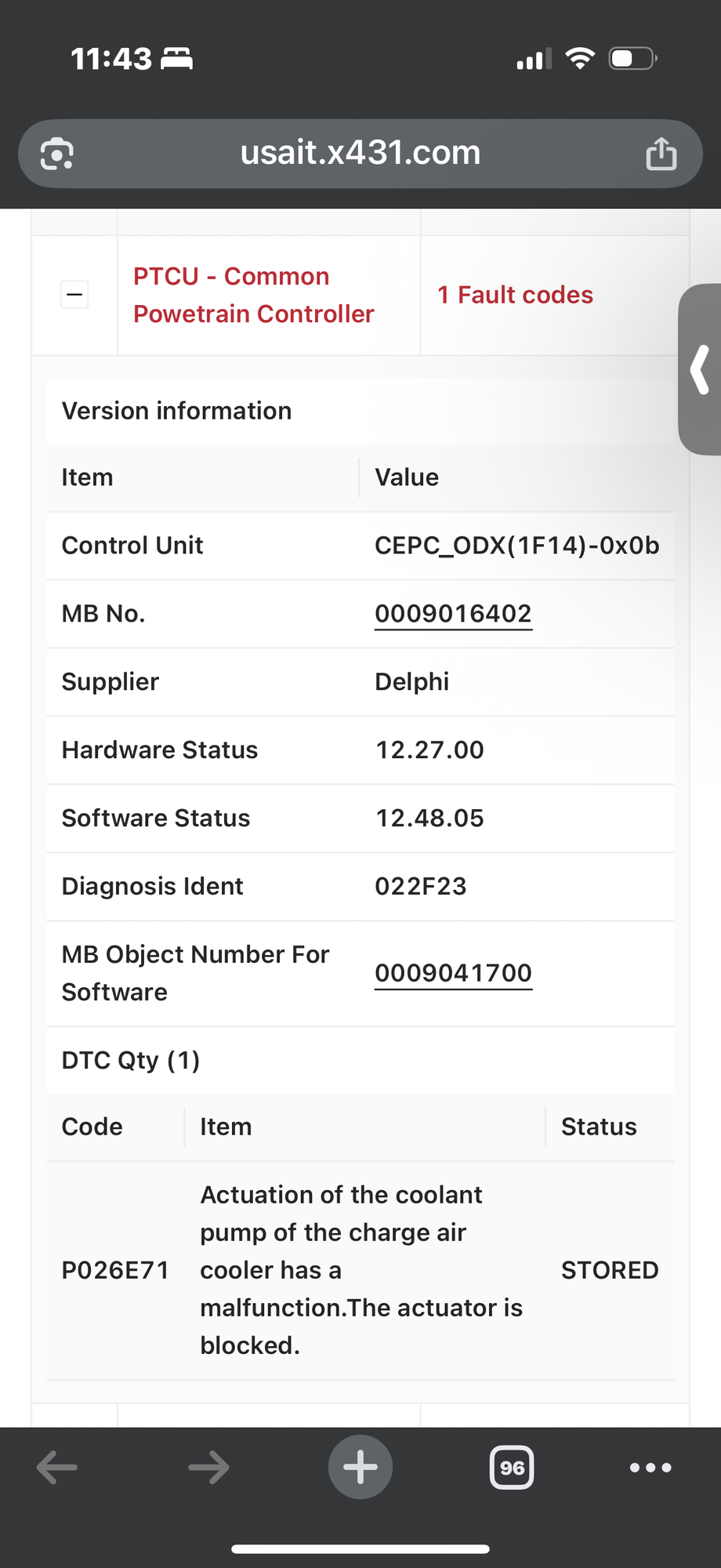

Hi everyone! I’m having some issues with my transmission and was hoping I could get some help. My car is at 110,000 miles and I’ve been having jerky shifting between gears, especially when the transmission is cold, even if I’m not accelerating hard. I replaced the camshaft sensors as well as the crankshaft sensor to no avail. The transmission fluid was last changed around 91,000 miles, so I doubt the transmission fluid has crapped out but I’m gonna do a flush and clean the solenoids in the process. If it’s not having to do with the fluid being low or contaminated, would a likely possibility be that the transmission tcu could be malfunctioning? I’ve heard they can be problematic. I took my car to the mechanic and it pulled up the code P026E71 and it states that it’s regarding a coolant actuator valve malfunction. Could my transmission be overheating, therefore cooking the fluid, or could this be indicating a problem with the tcu. I only ask as Mercedes have been known to give inaccurate code readings. Im just spitballing and looking for some insight from more experienced people. Trying to avoid wasting more money than I have to on narrowing down the issue before it become irreversible.Attached I have the results from the obd scan. Thank you so much!

Has this been happening since before or after the last transmission oil change? It looks like they are using launch as diagnostics, did they try to activate that pump?
Auxiliary coolant pumps are known to go and their importance to good performance is underscored by modding to always on.

I haven’t yet, we’ll see once I empty out the drain bucket. To add, the solenoids are spotless besides a bit of grey oil on the casing. The rest of my diagnosing is gonna have be after replacing. Also bought a replacement aux coolant pump but I’m not gonna have time get to it. The transmission fluid doesn’t smell burnt so I don’t think the blocked actuator caused it, but I’m still gonna be replacing it.
