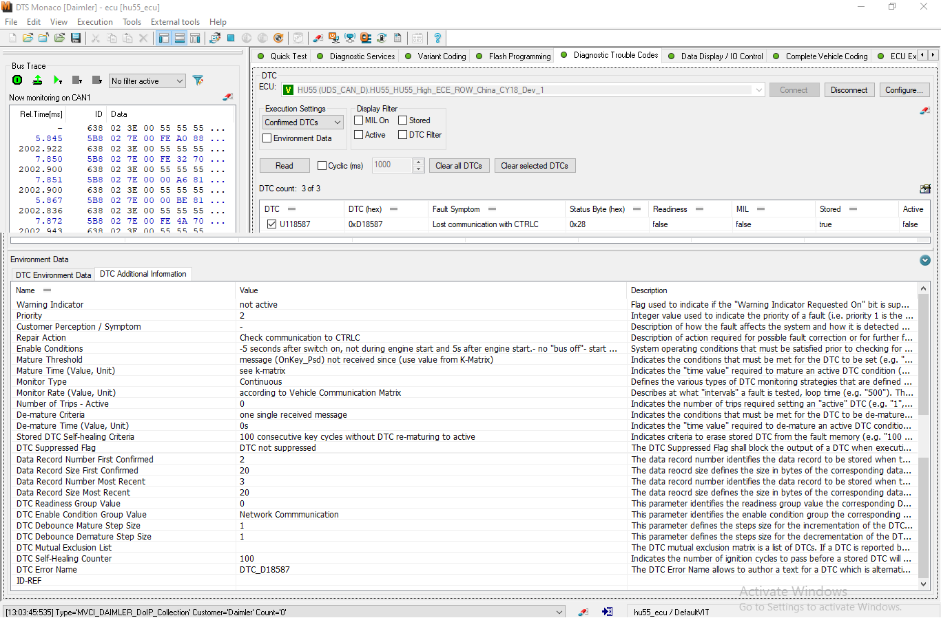

Originally Posted by Sopra
You should try ask @BenzNinja Btw, your fault is stored.
sometimes i check, then i clear all DTCs

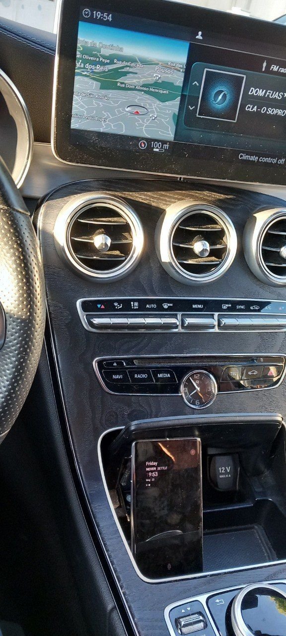

In my opinion, one of the noblest things a human being can do is share information.
so, here's more information !
the cell phone in that area was also causing the Lost communication with CTRLC
putting the phone in the door, i never Lost communication with CTRLC again
