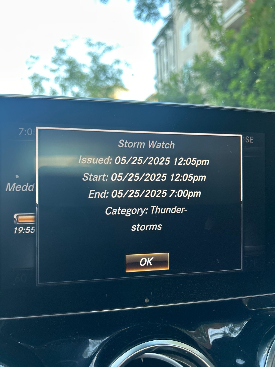

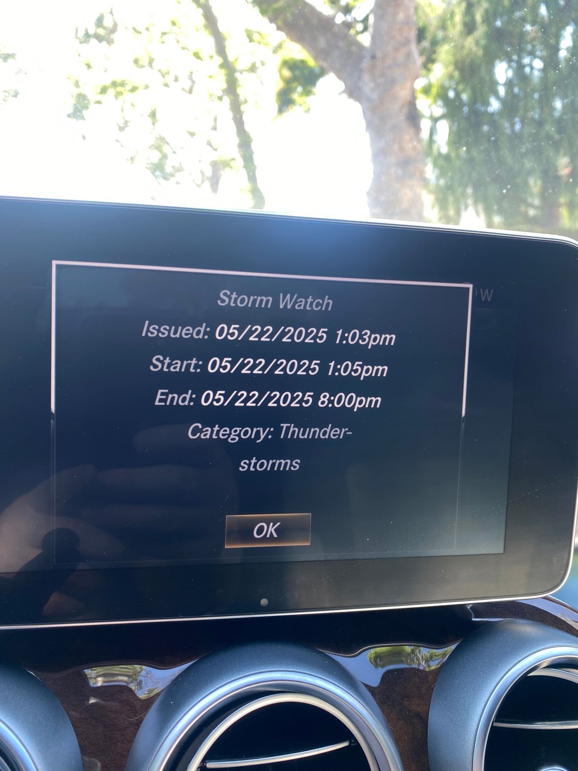

Storm Watch Warning Command: Get Rid OF
I don’t see any kind of weather app on this command and this storm watch keeps coming up which is incorrect for where I’m located.

Same
I have the same thing recently everyday

C300
Interesting, second time I ever see this and both times is on the forum in this thread, any chance you two live within the same area as in state.
I live in Orange County CA. It is just weird because everyday is sunny hahahaha

Yep, this is tied to SiriusXM Weather in the older models that get live traffic through SiriusXM. On-screen severe weather alerts is one of the features. SiriusXM periodically runs free service for a few days, so even if you don't have an active subscription, you suddenly receive live traffic and weather alerts. They are doing this to entice people to sign up if they like what they see. I'm guessing in this case it has the opposite effect . More likely, though, given that it appears they are erroneous, SiriusXM probably has a system issue on their end sending out wrong alerts.

Occasionally, they push a free 7 day trial, it is very random, for example, mine randomly started showing traffic again since yesterday. Did not renew or subscribe anything. Dealerships also might partner with SirusXM and offer a free trial after a service visit.
