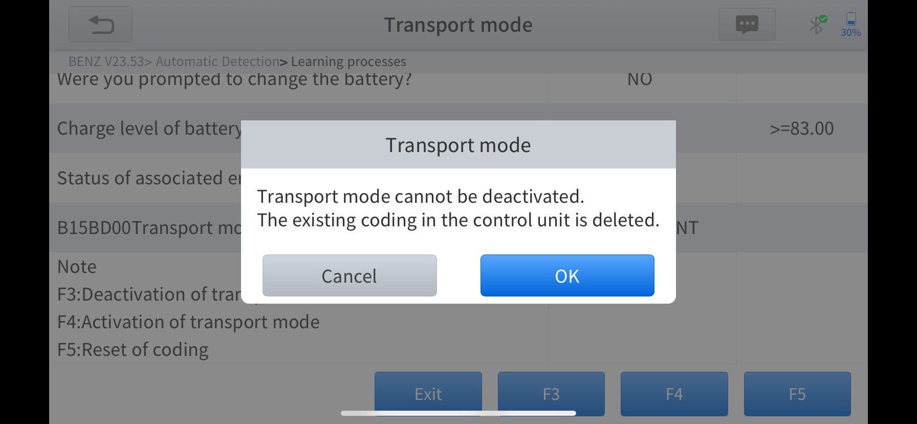

Transport Mode Cannot Be Deactivated.
I've been dealing with the U016887 fault tied to sliding pano sunroof for months along with random module faults.
Took out the sunroof console and hit all the plugs with contact cleaner. The error has not come back.
All roads seem to go back to battery. New Battery was put in December 2024.
Has anyone dealt with an issue like this?

Update 1
I removed all the sunroof console plugs and sprayed them with electronic cleaner. So that resolved that but the battery drain remains.
I suspect the module is being kept awake or destabelizing CanBus network. The Telematics 3G module was deprecated as well.
So likely both contributing to drain. Trying to find remote SCN coding. The dealer labor rate is $304.88 an hour. Insane.

@W205C43PFL Clearly a parasitic draw going on which is causing faults and destabilizing CanBus network. U016887 fault tied to sliding pano sunroof has come back once the battery went under 60%. I have managed to get the battery up to 83% by driving but it won't stay there. I suspect the alternator has limits.
Possible Multi-Fold. The Hermes module. 3G Telematics service was deprecated and the amplifier connection is preventing the fiber loop from closing..This fault keeps coming back every few months.
@crconsulting AnyScan A30 is a solid reader but you're correct, it's not sufficient here. An MB specific scanner. iCarsoft MB II or MB V3.0 should give me a reliable scan.
My Working Theories:
1. Module is stuck in transport mode because it lost its coding (past low-voltage event). Odds 30-40%.
2. Most likely, SOC lockout. It's likely restricted until the system sees stable charge cycles.
Parasitic Draw:
The MOST bus (media system fiber loop) (likely bigger drain) + telematics 3G causing the overall parasitic draw.
MOST fault is intermittent which is explains why battery % is worse some weeks.
ACTION ITEMS:
1.
Buy a better scanner
2. Charge Battery
3. Check amplifier connection as I'm getting speaker 1 connection.
4. Put on optical by pass loop but will pull fuse in interim..

Update - Getting Closer to Taking Out The Vampire!
I got the 2025 LAUNCH Creader Elite V2.0 but I could locate transport mode. It has a lot of restrictions and the battery is too weak to
access certain modules just to read. I need the battery stronger and charger on..
It seems the 3G module is the vampire. Evidently the government sunset it but MB left people twisting in the wind.
Yes I could use the remote coder but he has min cost and equipment deposit which is too much for this small job.
