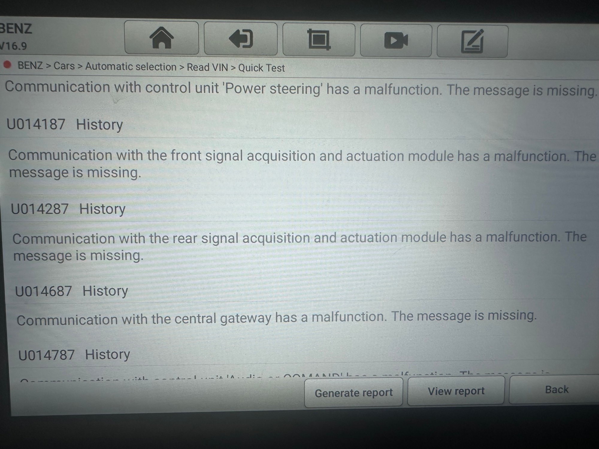

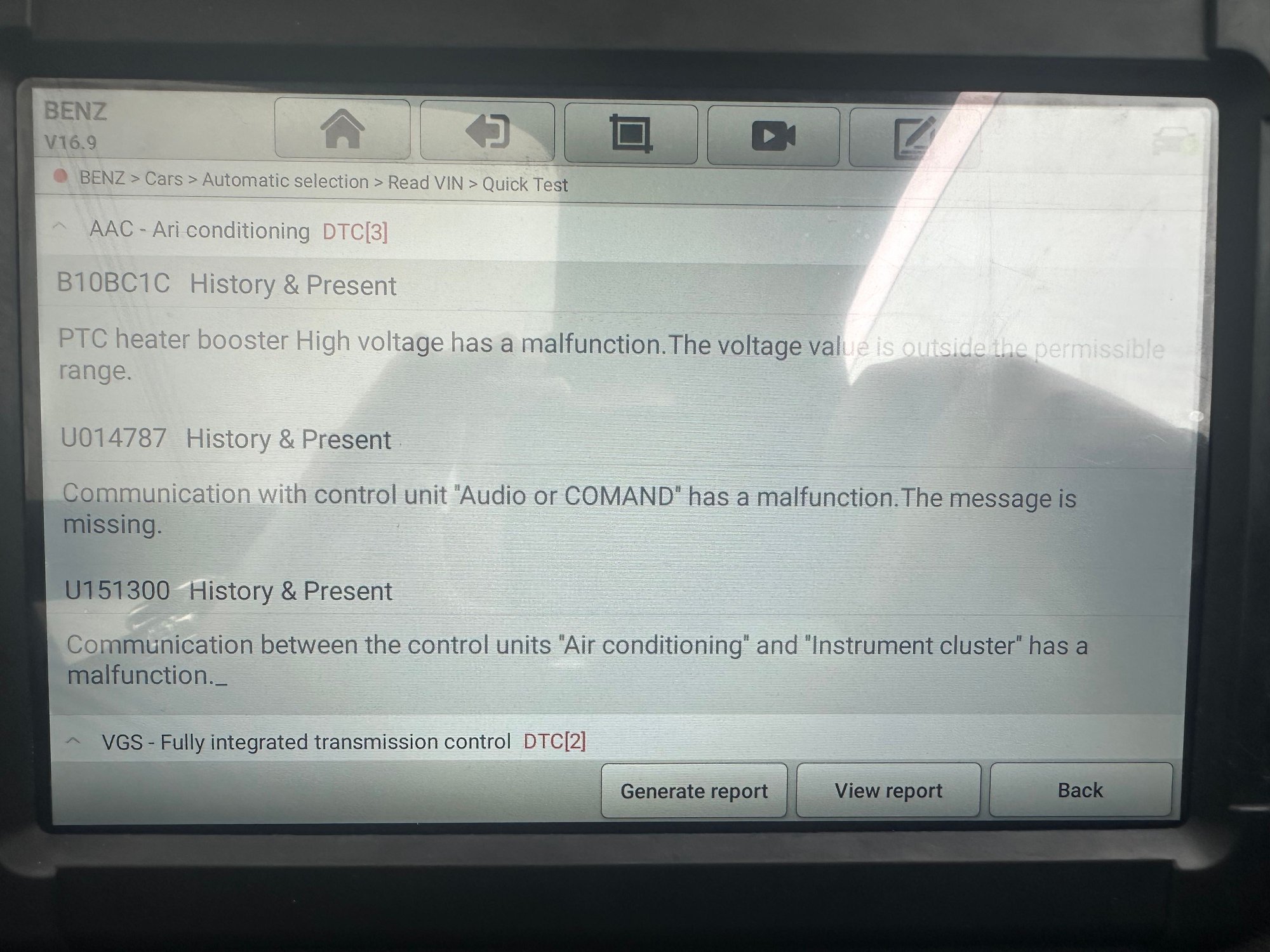

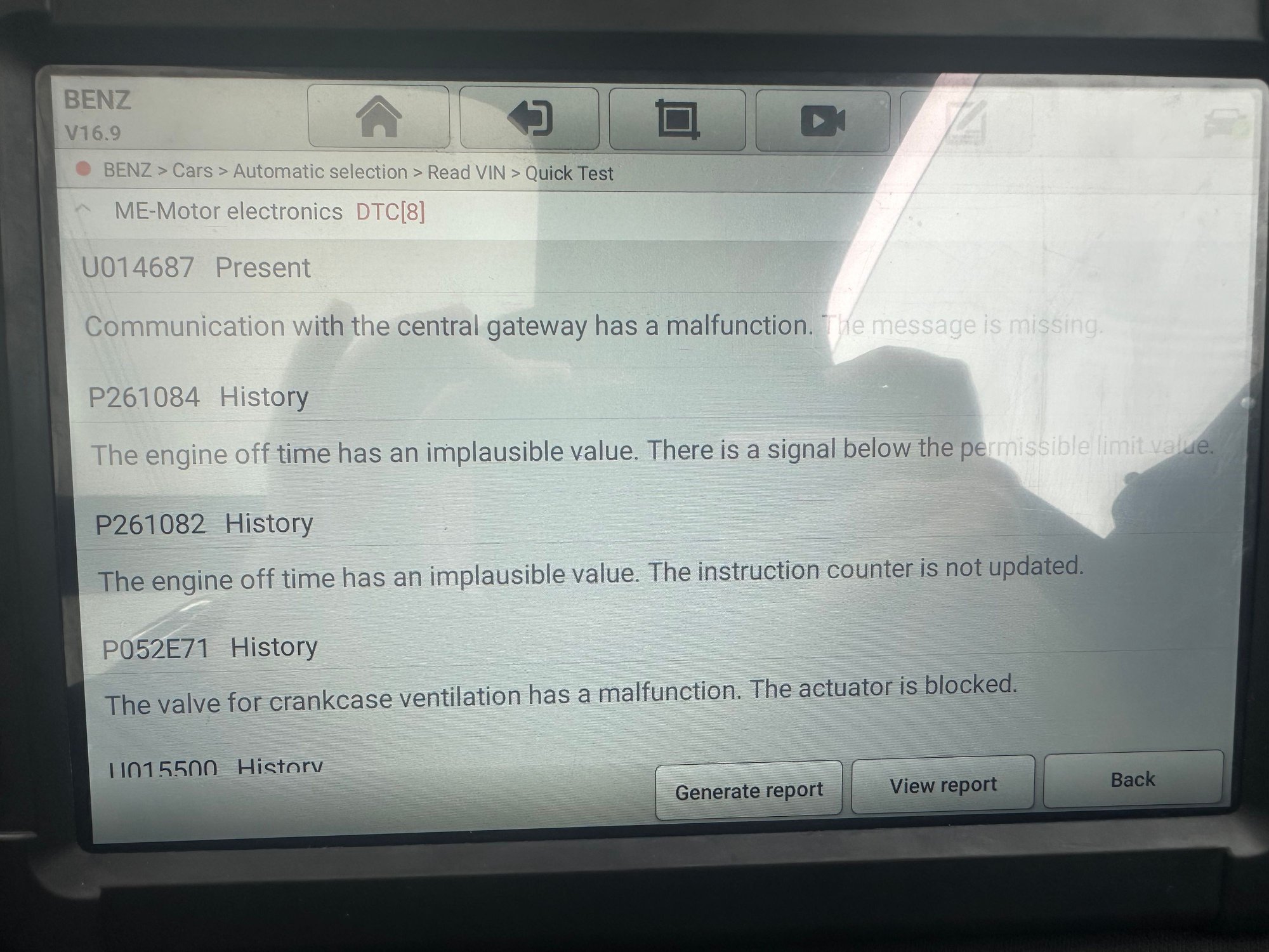

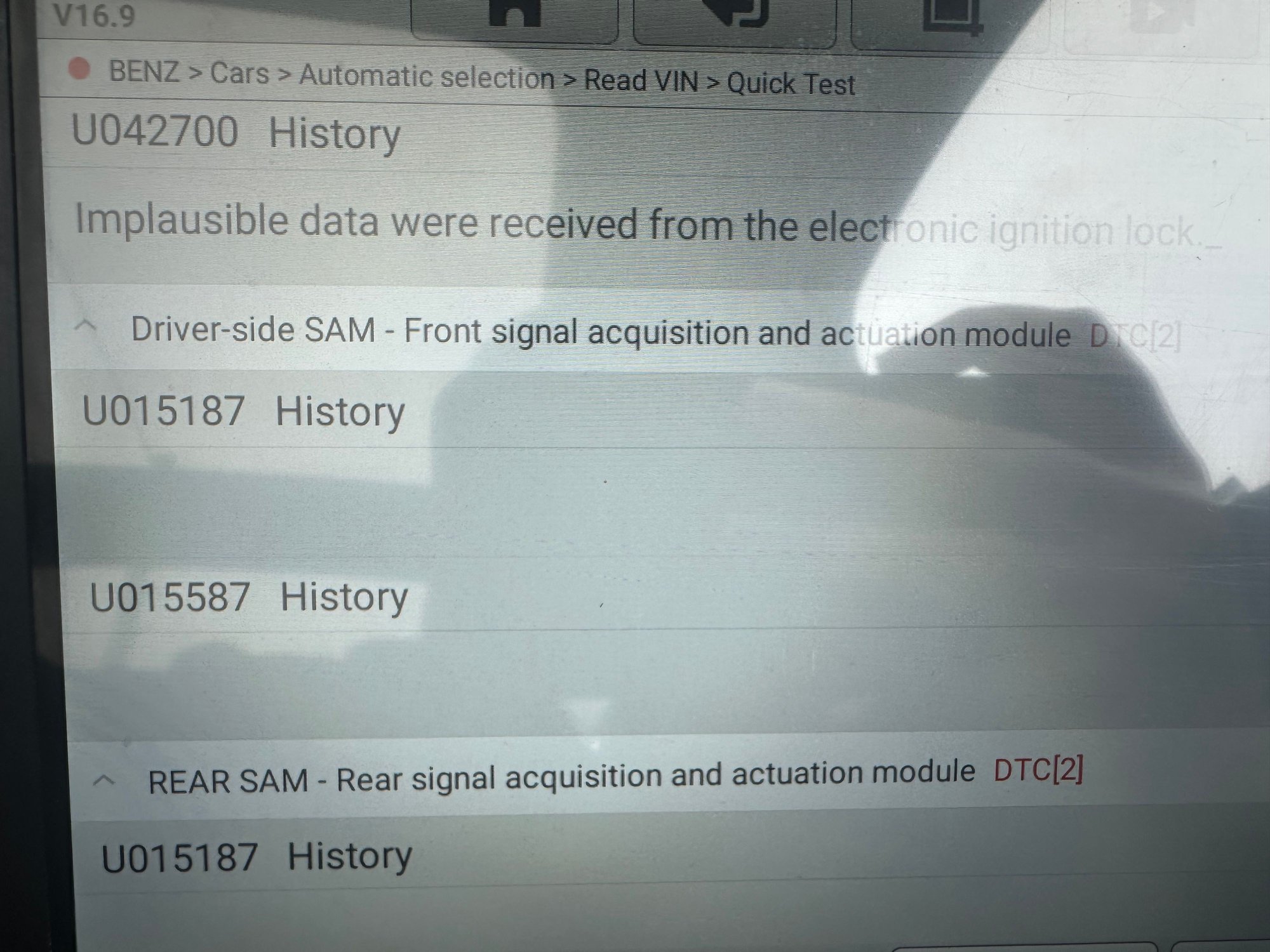

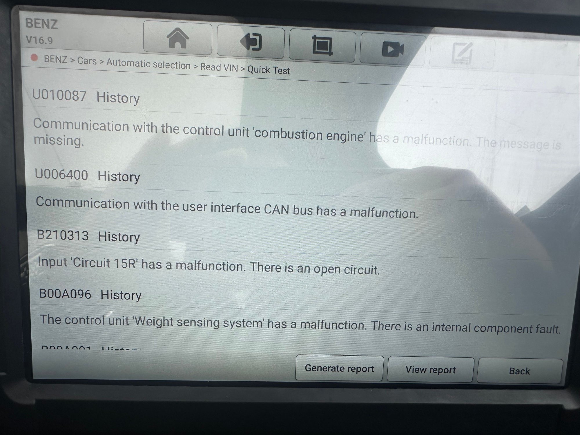

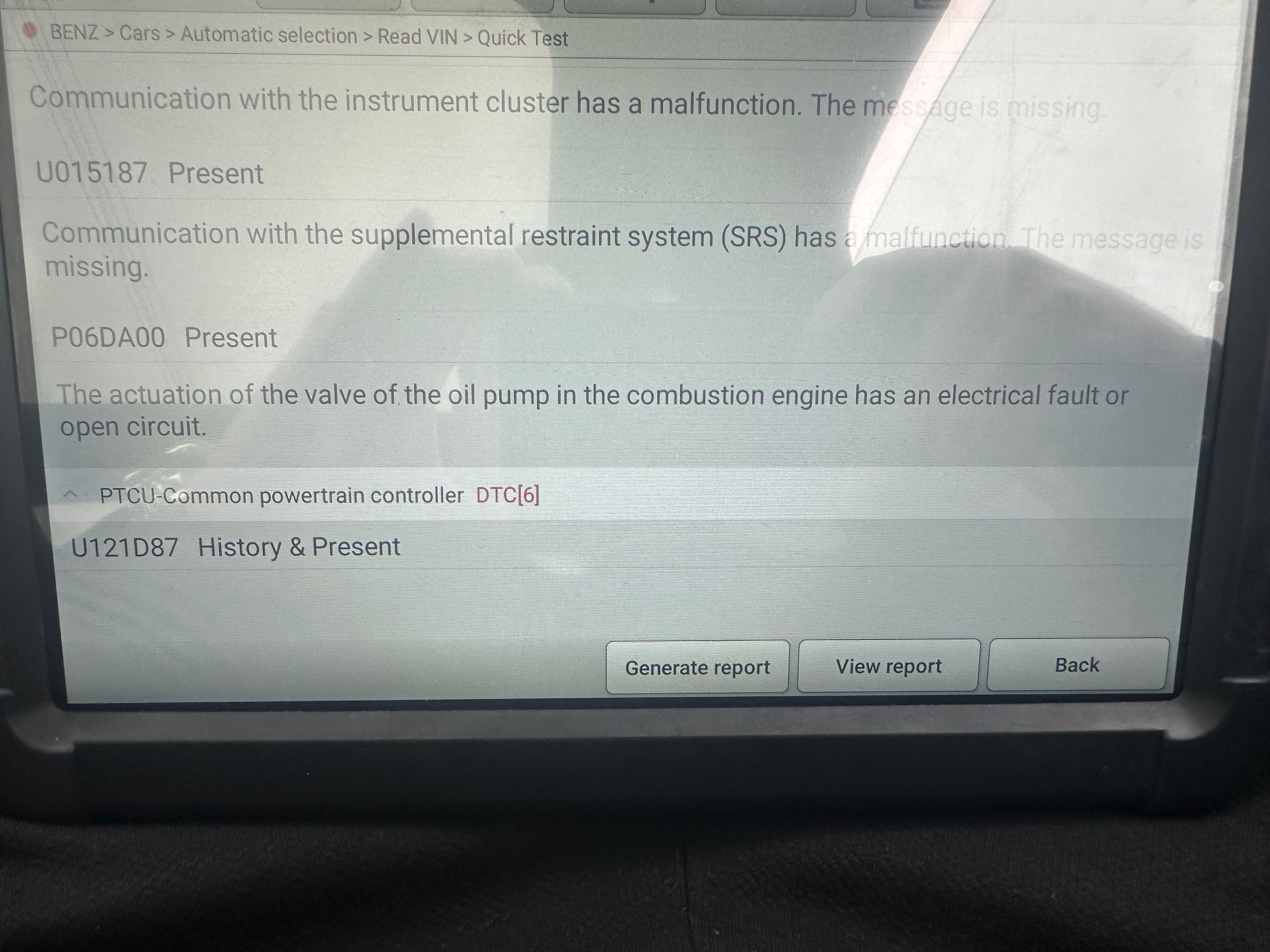

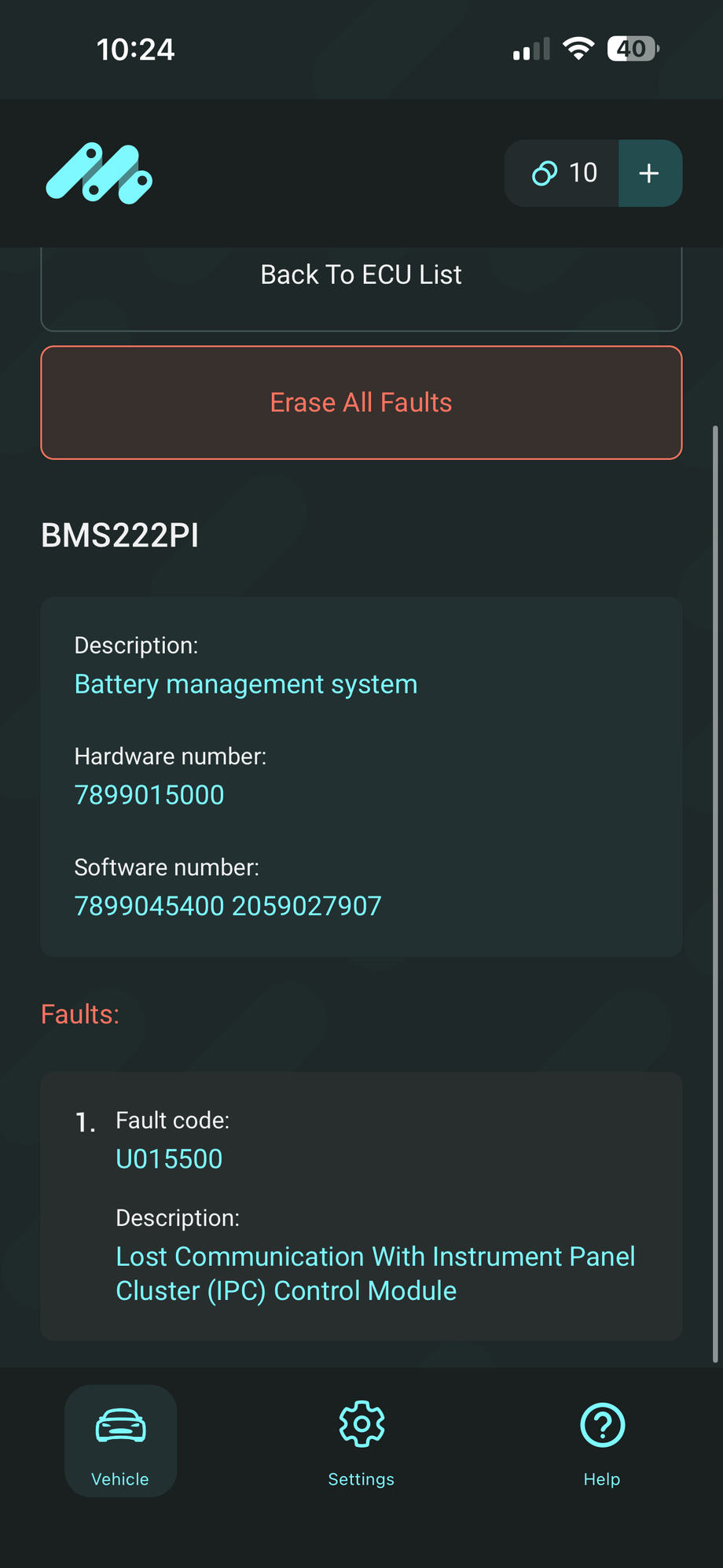

im get 50+ “Message missing errors” and nothing definitive in any error code reading either from normal OBD scanner and from independents Xentry scan.

Based on your fault survey, what are the failing modules... IC + F-SAM ?
Can we say this is CAN-B related ??
If I were you I'd double check live voltage when this happen: below 12v or above 12.6v ??

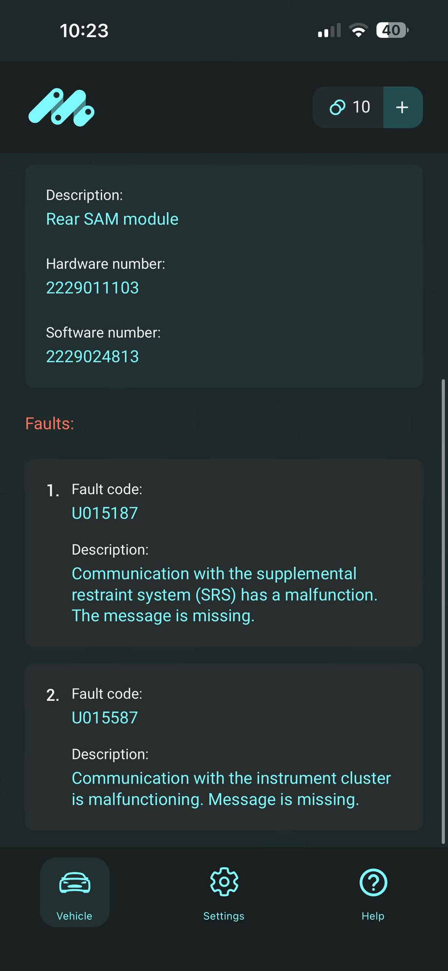

Mainly noticing FSAM, IC and SRS.
i disconnected the IC to try rule it out and it still happened. So I know the IC is good.
just down to SRS and FSAM, I’ve attached a video of voltage to SRS when this happened, unfortunately I can’t get any voltage from fsam
