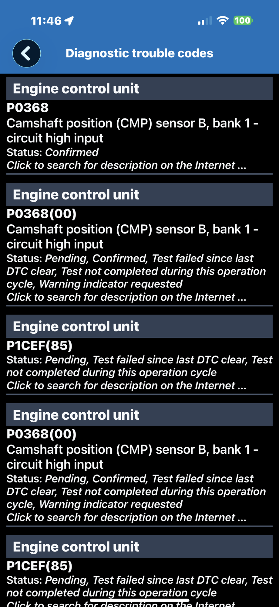

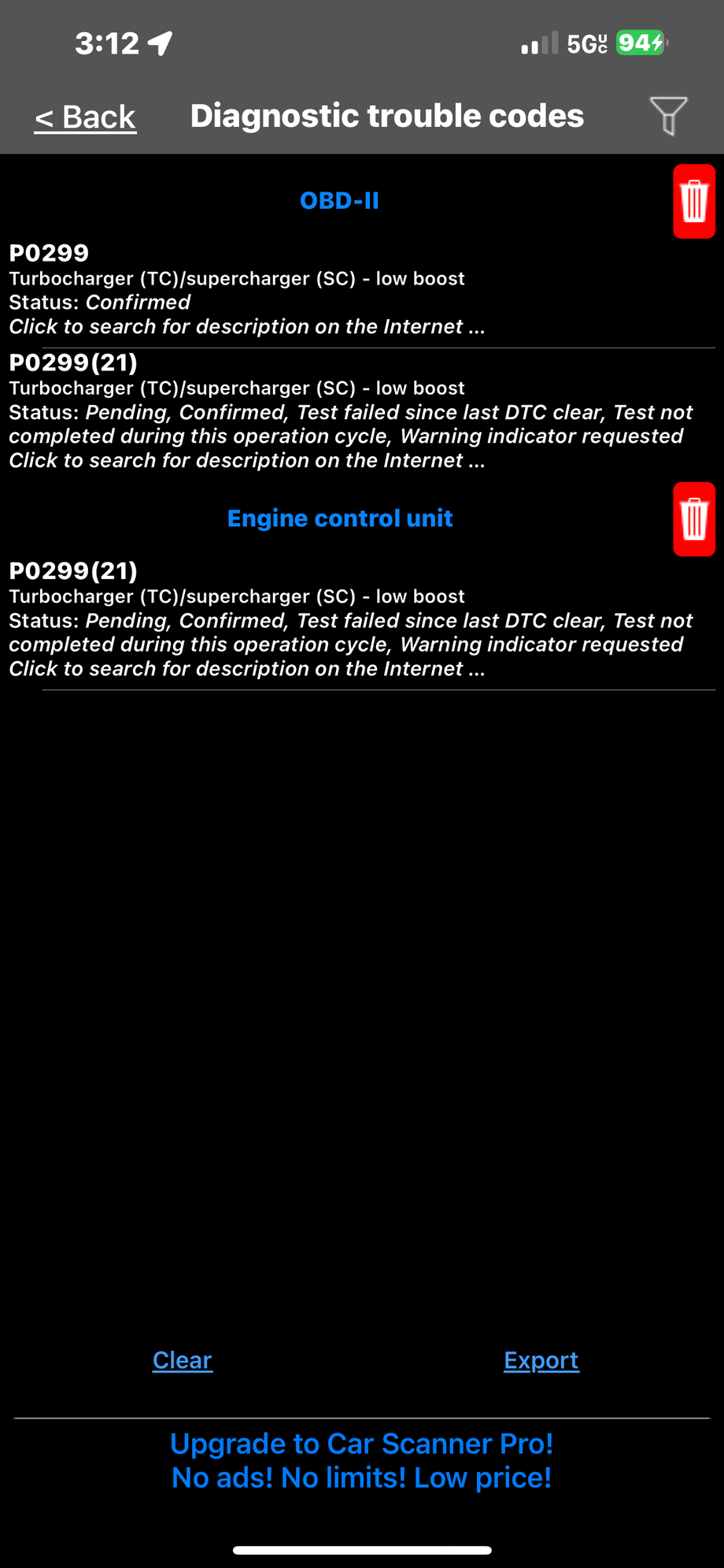

I have a 2016 Mercedes C300 RWD. A year ago, the car got a check engine light for turbo low boost. Accordingly, I replaced the Turbo and once I started the car, everything went fine except something was a little bit weird; once I start the ignition every-time after replacing the turbo the check engine light and airbag light stays a little bit longer than the other lights on dashboard then disappear. I don’t understand stand the reason for this!!!
a couple days after once I kick down the Turbo the car starts to shake like misfiring is going on the. The check engine light flashes and stays on. When I check the code it shows misfire!!! If I cleared it the car drives totally normal only if I didn’t kick down the turbo. Since then, I replaced the ignition coils, spark plugs, air filter, cleaned throttle body, replaced crankshaft sensor, camshaft sensor, camshaft magnets. The car drives totally normal but this light for the air bag and check engine stays a little bit longer. The car gave me the codes which I fixed and cleared but still not normal once I kick down the turbo. Please any advice will be appreciated based on similar experience. I attached a video and a screenshot for clarification.

You have all new turbo + ignition Coils + Splugs + CPS+ Solenoids already installed.
What is your current mileage?
Do you understand what your scanner is now reporting... I'm not familiar with that unit.
It seems you still have 2x live issues as follows:
  1. bad cam sensor circuit
  2. low boost issue
Anything we're missing besides the above ?
Have you noticed the bad CPS giving long crank...
