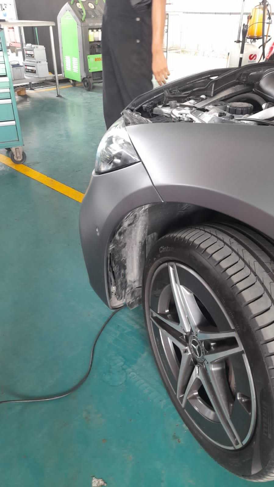

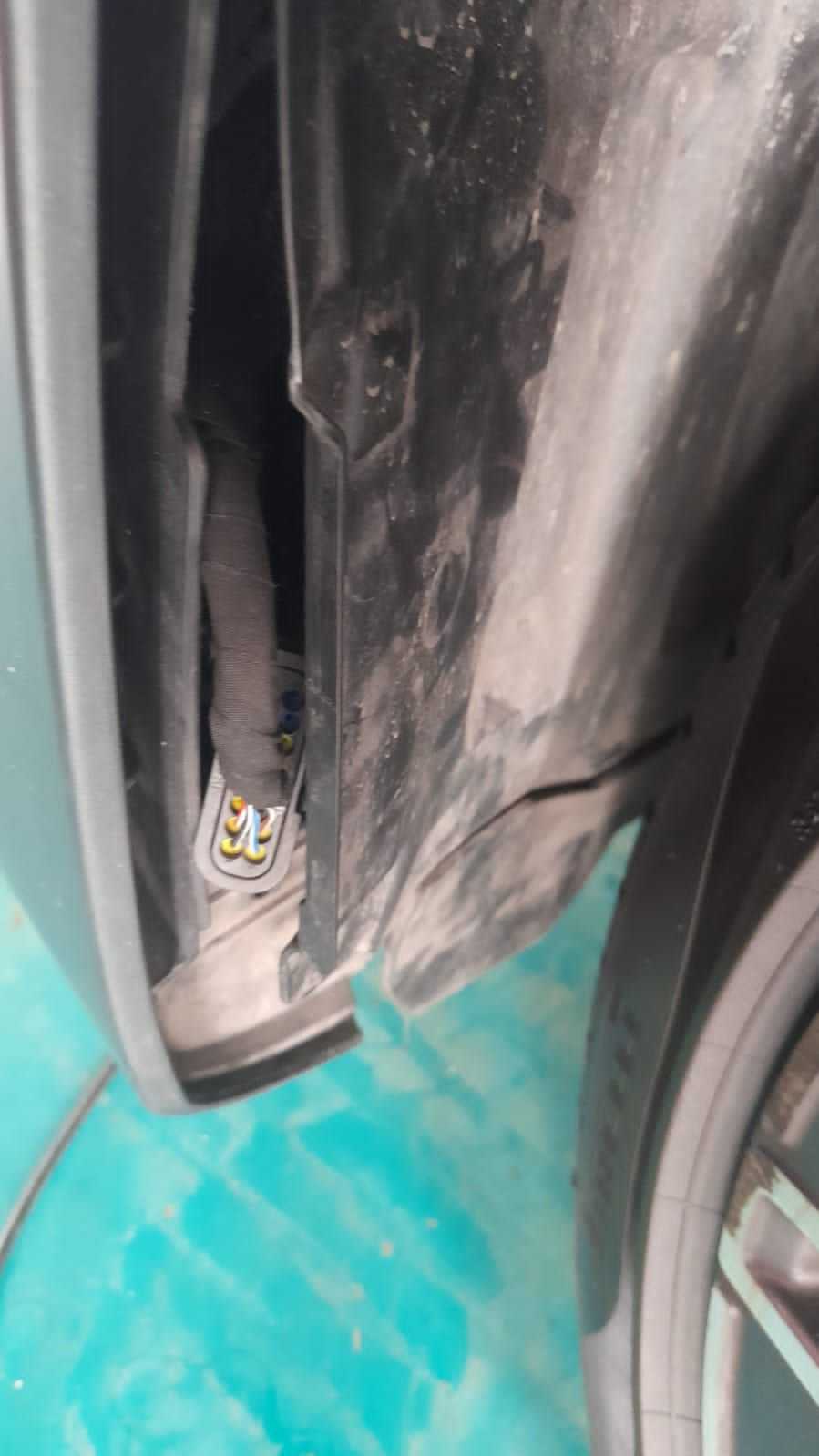

Solved too ✔️✔️
It's great that your problem was solved. my problem was also solved, it was a socket that was disconnected in the front bumper
guarantee validated ✔️✔️
