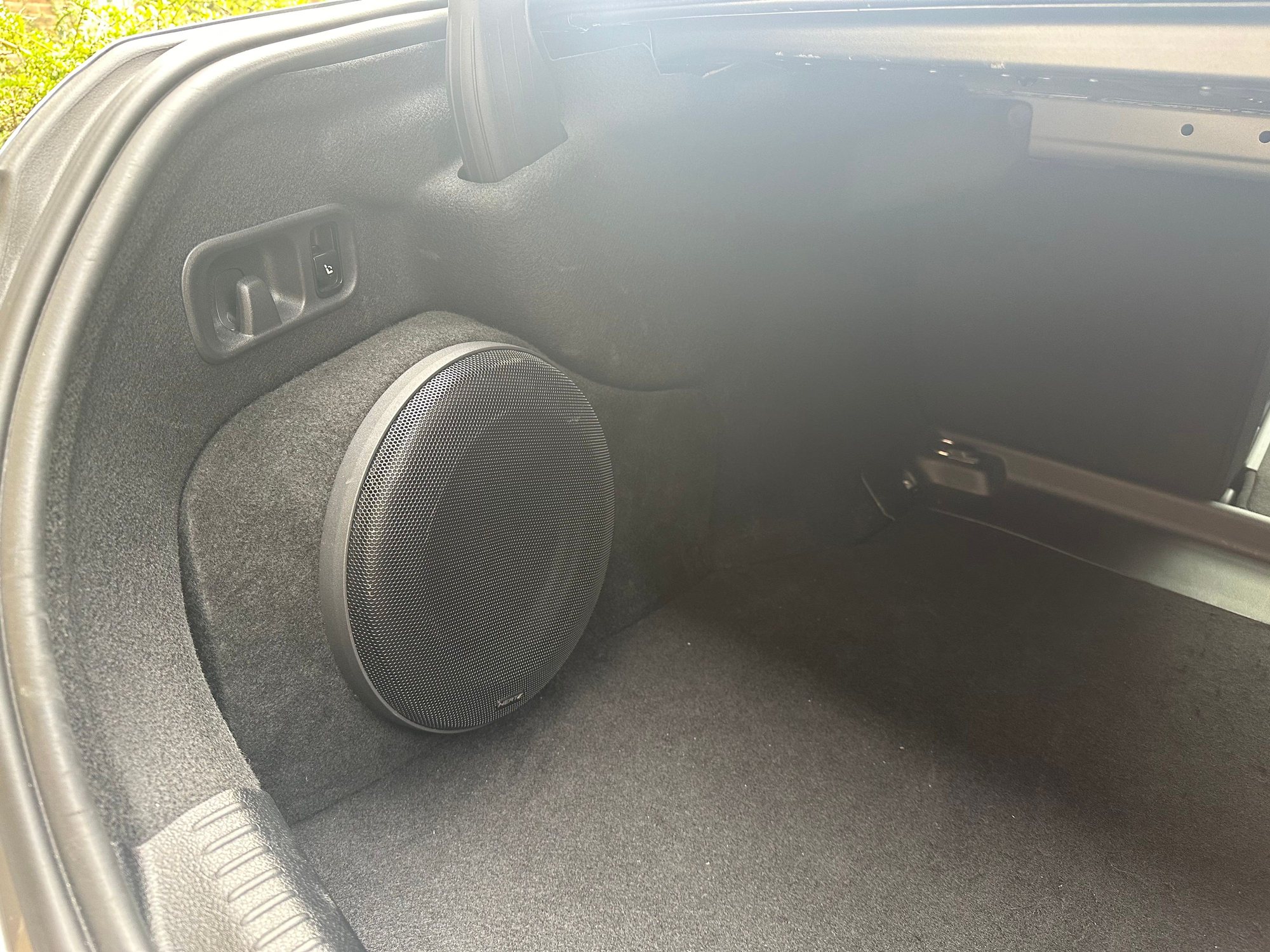

Originally Posted by HumbleBy
STEG bass-driver behind the plastic cover and Axton A101 placed between the plastic cover and the firewall.
Where did you get the 12V source from, is there a terminal near by? I assume the 12V battery is somewhere in the rear?
battery is in the rear but you can tap it from the front footwell distribution block. But I am tapping it directly from the rear battery under the trunk floor since I’m pulling like 1800w
Were you able to find a good routing for the power through the cabin without too much disassembly?
I ran my power within the trunk since that’s where my amp is (Hard to hide a Sundown Salt 2 amp in the front). And for a smaller amp for the speakers I would still advise to have that amp in the trunk since it would be easier to install and access. If you want to hide the amp, there is a bracket on the left hand side in the trunk behind some carpeting where the stock burmester amp would usually sit. Having a shorter power wire in general is just better and safer overall, even if it’s properly fused with the correct wire size.
I advice you to watch the Gladen video on Youtube where go through the process of mounting their speakers and DSP.
This walks you through how to get power to the amp.
I am quite happy with the setup I have now in my C300.
The only thing missing is dampening of the "housings" the 8" speakers are mounted in.
The music I listen to (Rock) can get quite boomy at times because I forgot to add some dampening to those chambers.

The amplifier is plug and play and can be placed right next to your woofer, it'll be very easy to put it into your next C Class if that's the plan. The power distribution unit, fuse box and the space to take the cable to the head unit is all in that passenger foot well. If you are going to change the woofer in your C300 I would suggest buying a Match 8 or Match 10, the MBUX plug and play loom and a UMIK-1 measurement microphone to tune the DSP with. All you have to do is set the frequency ranges, the characteristic name and play white noise on each speaker. The software will do the rest. It's a big cost but 100% worth it. Also it sounds like the helix front woofers will be more than enough for you, the german forums that I think you said you've read rave about how good they are.
