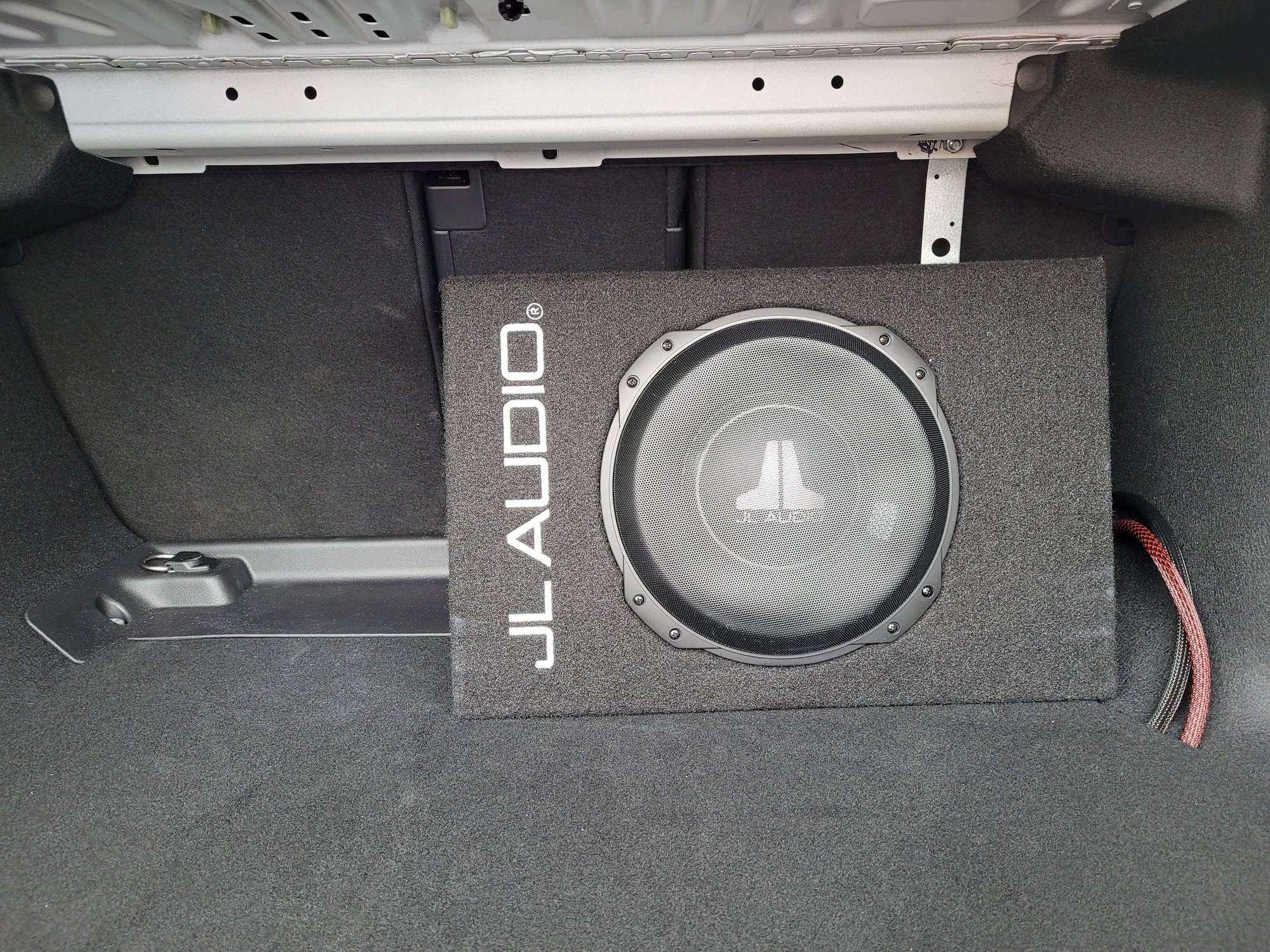

This was my solution: a 500 watts JL Audio amplifier and a 10" JL subwoofer connected to the only 8" subwoofer (it's really a woofer) on the front passenger side. The difference is incredible

Oh nice! I also got a JL sub in a prefab box but it’s a 12” and ported. I’m thinking of getting another sub or a more powerful one haha. Btw I recommend lowering the middle seat because it will make it louder and I think the sound quality is better as well.

Also, was the sub install relatively simple?

I would say probably yes. The company name is ACR-HOF and the person I contacted is Markus. The email is info@acr-hof.de. After I placed the order I received it in a week, very satisfied.
I pay a local shop to do the install of the subwoofer, $200. They used 4 gauge wire and they fed the amplifier with the signal from the 8" woofer that its behind the foot rest for the front passenger, that was the hardest part

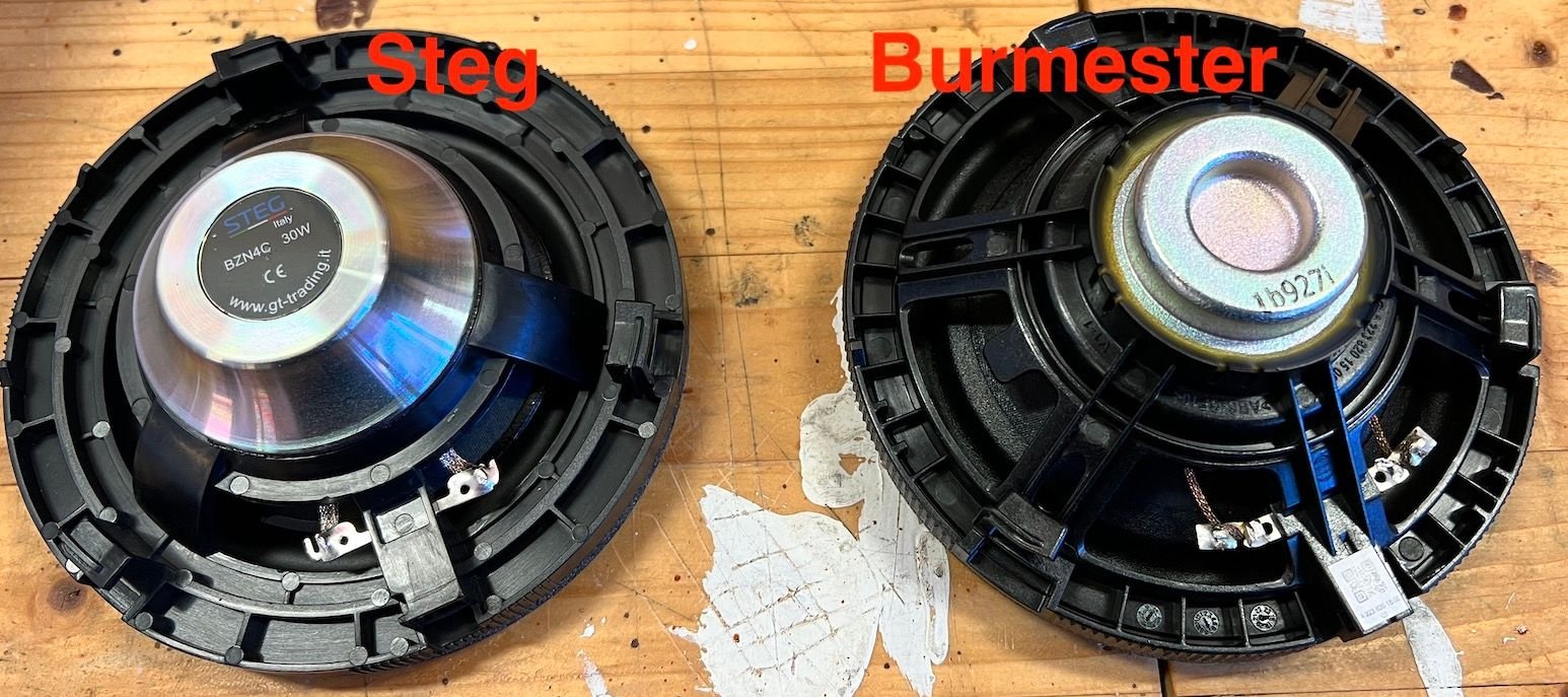

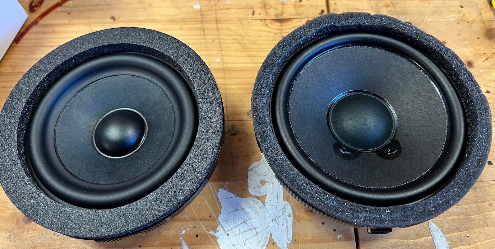

I just received the Steg BZN4C speakers for the doors and Steg BZ25 tweeters.
My C300 was fitted with the very crappy standard sound system, but I have fitted Burmester drivers in both front and rear doors and Burmester tweeters along with a crossover.

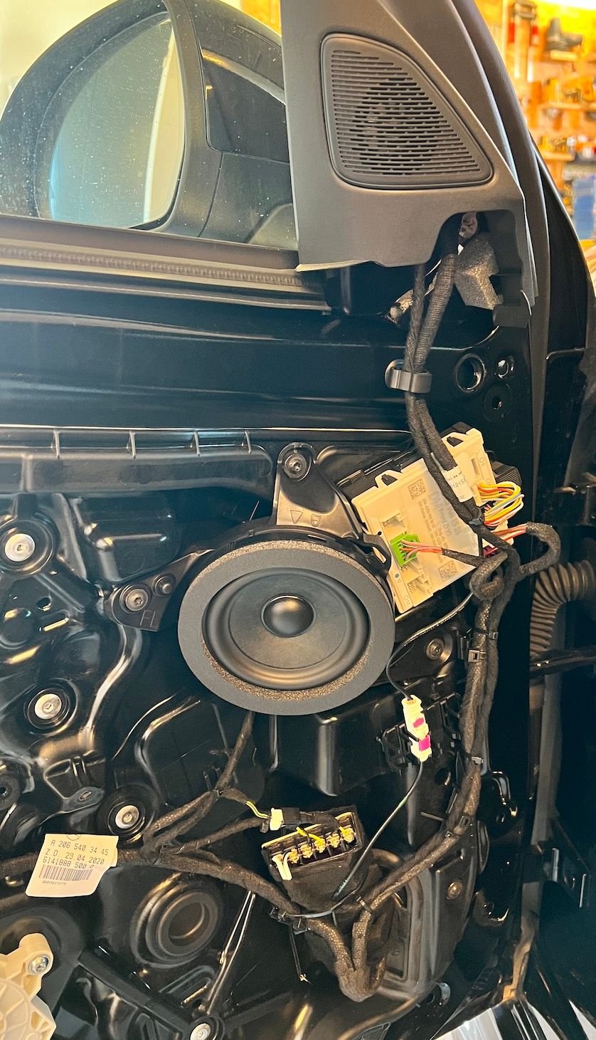

I installed the Steg speakers in my car this afternoon.
As I already had installed a crossover and Burmester tweeters, it did not take long to add the new speakers to the car.
I was hesitant to replace the W206 Burmester tweeters (not identical to the W205 tweeters), as I was fairly satisfied with them, although they were a bit aggressive.
Overall, I am quite happy with the change.
I would not have thought it, but there is a much better defined low-end now (of course not the deepest frequencies). I can best describe it as I hear less of the crappy 6" bassdriver currently fitted in the passenger footwell.
Midrange has been improved as well. It is slighty more laid back compared with the Burmester drivers.
The Steg tweeters are much less aggressive than the W206 Burmester tweeters, while still providing a nice addition to the high end frequencies.
If you are considering upgrading your standard or advanced system, I highly recommend going with the Steg speakers instead of the Burmester speakers.
No idea if the Steg speakers are available in the US, though. I am based in Denmark. I paid 172 USD in total for both sets of speakers.

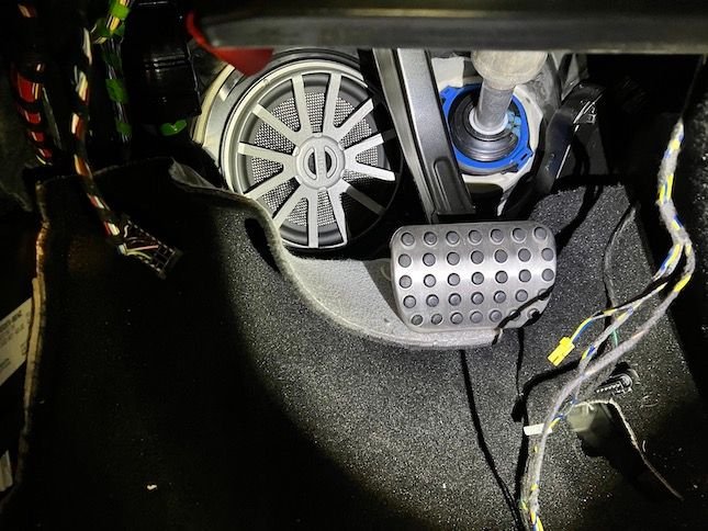

Next step for me will be to replace the 6" bass driver in the passenger footwell and add one to the driver's footwell also. That will require a separate amp, and I am currently looking for a 1/2 channel amp with hi-input to be connected directly to the speaker connector coming from the MBUX system. It must also be small enough to be mounted behind the glovebox.

Both steg and Match Up should have front woofer solutions for the w206 now. I would definitely get the steg one though since I believe it is a 2 ohm driver. Like you said you’ll need a amp to drive them and I would highly recommend either the Musway M6 or Audison Forza C8.14. Both are DSP/AMP and you will get the most out of your woofers and speakers from them.

Today I finally finalized the installation of the STEG BZN8 bass-drivers.
The sound system in my C300 now consists of the following:
- STEG BZN4C component set consisting of mid-drivers in the doors and tweeters
- Crossover installed between the speakers in the front doors and the output coming from the MBUX
- Burmester mid-drivers in the rear doors
- STEG BZN8 bass-drivers
- Axton A101 mono amplifier driving the STEG BZN8
- Self-made cables both inout and speaker-cables
The Axton amp is connected to the original speaker connector for the original 6.5" bass-driver.
It fits very snugly in between the firewall and the plastic cover for the positive lead distribution box. The Axton amp is just on the verge of being too big to fit.
I originally planned on using an Axton A1250, but could not get it to work with its high-level inputs and it furthermore is not rated at 1 ohms, which the parallel coupled STEG bass-drivers would end up being.
The sound improvement over the stock system is quite impressive.
The two most significant upgrades were adding the tweeters and adding the bass-drivers.
I dialed in the Axton amp settings by ear.
Replacing the speakers in the doors is very easy and can be done by most.
Replacing the bass-driver in the passenger side and the plastic cover in the driver's side is quite challenging. I am not a professional in this regard. It took me about 8 hours in total to install the replace the two bass-drivers.
The upgrade has cost me a total of 978 USD and a lot of effort.
I have not heard the GLADEN setup, but I presume it provides some benefit for the door speakers and I guess the DSP part can assist with dialing in the sound better.
However, overall I am quite happy with the setup I have ended up with.
STEG bass-driver in the driver's side footwell.
STEG bass-driver behind the plastic cover and Axton A101 placed between the plastic cover and the firewall.
