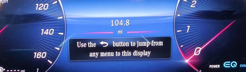

Old Aug 11, 2024 | 12:48 PM
Steely's Avatar
Joined: Sep 2022
Posts: 158
Likes: 27
From: Texas
C300 W206 2022
not sure what you mean but send us a screenshot of the message.
Here you go, with engine off. 5+ second on HOME 3-5+ second on OK
Old Aug 11, 2024 | 02:46 PM
W205C43PFL's Avatar
Posts: 33,012
Likes: 6,537
https://cimg0.ibsrv.net/gimg/www.mbw...13d47ba90a.jpg
Hmmm, keep trying, you might had missed something or maybe you accidentally hit something while performing the steps (due to those annoying capacitive touch keys) I never seen this issue reported on the forums in regards to the workshop menu for NTG 7 MBUX 2.0 vehicles, which is the one indicated.
