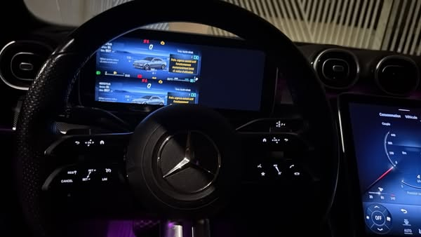

Double Display On Mercedes Dashboard (KOMBI instrument cluster in W206 C Class
If you met this issue like below, double image in your instrument cluster in W206, there are two possible case, you lose the software/coding data, or you are doing below retrofit job:
W206 with smaller instrument cluster (10 inch), upsize to 12.3 inch high resolution instrument cluster.

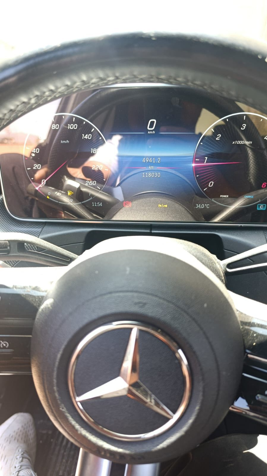

What we did: change the resolution of the instrument cluster:
From: 1440 x 540 to 2400x900 60Hz (12,3"), problem solved.
Cheers!
