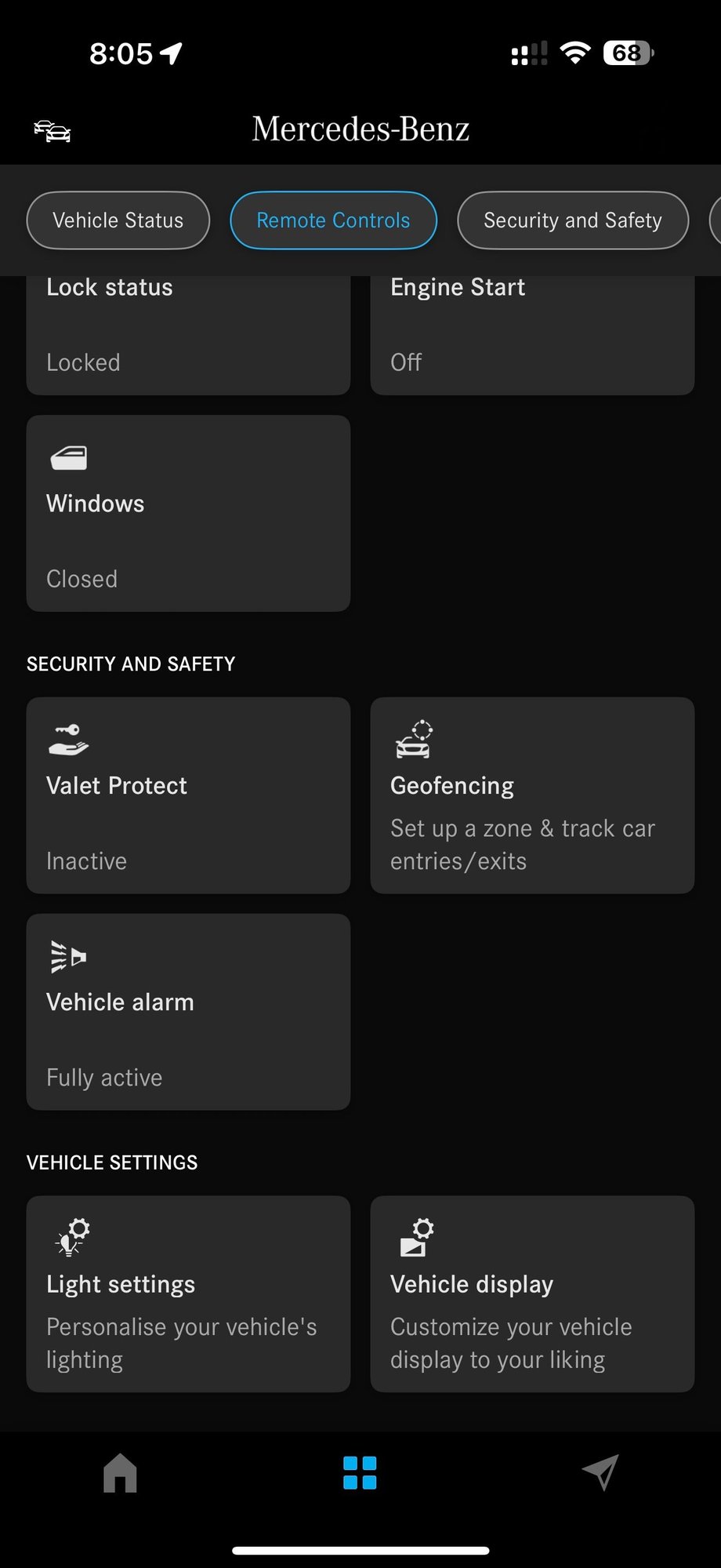

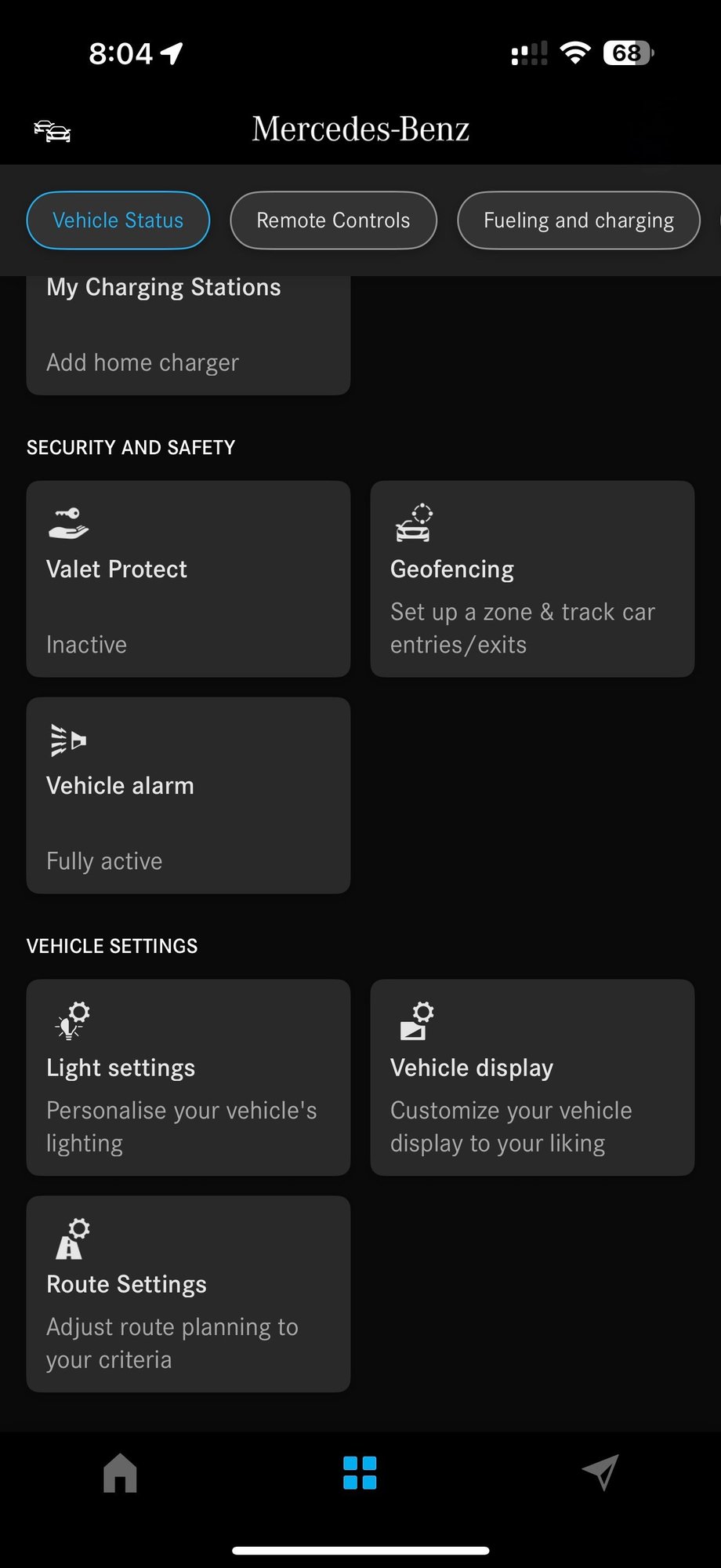

My app reported my parking brake was off (in vehicle status pane). I went out to the car and it showed it was on (Park in red). I started the car, moved it a few inches, turned it off, and the alert went away. My app told me yesterday I had a download in digital extras.

The Personalization service has been discontinued, so if you recently renewed your subscription, then vehicle settings are no longer available in the app. Valet Protect has also been discontinued.
In Canada they haven’t? Both my vehicles ‘25 G63 and ‘25 GT63SE4-D still have them available. App is the latest version and there’s no update available from the App Store.
They do not remove services from an active subscription, so they will remain active until your subscription comes up for renewal and then all the discontinued services will not renew.
