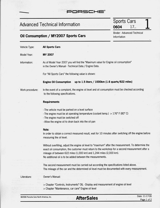

A quart of oil in 3 weeks sounds excessive, but how many miles are we talking here? Race miles? Either way, this seems excessive. Top it off and please check it at every fill up for the next few tanks.
On a previous Porsche (997.2), the dealer said that 1.6 quarts every 622 miles was considered within spec. After calling BS, he produced a service bulletin similar to this.
