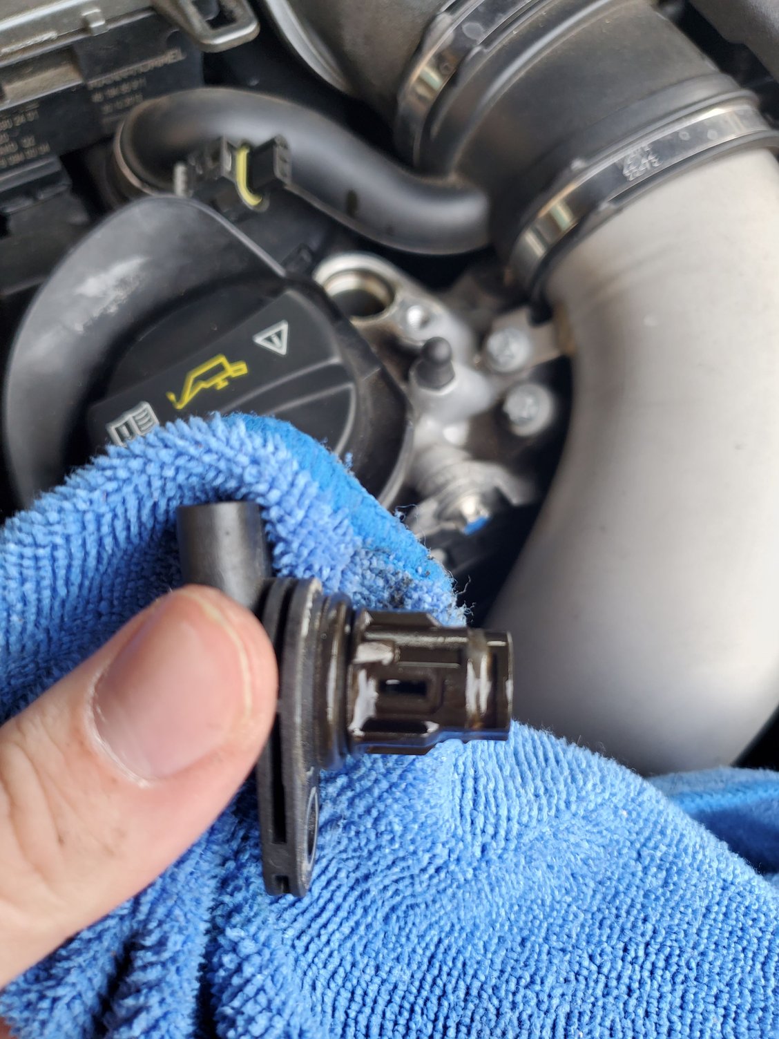

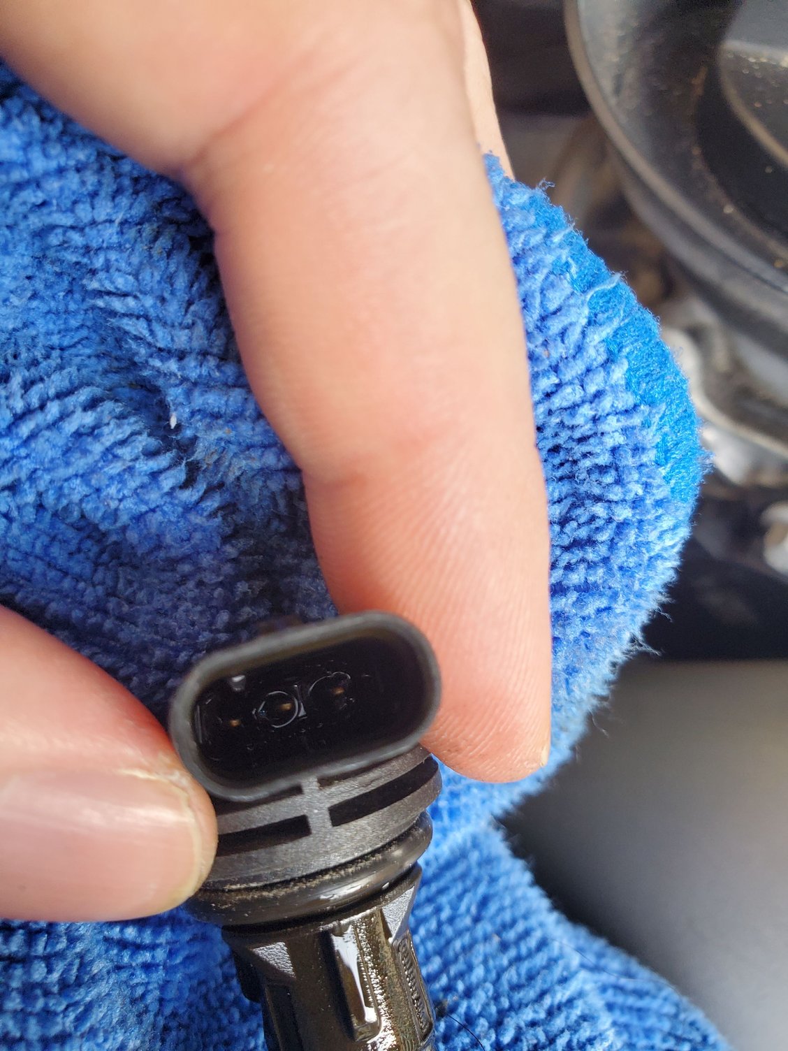

btw....got my sensors off and yup, all 4 harnesses filled with oil! Wow and to think the dealership didn't have the knowledge to consider this issue when my rough idle and o2 sensor CEL messages were popping up over the past year. All they could tell me was that a lot of troubleshooting would have to happen to "isolate" this issue. I would say I'm an avg. DIY'er but had I not stumbled across this thread there is no way I would've figured to go this direction with my problem.
Now to find the proper (superseded) replacement sensors here in Canada.

"My car is not misfiring but it has rough idle condition. While stationery, the car shudders/shakes with consistent periodicity. It is not really that bad but still noticeable.
After reading this thread, I checked the sensors and they all had oil in them. I have replaced all four of them but the rough idle condition is still there.

So before replacing the old ones with the new sensors, I simply cleaned the original ones and put them back on. A day later I checked them and all of them had oil in them again.I noticed the seal on these sensors but there is oil inside the body as well (where these sensors go in). I thought the reason for the seal is to prevent the oil from 'coming out'. The sensors seem to be magnetic (or electro-magnetic) so I am not sure why do they go bad in the first place (that is why I experimented with just cleaning and re-installing them first). Alas, it didn't work but neither did the new ones :-(
