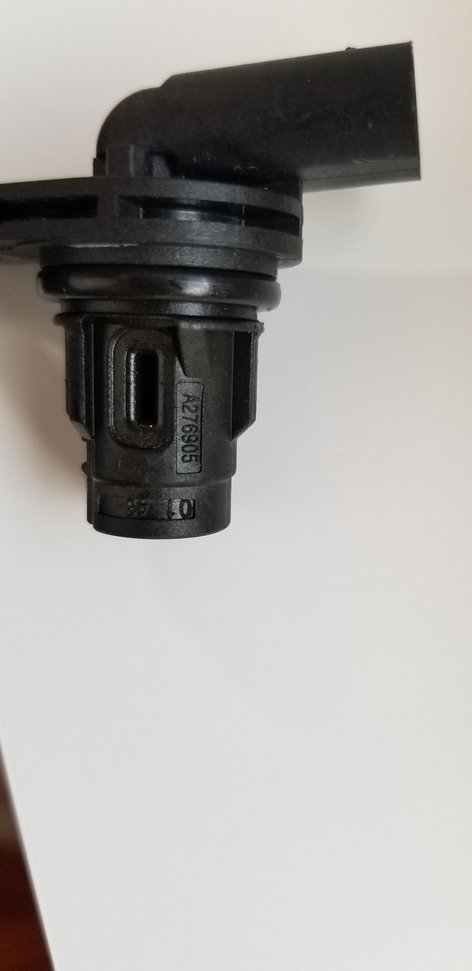

Originally Posted by Rosco44
T30 and comes right off
Loaded with oil, Yuk
Oil from inside the plug, Yuk!
Clean these plugs off very well!
This is the part number you need!
Get good electrical plug cleaner
You need 4 of these, this part number! Time will tell if these are manufactured better than the o es taken out.
DO NOT BUY or get these sold to you, DEMAND part number 276 905 1000.
If you have a 2012-2013 CLS 63 AMG read this and know this, your 4 Cam sensors need changed if you have not changed them yet. My car is verywell maintained never tracked never abused and has 55,000 Miles. Last week the CEL, check engine light came on as the car shuttered shook and had no power. Code says misfire 1,5,7,8,,,,, no sweat spark plugs are original let’s change them. Sweet ,problem fixed. Right? Wrong.
The next night same thing happens. CEL comes on;reader says same misfire.
Side note while changing my plugs earlier, my buddy says to me HOW did you get oil back here? I see no leaks or anything..... we are both �� stumped. Some of you experienced guys already know where this is going! Back here is irrelevant in location but always ominous in nature, oil where it shouldn’t be!
Read ,research ,read meet 6speeddave here on this forum and BAM he puts me on it; after 3-4 years these cam sensors leak and oil gets everywhere and causes all kinds of issues!
If you have the original Cam Sensors I. Your car change them now the OLD part number is 276 153 0028 The NEW part number is 276 905 1000.
MAKE SURE you check the new part number on the sensor stem MB dealer actually sold me 1 sensor marked as the new 276 905 1000 number while it was # 276 153 0028—. I am taking it back tomorrow to swap and finish the job.
Here is a question did MB enhance this sensor? Does the new part number mean it is improved and will not leak? Time of course will tell. Maybe it’s just a 3 year 30-40k change out!
About 50 bucks a piece and super easy change out. I have several pics to post.If you have any questions send me a PM call me whatever I can do to help you let me know.
The main take away is this: change these Cam censors before they cause you BIG problems. Make checking them a part of your annual inspection?Bi annually? Something!
replaced my plugs last year when I first had the misfire issue. Just did my cam sensors and cleaned the plugs but still getting issue. My car has 100k miles so I'm sure the harness has got a lot of oil. Not sure what to do, get a misfire and limp mode when I get hard on the throttle, typically above 60 mph or so.... other than that I don't really have any issues with idle etc
Did you disconnect your ECU and check for oil on pins? Maybe you can clean it up very well.
Old Feb 17, 2021 | 05:38 PM
  #60
hyundaimg's Avatar
Joined: Feb 2021
Posts: 9
2013 Cls63
Yep, checked the ECU and cleaned those connectors also, although they had a lot less visible oil that the cam sensor connectors. I may not have cleaned the cam sensor connectors well enough. Can you explain the best technique of using the spray to clean connectors?
Not sure where the cam magnets are located or what they look like... but I suppose cleaning those connectors would be a good thing to do also
The magnets are very visible, search for part # 276-156-07-90, which is also the updated #, if yours is the 04-90, change it. The cam sensors should be 276-905-10-00. If they are the old ones, you have to change them, as they are the cause for this mess.
If you have the old cam sensor part #s, change them out, then you won’t have to worry about it.
I have part number A2769050143. Is this old part #?
Old Feb 22, 2021 | 02:18 PM
  #68
OnlyGerman's Avatar
Joined: Aug 2012
Posts: 1,047
Likes: 174
From: Florida
Too many german broads
yes. You need 4x of 276-156-10-00 AND change your cam solenoids as well with 4x 276-156-07-90
MBOEMPARTS.COM seems to be the cheapest
You can continue to monitor or change them all out now for piece of mind. As time goes on, the old sensors will leak.
