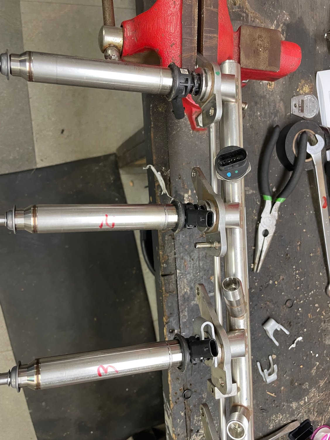

I pulled the fuel rail with injectors and got consistent ohm reading on all 4. I’m struggling to pull an injector out of the rail. I removed the retainer clip and the injector rotates but I couldn’t pull it out. I’m concerned about damaging the injector.
scoped each cylinder through the injector holes. No surpise, 2/3 are dry and 1/4 are wet. Walls look good and I see no evidence of contact between valves and piston.
