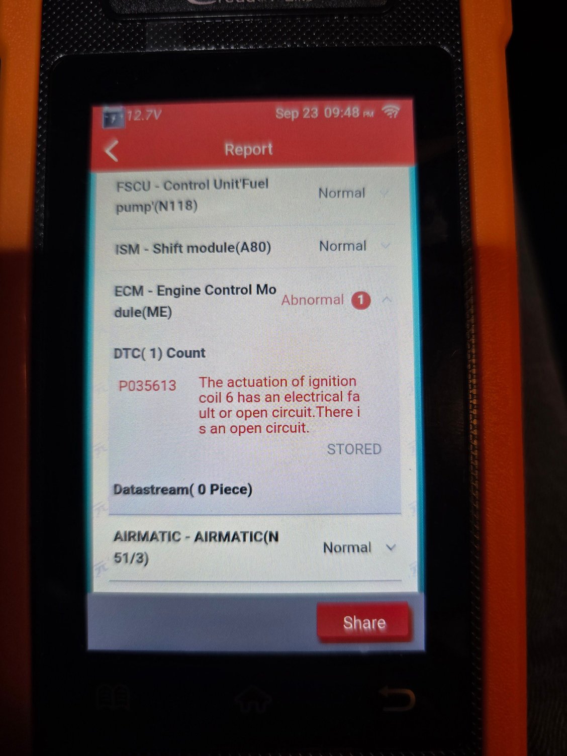

Old Sep 23, 2025 | 10:12 PM
Corvetteguy's Avatar
Joined: Aug 2025
Posts: 16
From: Apollo, PA
2016 CLS 63 AMG
Looks like a faulty coil.
Old Sep 23, 2025 | 10:31 PM
CaliBenzDriver's Avatar
Joined: Apr 2019
Posts: 12,224
Likes: 6,902
From: Silicon Valley
W212 MY'14 M276-3.5NA @75kMi
simply SWAP the coils #5 /#6.
See how fault goes to #5 or stay on #6.
Lean mixtures cause misfires.
Loose connectors can cause poor contacts.

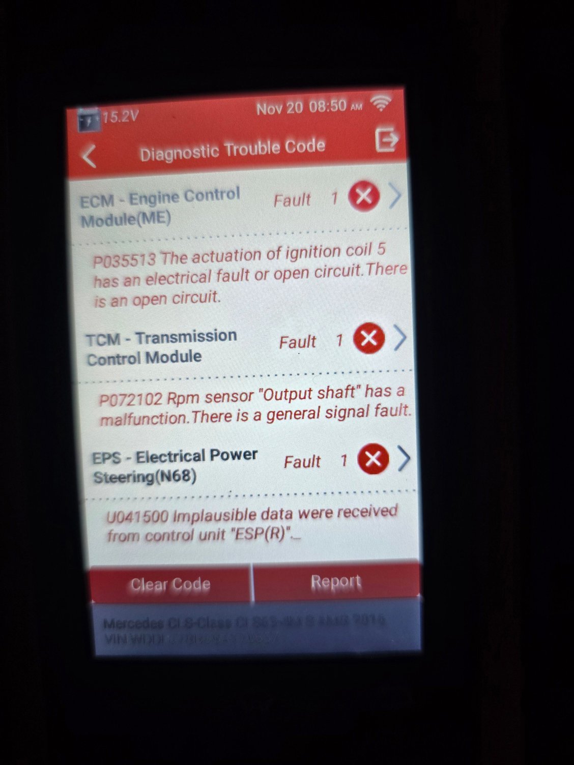

Old Nov 20, 2025 | 11:19 AM
Joined: Aug 2025
Posts: 16
From: Apollo, PA
2016 CLS 63 AMG
The problem has been happening since my last post. No codes during these times. Some of them we had to pull off the road and stop and restart engine to fix the problem. Other times we tried turning on the headlights, no help. Other times we shifted from comfort mode to S and to S+. During these shift trys the problem did go away without having to stop the car/engine.
Now, this week it happened on 2 different mornings. Turning on the headlights and shifting through the modes did not help. Then the check engine light came. Flashing at first then switched to solid on. After stopping and restarting the engine all was back to normal operation. And the check engine light disappeared.
Returned home and checked for codes with the scanner. Coil number 5 is now showing.
Old Nov 21, 2025 | 12:20 AM
Joined: Apr 2019
Posts: 12,224
Likes: 6,902
LIMP-MODE DELUXE...
This is progress being made because now you have 3X hard faults about this CAN-C disruption by ECU + TCU + ESP + EPS.
You have tried stable voltage with HL:ON with limited success.
I bet all these faults are STORED transients (not "Active") - Don't bother considering each individual fault as significant. Something is bugging down your CAN-C that gets reset by key cycle.
> Further progress /What to try :
I reread up your thread : I believe you have a good shot at a free fix by cleaning your painted ECU GND.
It seems the ECU is the initiator to this wholesale CAN-C chaos.
Locations are footwell + firewall + front beam.
Double check WIS schematic for exact locations.
HK Style base V6 S-class: S350
HK-Style beautiful S-class: S350 base V6 sold by Zung Fu Ltd.
Old Nov 21, 2025 | 08:09 PM
Joined: Aug 2025
Posts: 16
From: Apollo, PA
2016 CLS 63 AMG
What to try :
Sounds good, thanks. I don't have a WIS program to find the exact locations of the painted ECU GND'S. Any access to schematics online?
I will look at the car tomorrow to see if the gnd's are obvious.
