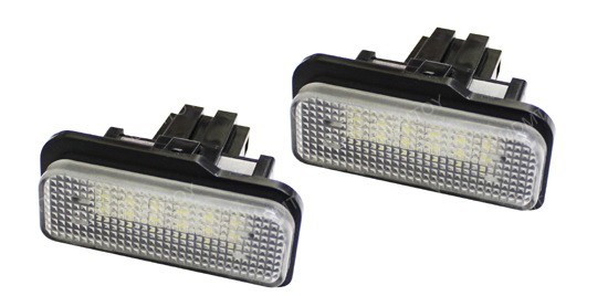

PS: FYI... They make a 3 LED and 6 LED version for this application. I have the 6 LED board which is naturally brighter than the 3 LED.
Here are two examples of what they look like.
