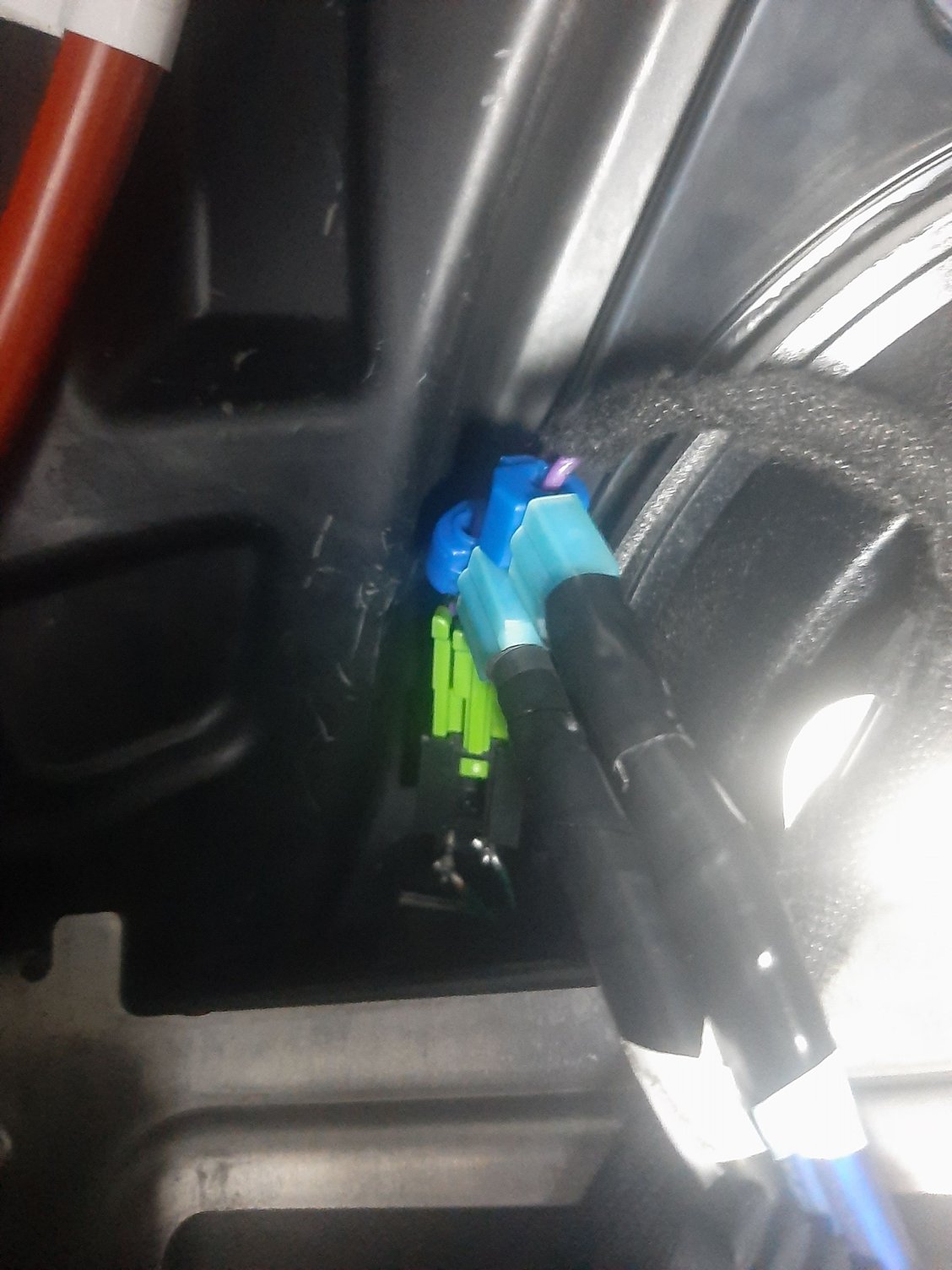

Figured it out! 2021 glc300 signal tap
Okay so I've been looking for weeks now to try to figure out where to tap into my stock audio system to get signal to my loc or my lc2i well I finally figured it out anybody with a 2021 glc300 4matic without the premium surround with the stock system all you have to do is super simple is tap the sub which is in the passenger footwell underneath the carpet behind the black plastic there's a sub right there and the wires right in front there's 2 purple wires clipped into it you just tap those wires right there run your wires to your loc and there you go easy simple it can be any any freaking easier but I hope that helps people who r looking to add an amp and sub and keeping the stock head unit , Im Def going to change the speakers but it's brand new car so the speakers work jus fine right now .
