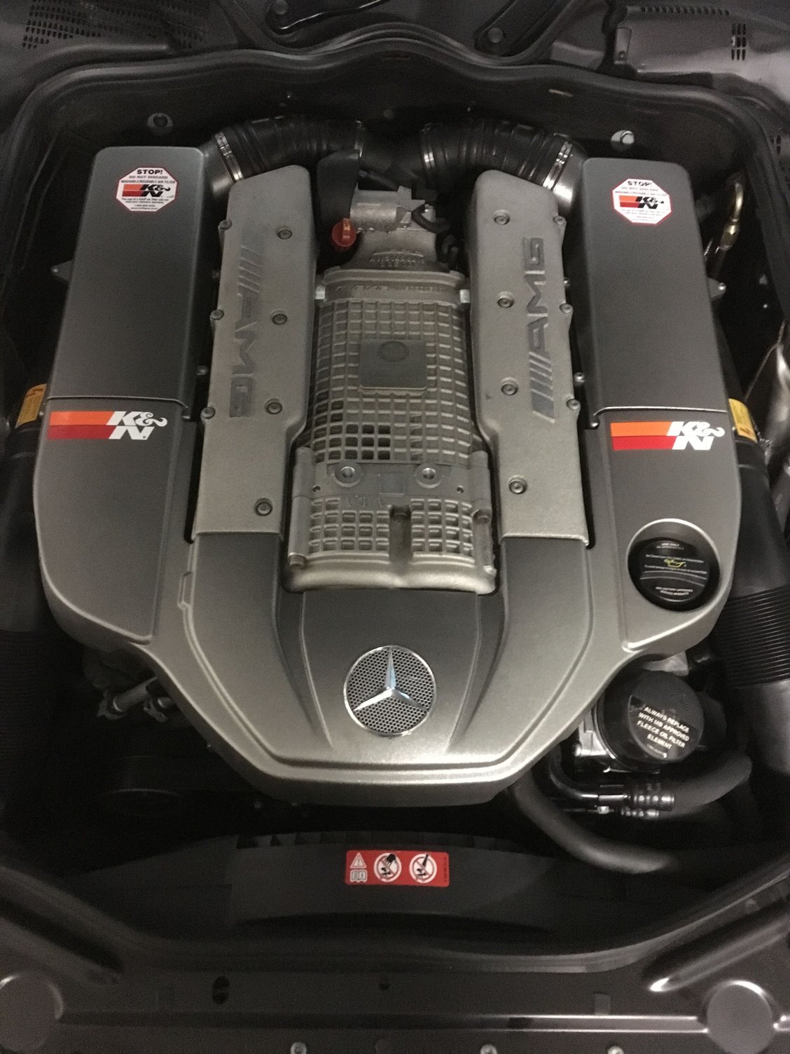

MUCH EASIER THAN I THOUGHT...
Seems as thought I worried for nothing. For those who have a CLS55 AMG
There is no taking it all apart to change from the ordinary paper engine air filter to K&N. Do not cut the hose clamps that lead to the input of the supercharger. Just turn out the six 25mm torx screws. They are captive to the cover and in my case were probably never turned out before. Just back them out lift the cover, slip out the old filter, get a microfiber towel and spray on some 409 and cleanup the chamber where the filter lives. There will be a lot of sand and leaves and stuff in there. Then lift it up a couple inches again and slip in the K&N filter. Screw down the six torx screws and put on the front cover. Bada bing bada bang ...

My K&N's let fine grit in, Went back to stock.

Maybe you didn't oil them?
I have swapped to K&N's on all my vehicles where available. If fine grit is getting in I can't see it nor can I feel it with my hands on the clean side of the intake.

It is almost too fine to feel, like talc. Check in places the air slows down, like the back side of the joints.
