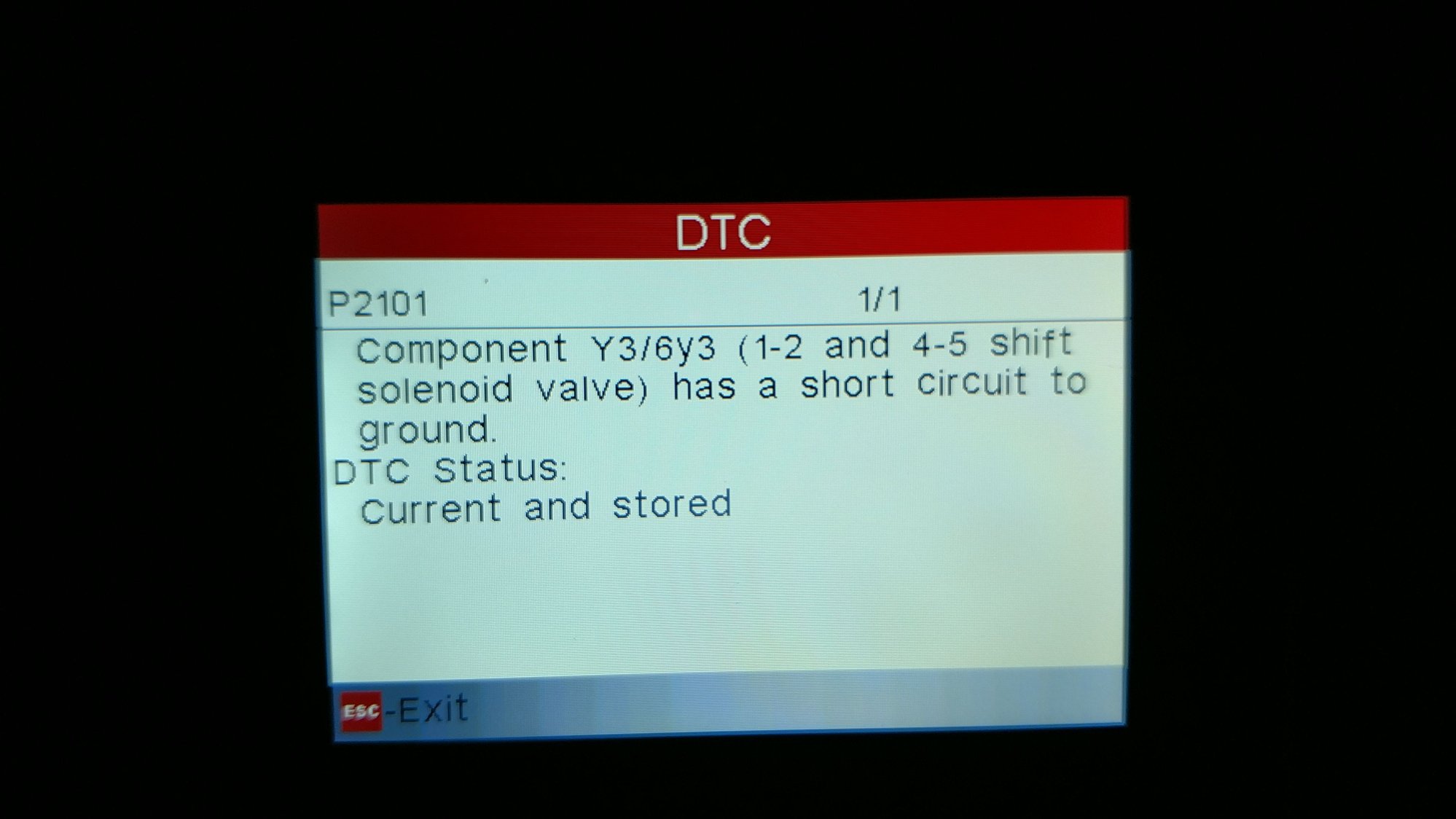

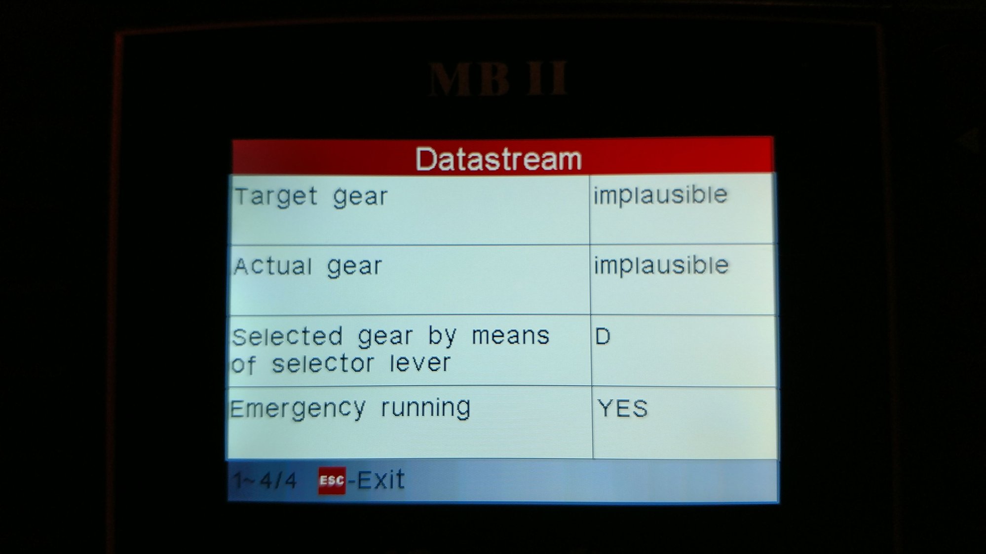

Went to go drive the car today and it was derated to second gear only. My guess is a limp mode sure to bad connection at that plug since it's not seated going to mess with it morning when I get home. No faults showing though on dash.

Yes it is in limp mode. Did you change the 13 pin connector that is giving you a headache? Should have because one of the two O rings leak and get oil onto the connector which wicks up into the TCM. You need to change it out, then clear the transmission codes with a high end scanner or Star system. If you don't clear the codes the transmission will remain in limp mode. Also you should have a CEL light on the dash because the transmission codes are not pending anymore they are set. Check your bulb in the CEL light.

Hello, I did change the electrical sleeve connector that mates the harness to conductor plate and there was a small amount of fluid in the original connector before I replaced it. I just bought an icarsoft mbii scanner and checked codes and I got called P2101 for shift solenoid shorted to ground. I cleared all transmission codes and engine codes and after test drive the P2101 comes back. Transmission still in limp mode. I think this scanner will work and had enough functionality but this my first experience with it and this car. This only happened after I reset the adaptive shift parameters that the transmission went into limp mode. I have not tried to reset them again.
