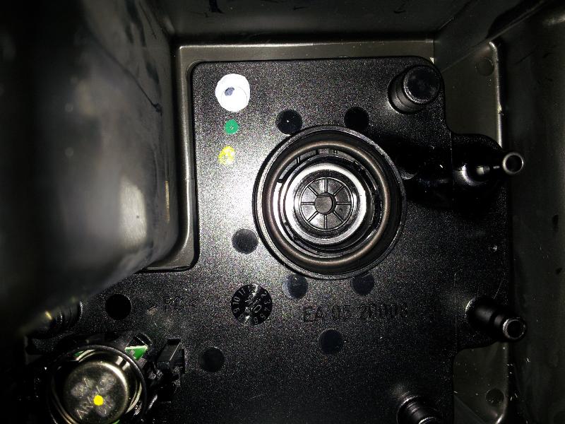

Thanks Funktron. After reading all the posts I was able to pull the pump. It has a 4 pin power connector. I've tried various combinations to get the pump to run with no results. So, I opened it up and applied 12v directly to the motor and it runs. Draws a lot of current, but it runs. Does the 4 pin connector need 12v on more than 2 connectors?

not sure about the wiring for the pump....maybe someone else can chime in with an electrical diagram
were you able to see any melted parts up by the valve?
this part in particular:
https://mbworld.org/forums/attachmen...ir-orifice.jpg
toward the bottom you can see the deformation. I was able to block ports with my fingers and blow into one and feel the air escaping out of the melted part. The lack of pressurization is what shuts the system off.
