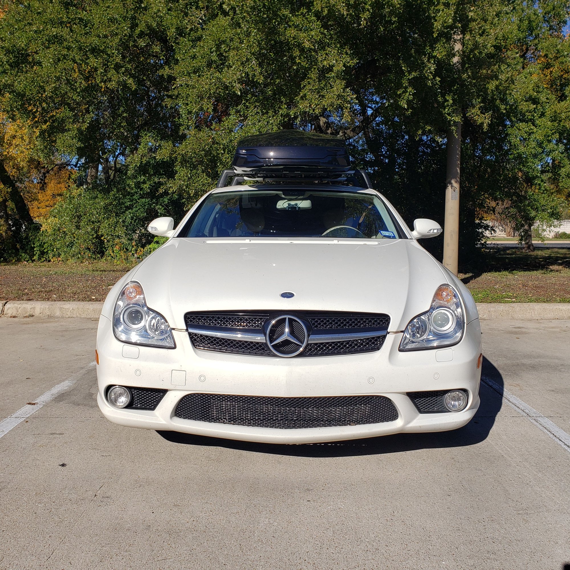

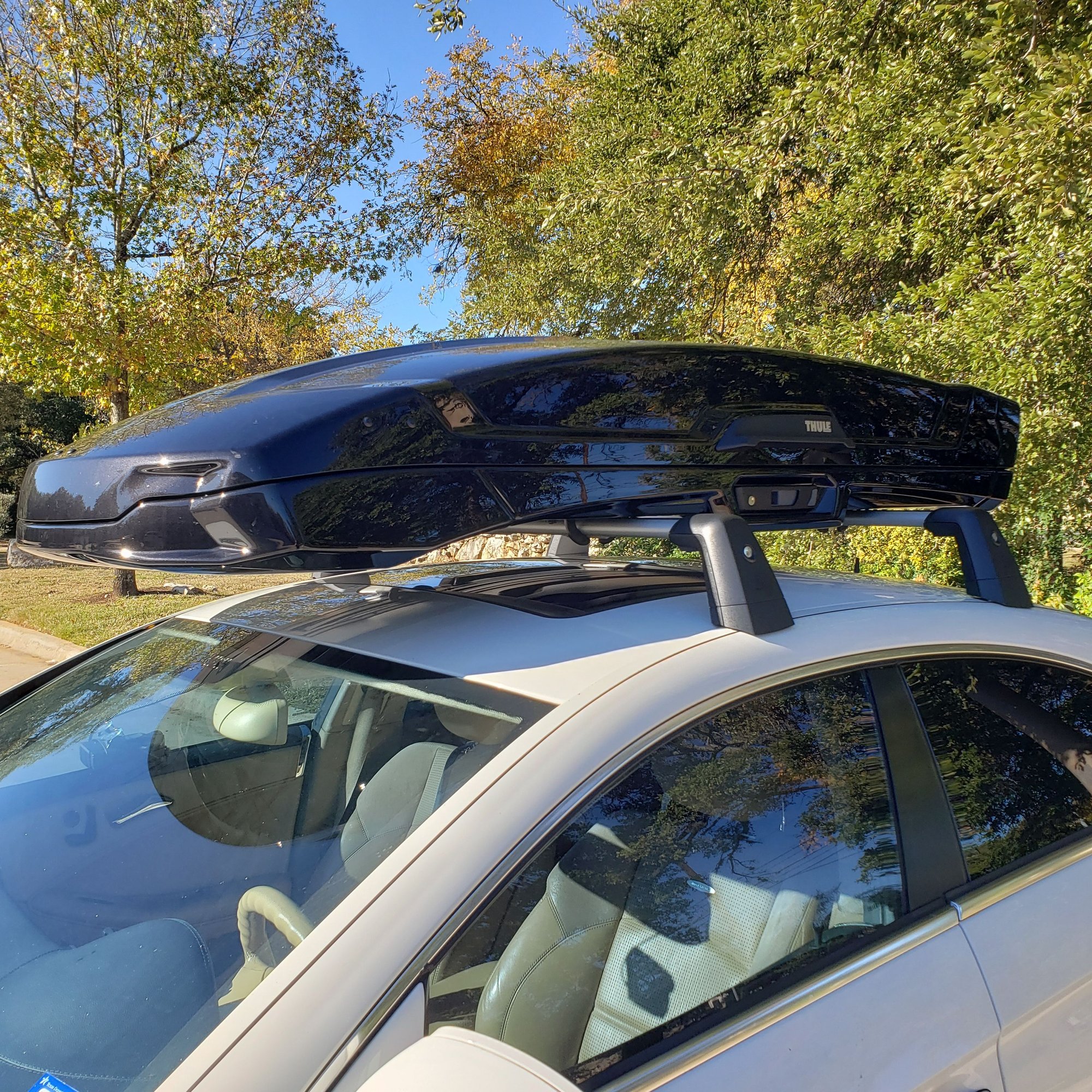

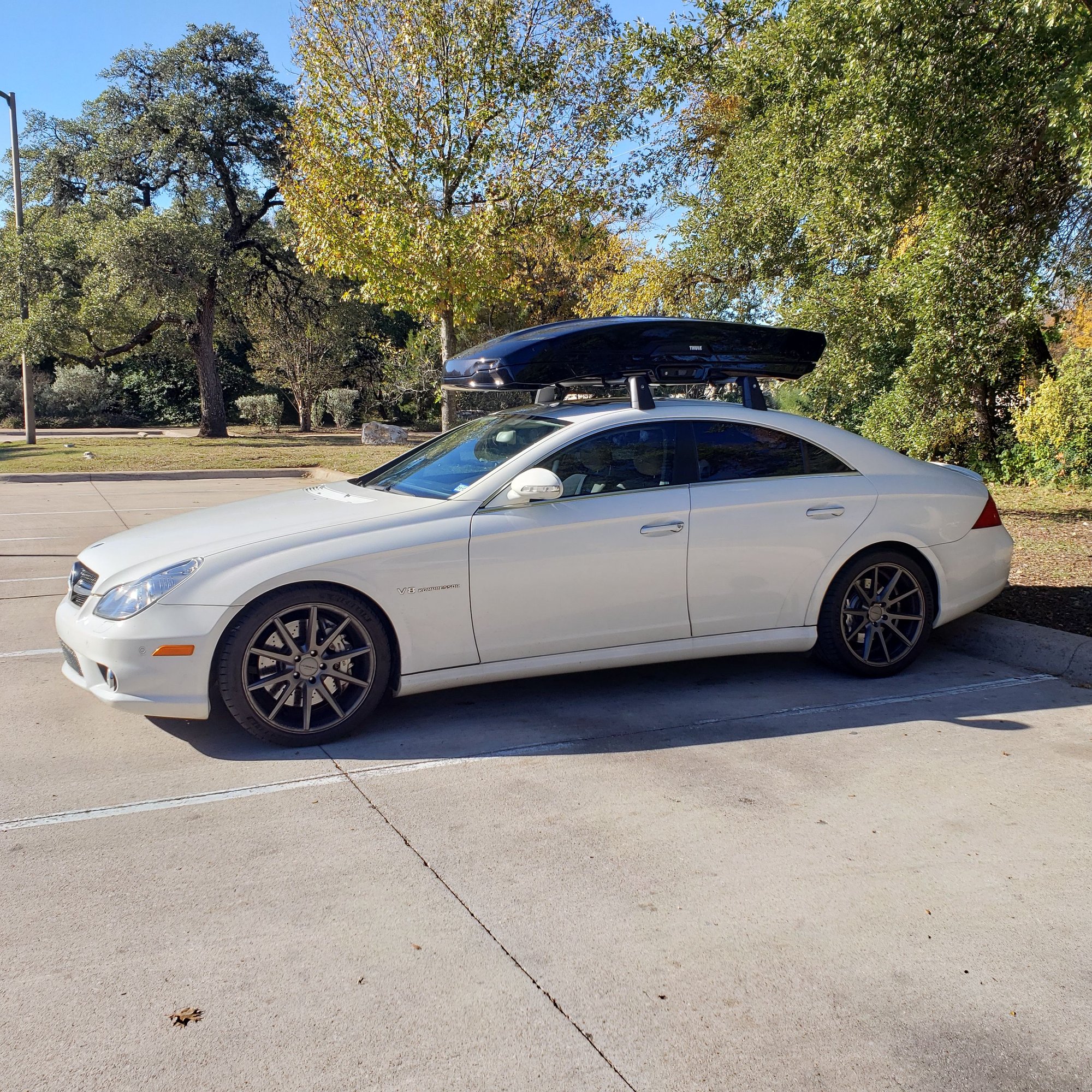

Thule Vector M Roofbox and OEM Roof Rails
Just a few pics of my CLS55 with the OEM roof rack basic carrier part number: 6-7-81-2107 with a Thule Vector M roof box.

That looks way cooler then I expected You can even open the sunroof

Thanks! So far it has been pretty stable at 90+ into a 15 mph headwind .
