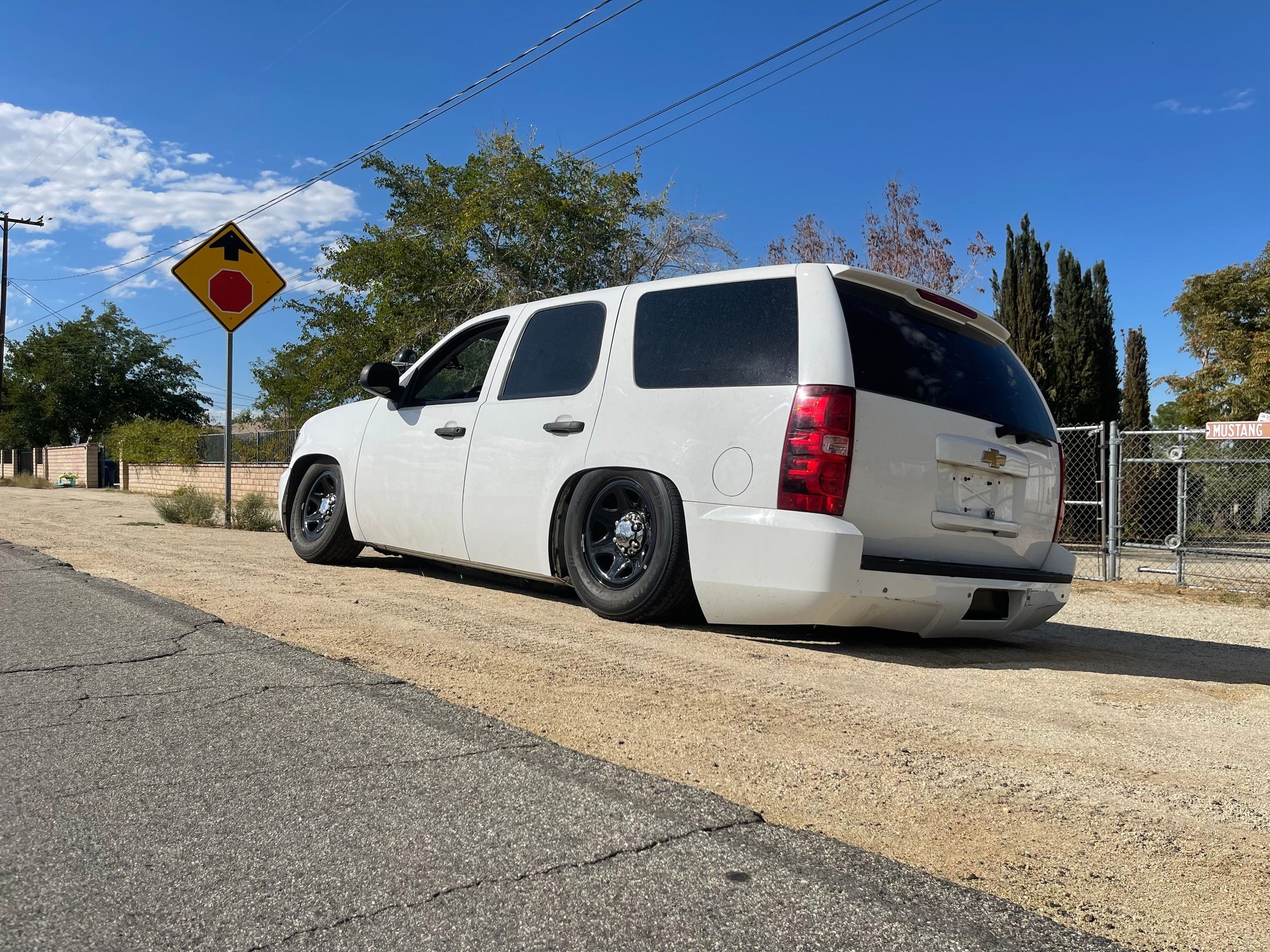

Notched the frame on my 2014 Tahoe ppv, slammed specialty bags, viair dual compressors, lots of metal fab work,
