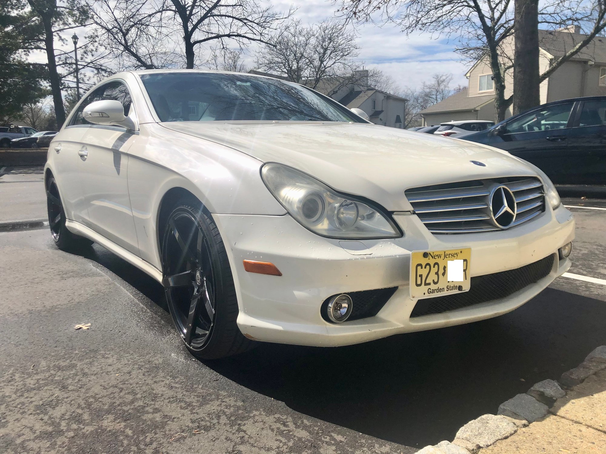

Hi,
I just purchased CLS55 2008 and went to adjust the Alignment today.
the technician couldn't have it done properly and said "Manufacturer does not specify rear adjustments on this vehicle". didn't understand what does he mean. I'm trying to understand why the rear Toe 0.77 and the Camber is -2.6. hence the previous owner replaced the Airmatic suspensions with the coilover one for all wheels. and I also noticed he put 20" rims with 245/35/R20 front and 275/35/R20.
I read that tire profile for 20" rims is should be 30 for front wheels and 25 for the rear. don't know if this still okay or unsafe.
hope someone can let me know what could be the issue causing the rear toe/camber be like that.
attached the Alignment report for reference.
thank you in advance!

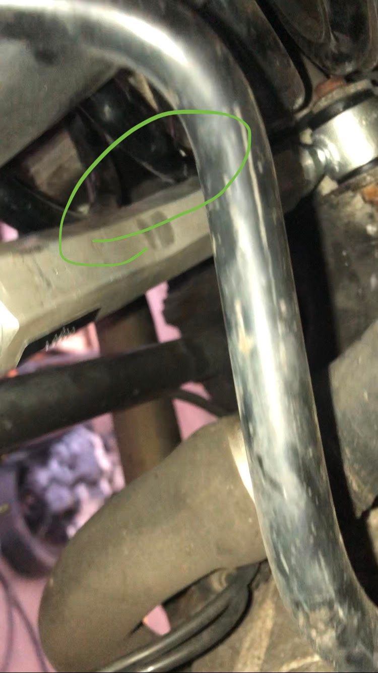

I did some search before you reply, and found products from the camber king. I got the rear Toe links for toe, and the upper arms for camber, gave them to the mechanic, he was able to put the toe links as they were easy, but the issue is when he mounted the camber arms, they were touching the springs! the car still there and don't know what to do. maybe will ended up removing them again and put the original arms so I can drive until I see what to do.
this makes me loses twice, paying him for mounting them, and paying him again for putting the original arms, plus the time wasted.. have anyone tried these arms on coilover suspension and worked?

I have this exact issue with the same product. I'll post pictures once I have them replaced with K-Mac.

Hi all, for the rear camber arms, I just returned them and bought the one for Airmatic suspensions and did worked on my coilover.
