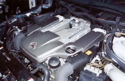

You suck the oil out of a little tube that should be near the right rear corner of the supercharger casing. It's about 1/2" in diameter, and points forward, up, and toward the left headlight.
This is a C32, and you can see it as the little black tube coming up at an angle, tucked in near the inside rear corner of the right surge tank. Mine has a black male plug with a dot of yellow paint.
Attached Thumbnails To those who have vacuumed the oil of their C55's-c32-20tt-20engine-20bay-20top.jpg

Look at the orange plug in the upper right of this photo.
It's located in the same area as posted earlier.
It's not the transmission dipstuck tube, as that one has a locking cap instead of the slip-fit plug that is in the oil tube.
Mine's black, yours is orange.

I see an orange plug in the middle top part of the photo (by the DS strut tower) however, it's the red plug in the left side of the photo looking straight up from the coolant resovoir that is the oil tube. Not sure what orange plug you see in the right side of the photo.
